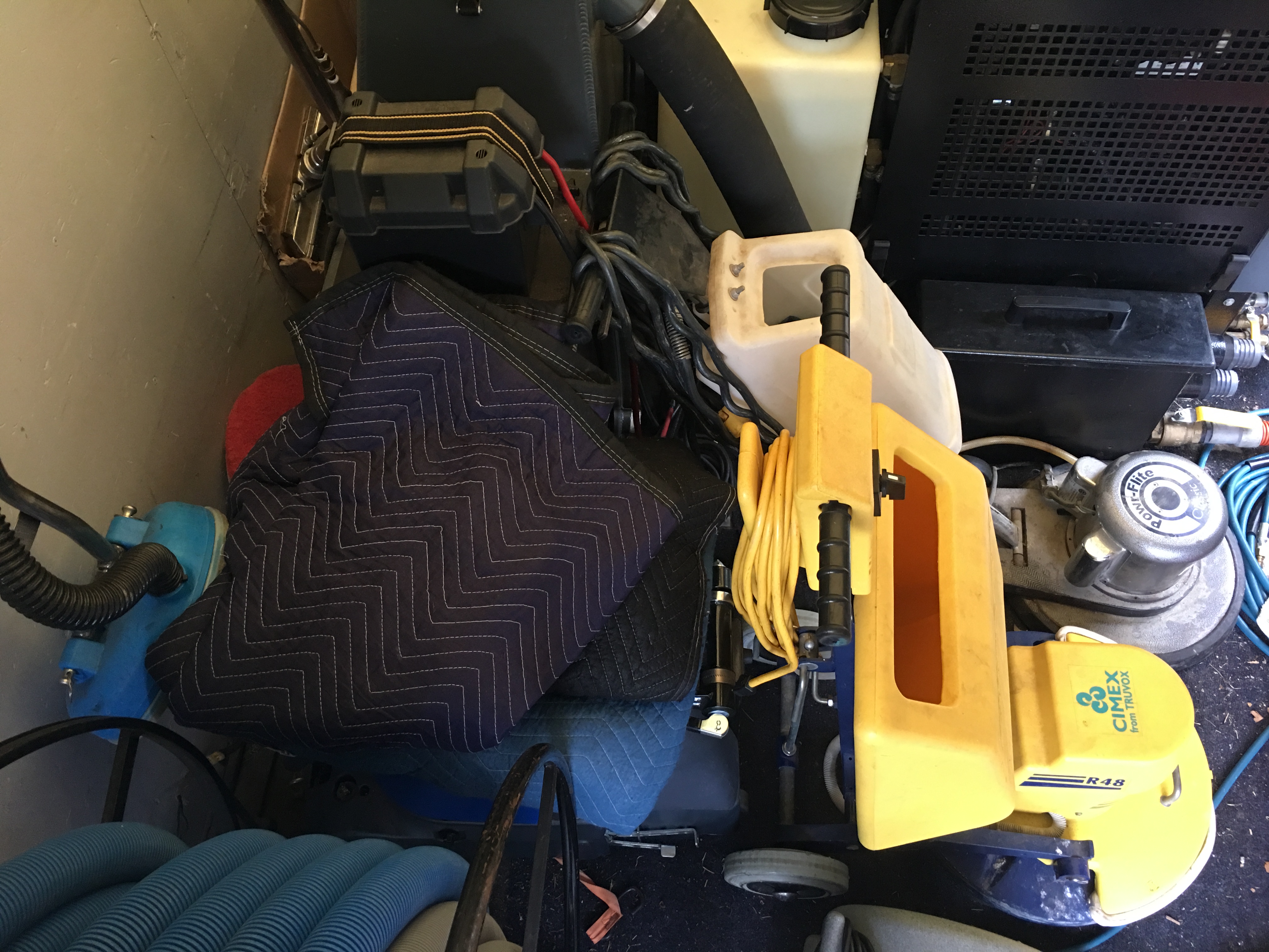

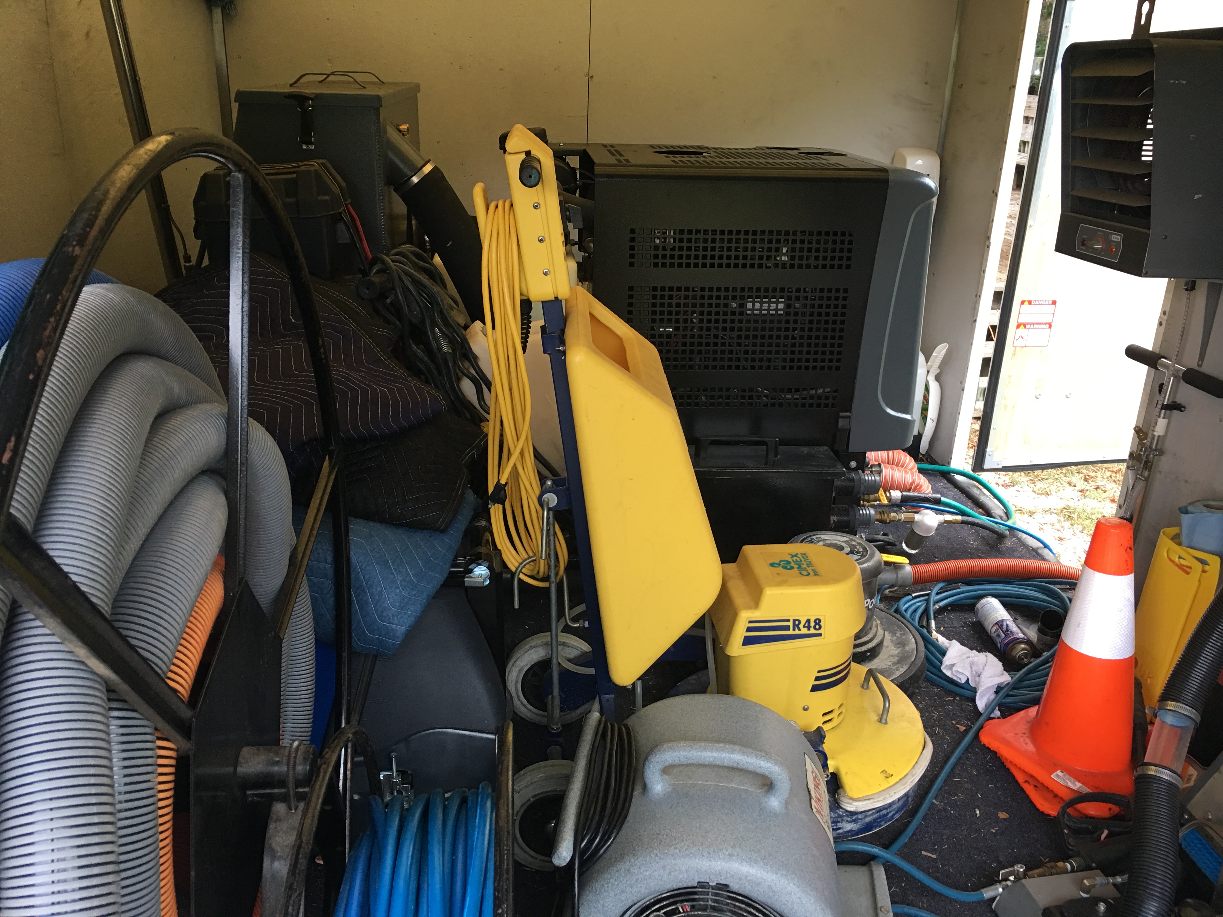

I’d like to squeeze it right where those blankets and cimex are sitting parallel to my truckmount in between the hose reel and waste tank

SHHH! Don’t tell Mikey my dirt dragon is hiding under the blankets.
