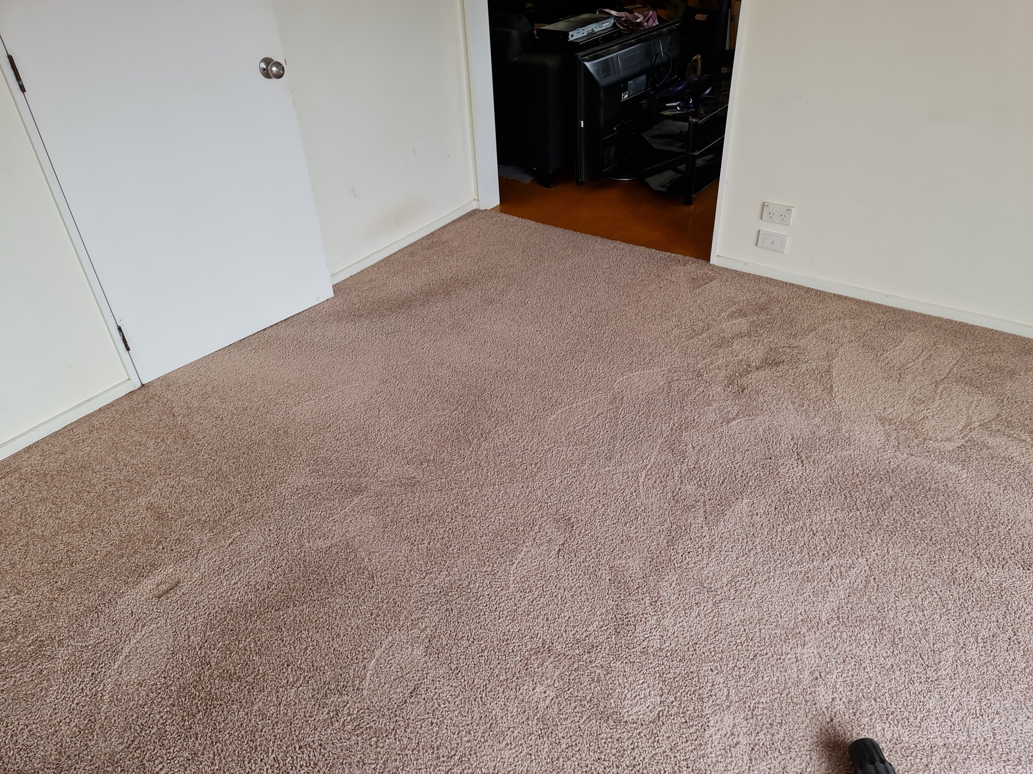

Few days ago, took my 360i out to put some airmovers in and came across this.
Would of been easier on my body with some agitation, but would of still taken around the same time. To get a result you wouldn't visibly really tell the difference..
