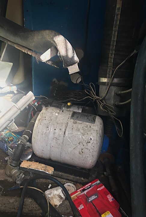

Surely something that is needed.
Wands thrown in the truck equals two things:
1. Parts replacement on the wand; especially nipples and elbows between the valve and quick connect.
2. Parts replacement on the truck mount and built accessories: Most waste tank shut off replacements and pump or wiring repairs on water system supply pumps are caused by wands shoved into the truck from the side or back door.
Hmmm....maybe I DON'T want my customers to buy these
:biggrin:

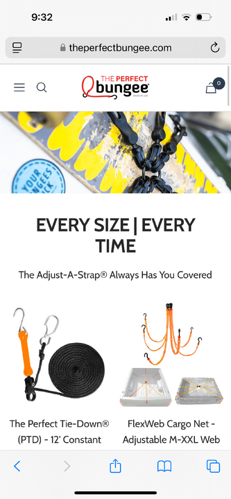

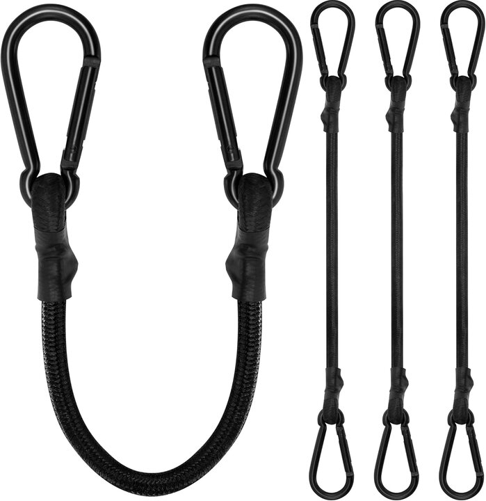

These bungees with clips work great. Also these wand holders work great too, bought a dozen of them to hold various things. I went back and forth trying to justify the hydra master mounts and couldn't find a way to make sense of it.

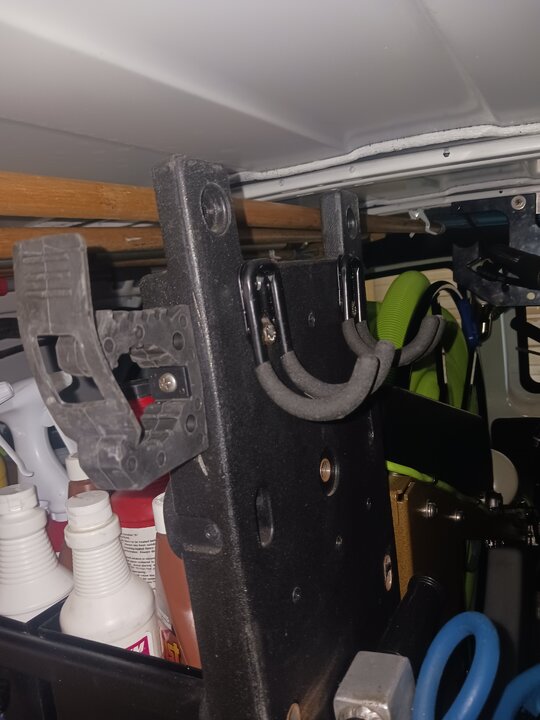

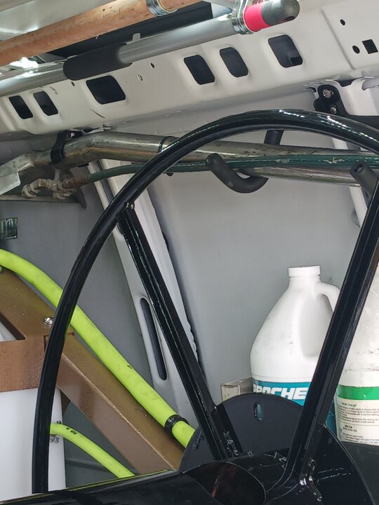

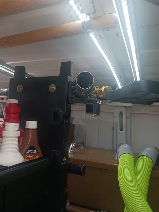

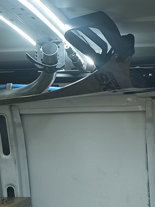

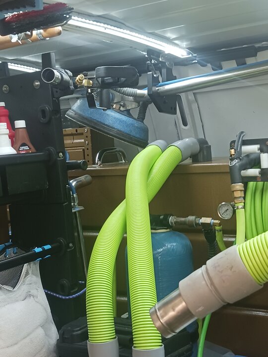

When building Frankenstein i used several different methods to secure wands , for a scrub wand i used a wand clip and a modified bicycle carrier. For my gekko wand i used 2 garage hooks from home depot, a 1½" rubber hold down from Amazon and ½ of a hydramaster wand holder, for my spinner i used the other ½ oh the hydramaster wand holder and a 1½" rubber hold down for my stair tool i used a 1½" wand clip.for caution hose signs i used a modified upholstery tool/hose holder piece from a old prochem chemical rack

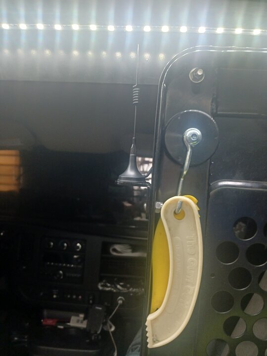

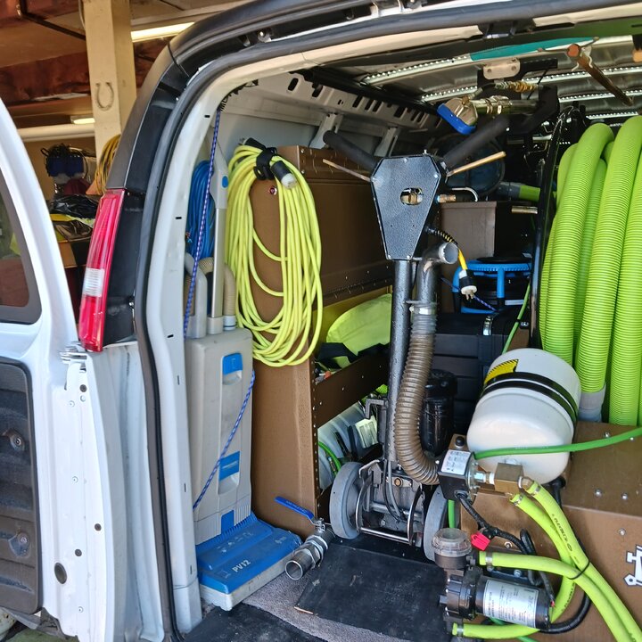

Sorry hit post by accident. For gum tools i used a magnetic hook from harbor freight. For blower lube , stainless(machine)cleaner , and small tools i used harbor freight toolbox magnetic accessories ( added thumb screws to hold in place) mic. Cords home depot garage hooks
For sprayers i used modified mytee sprayer holders secured with small sectional sofa clips to make removal for cleaning easy

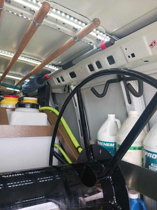

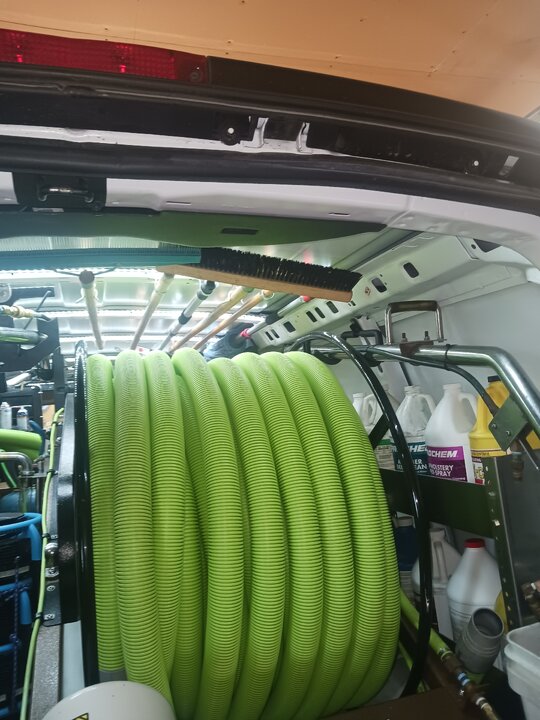

For grooming rakes mops and tile brushes i used appropriate sized electric conduit brackets and spring lock broom holders from home depot to clip um in
