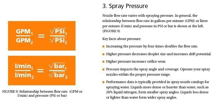

Four times the pressure will double the flow.
This was taken from the teejet website's users guide to spray nozzles

GRHeacock
Using the bucket, at 400 psi, with a 9506, single jet wand, I get 1 1/2 gallons a minute.
Generally speaking, the average hole size is 06. That is with one 06, or 2 03, or 3 02, 6 01's etc. See?
No hard and fast rule, just an average.
