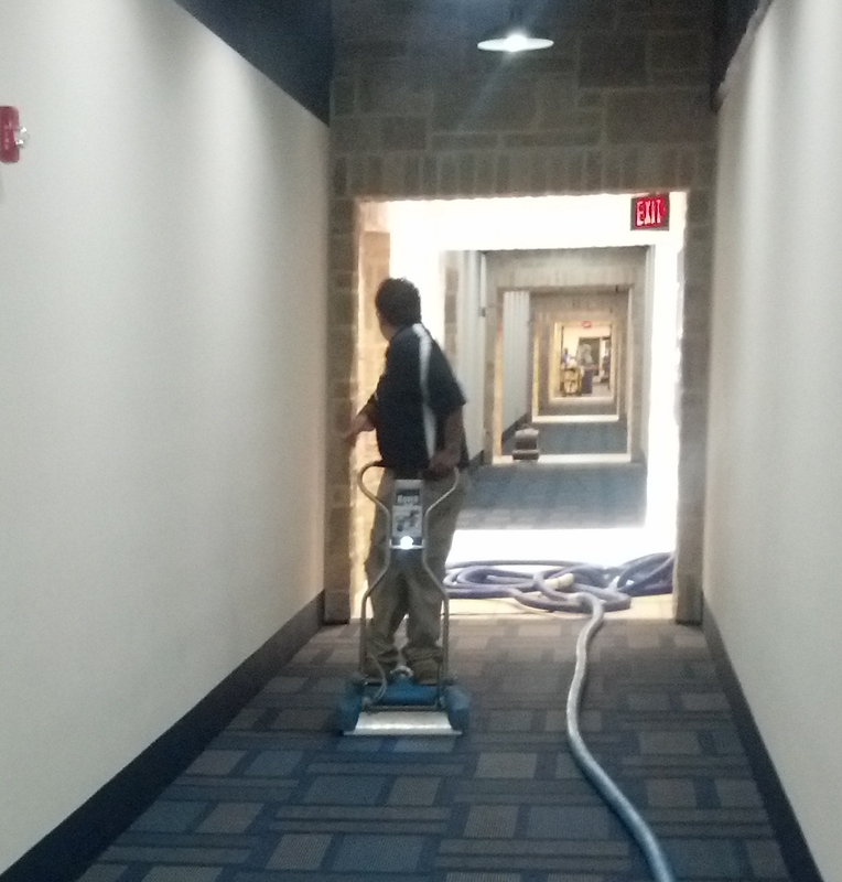

I've done a few small top-down drying jobs.. I've used the water claw followed by the zipper... The wicking of the walls weren't that bad considering the source of the leak was a downspout over flowed between the walls... The wettest part of the wall was cut out to find the source... I used a airpath and dehu to do top-down drying... The carpet/pad dried in 1 day, the other walls took 2-3 days to dry then had a repeat flood as it stormed hard.... The second time wasn't too bad but additional days to dry out was required... It was a ground floor with concrete subfloor...
I get that it depends on the subfloor and pad if your able to do top-down drying.... IMO I think its more possible/efficient with the sub-surface extraction tools available...
