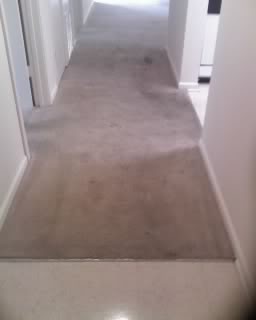

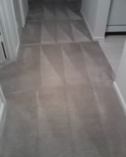

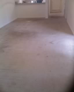

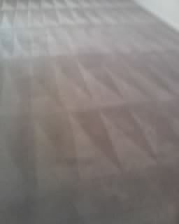

Some guys here do that with the procaps but because they have had so many issues with the reliablilty of the procaps machines, its not very common. However, there are quite a few guys on board here who lay down their prespray using a cimex with the gravity feed right into each pad driver to lay down their solution. Others will use a shampoo tank on a 175, And yet there are still plenty of those who will simply prespray ahead and then agitate afterwords.
Here is a job we did today; Shampoo'ed first presprayed after; Turned out great!!!
Before
After
Before
After
