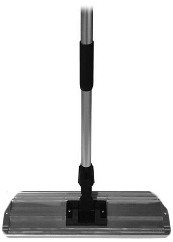

Spray or pour down the fist coat, work it in with the flat finish mop make sure you see all the grout lines go dark.leave enough product on the grout (and tile if it's stone) so it's noticeably wet. Now go pack up your truck or clean something else.
