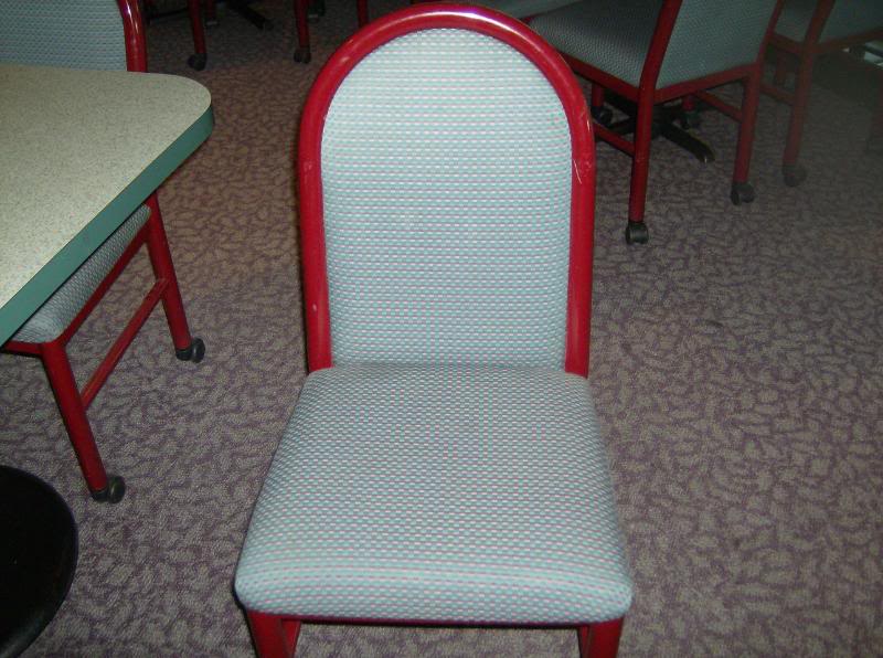

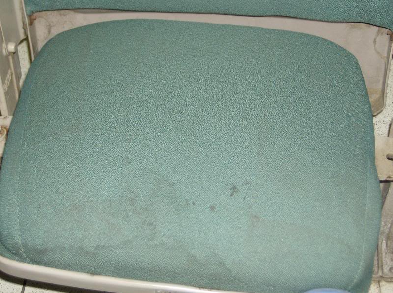

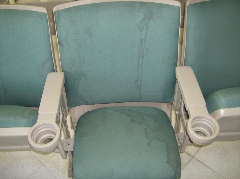

i have 400 of the chairs and 300 of the stadium style chairs to be done..i have never encaped chairs but would love to if it will work here..
what would be the best tool to tackle this job..i was thinking of some kind of hand mitt with some encap punch or a right angle drill with a pad or something..
thanks
dave
300 of these, they are all pretty bad
and 400 of these...these are really not that bad at all

It would be great to encap them. You already know hwe results, great but with some wicking problems . I would love for you to post your results after encap procedure. Also excellent supply has a Rota Power Scrub & Clean Drill Accessory for $19.00. You are on a roll with encap procedures in the commercial area. I am thinking Punch prespray, Hydrox encap. Good Luck
H
hernandez
I have great great results prescrubing with cobbs encapsulate ds and a tuway pad with my buffer followed by hwe with my pmf upholstery tool and my portable at 100psi with encapsulate in the rinse also

I've encapped several just like that and they came out great with Rick's Punch, tuway pads on a drill horse hair brush and plenty of white towels

Enzyme prespray with an oxy booster added then use a furniture tool.
The enzyme and oxy would disolve the drink spills.
Or hose them down with vacaway HOTKNIFE and towel off.
Never had much luck using any kind of drill/brush.Too awkward on your wrists.
Or you could use a cyclo brush machine to scrub and then towel off.
But me I think using HWE with a guy prespraying ahead and you using the furniture tool would be fast. Set them up all in a row and do the assemble line.

Variable speed grinder with heavy duty Velcro and a 7" Tuway thin one pad. need a grinder in the 2-3000 rpm range. Takes about 30 seconds to do each one of those chairs, even the really nasty ones. I could make big bucks on 400 chairs like that.
Take care,
Lisa
Greenie
I'll try an lend a helping hand.
Like Lisa said, get the variable 7" grinder (jimmy will sell his cheap), and then throw the stock "velcro" drive pad away and use the FLAT SMOOTH one that comes with the kit, it's the one for use with self adhesive sandpaper disc.
Then buy some Industrial Velcro, Lisa and I used this, it was the best I've ever seen, "normal" velcro ain't gonna cut it.
http://store.ccsop.com/catalog/product_info.php?cPath=32&products_id=74
If you are super nice maybe John or Patty will sell you a full square piece before it's cut round, so you can make more than one pad driver down the road, cut and piece works here.
Then use some CONTACT cement to stick it, in case you aren't the handyman, you brush on a coat to the back of the vecro and a coat on the smooth drive pad and let it TACK UP for a few mins., then CAREFULLY line them up and roll the velcro carefully onto the gummy drive pad, you only get ONE shot at this. Let it fully cure overnight.
Gorilla glue will work in a pinch, but it's not as good, I used it mainly to repair a feathered edge later as the velcro wore.
Then, get some of those 8" Tuway bonnets but NOT the ones with the green stripes, just the REGULAR all white ones, you will only use one side of the bonnet for about 50 chairs, don't flip it.
IMPORTANT technique note: "feathering" the trigger is the key to making the variable sander wok well, resist the urge to stay on the trigger, or you'll launch juice and bonnets.
And no matter what ANYONE tells you, do not get the "hand mit" type bonnets and try and cut them and separate them in two halves, this is a big no no, it will SHRED. just buy a small box of the regular 8" bonnets they will make you thousands in their lifetime.
Then get some Xerion (xerionsolutions.com) and have at it, once quick spray and one guy buffing and it's 30 sec. a chair like Lisa said.
I suspect that Hydrox from Releasit (excellent supply) would work well in this application too, but I KNOW the Xerion works, just don't over saturate, it's not HWE. a little xerion goes a loooong way.

Todd is right. IT should only take a few minutes a chair to do it right. Hook up the hydro force and prespray the chairs, brush them with a nylon brush and extract. Use 1 large bonnet under each foot and slide them as you clean the chairs and the floor is clean with no extra effort.

the last time i cleaned them it took about 1-1/2 mins per chair..the problem was it was killer on the back and legs big time..the stadium chairs are bolted to the floor and are a real pain in the ass to
deal with when you get past the first row..and the floors are a constant battle to keep dry and need to be wiped clean when done.

Production speed is important on those jobs but appearance is to. Sometimes when encapping dirty chairs you come across some that can eat up alot of time trying get the appearance right while other just go by like nothing.
If that was my project I'd handle it as follows: (assuming hose runs are reasonable)
Take the movable chairs and separate them into two categories, encapable and needing hwe. I would hwe the fixed chairs as they look like some could be a problem to encap.
I would have 3-4 upholstery tools running off of 1 tm. For us that would mean 2 2.5 hoses y'd to some 2" then to the tools in the production area.
Dave don't break you back on that, get some helpers and push them through the job. If you don't have the staff on hand, go to a temp agency, I like Manpower. $14hr each for some guys to stand over those things is worth it. You can easily teach them how to operate a tool and that's all they need to know. All the chairs are the same, and you or a member of your staff can oversee them.

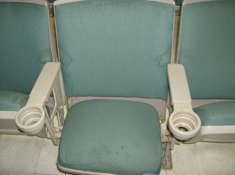

i was planning on hwe the stadium chairs (they are the really dirty ones) the other chairs are not bad at all..the hose stretch is pretty bad, it takes 6 sections of hose to get to where we need to be.
i was mis leading when i said it was a back breaker, it is not to me but is to my guys. i am always looking for ways to help my guys work smarter and faster but with out compromising the quality of the job. they know that they will be soar the next day but they will also be making about 250.00 each for the days work.. i expect a lot out of them but also want to make sure i am doing everything as smart for them as i can.
