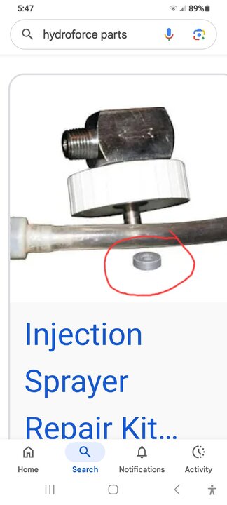

I'm changing out my dema valves on the hydraforce. It comes with a delron washer. Where does it go?
Dwain Ray
Jul 22, 2020
849
If you're talking about a thick grey or white piece it goes in the hole the handle screws into it is used to hold the Venturi in placethe handle bottoms on it and pushes it against the venturi jet so it doesn't blow back and out

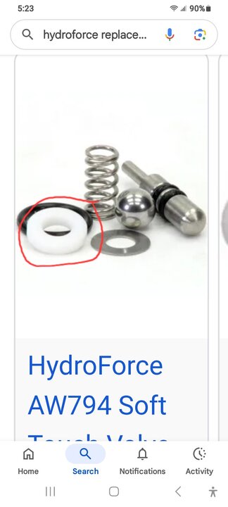

No, its a thick black washer. Amazon calls it a Delron washer. 1Z0F993R0394448434
The one circled on the right in the pic.
Dwain Ray
Jul 22, 2020
849
If you look closely inside where the handle goes you'll see the venturi . Its held in with an oring that thick washer is a spacer that holds it in place the handle screws in against it

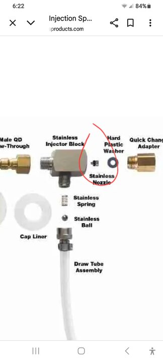

I don't have the quick change adapter, just 1/4 inch long nipple handle. Will the washer go inside the 1/4 inch pipe handle? Or should I order the adapter to push against the venturi?
Dwain Ray
Jul 22, 2020
849
Yes!! thats the way their built that picture is a wanders adoption. Handle, adptor what ever put the washer in the hole and screw a part in and be done with it whatever you screw into the end PRESSES THE WASHER AGAINST THE VENTURI TO HOLD THE VERTURI IN PLACE SO IT DOESN'T BLOW BACK OUT
