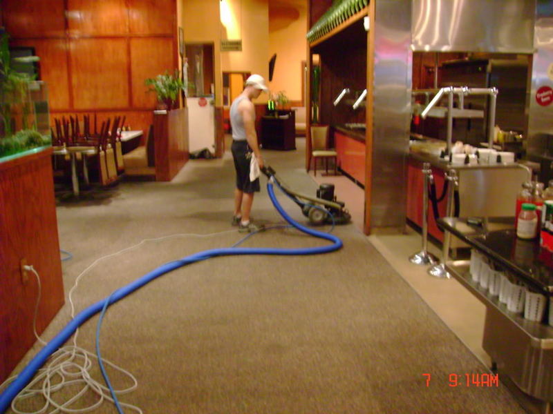

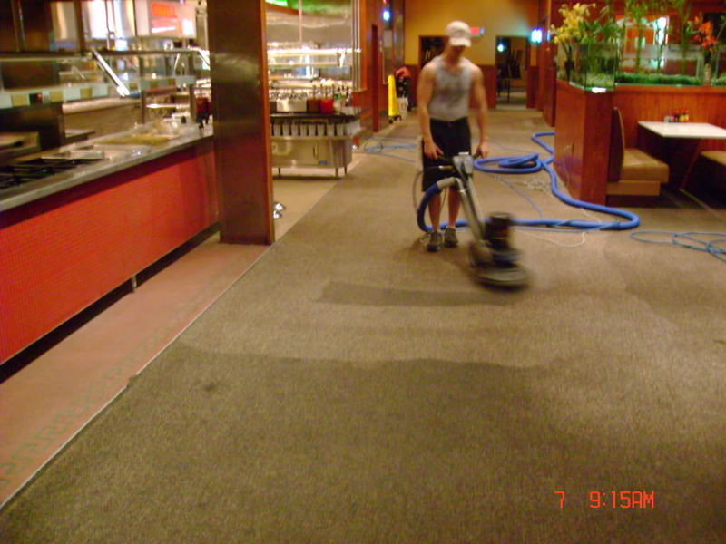

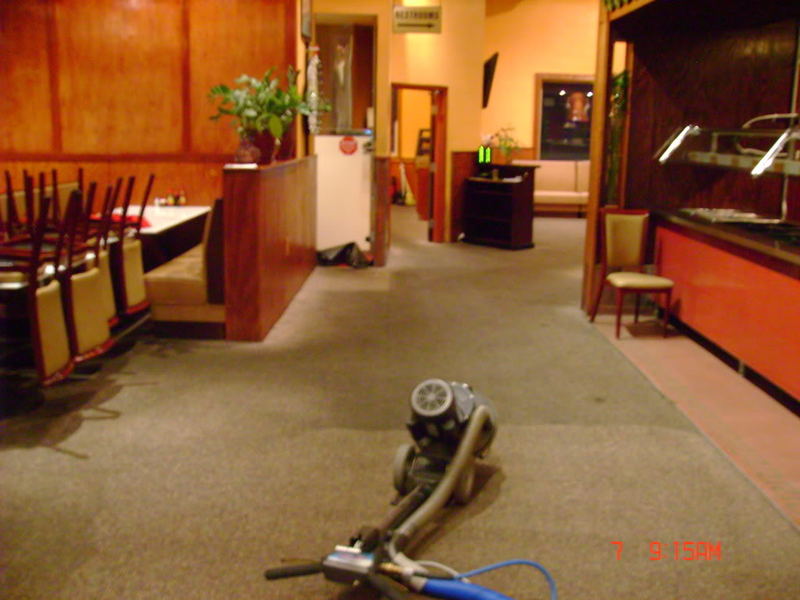

I have no clue why anyone would install olefin carpet in a grease laden restaurant. I have to clean this carpet with the RX or it streaks really bad. I modified my want and that helped a lot, but it is still not perfect. The RX cleans good but is a little slow. I am also tired of doing late night work and baby sitting my helpers. I am hopeful of the day that I can get a wand that is fool-proof so I can give it to my chimps and let them go to town. I think the new Stryker wand will help me speed up production, and it appears to flush the carpet pretty good. We will see. I have doubts that any wand will clean this carpet unless it is a rotary tool.

I really never have a problem with streaking except for this one job. Even on residential berber, switching to 110's in the center of my Prochem 4 jet wand made a big difference. I even tried cleaning with the wand and post padding and I could still see streaks so I just use the RX now. I wouldn't mind using the stryker wand. I wish they would get it finished.

Is that a glided RX? It looks like it from your results. I was never able to clean CGD with an RX before glides.

I have been cleaning for seven years and never had a carpet streak. This is just a weird situation. And yes only a hack would not try to resolve the situation. I have tried a pre-scrub and post pad. The RX gets the job done right, but I only have one and the job takes way too long with just one tool going. If I had another one, you would have never heard about this issue. My prochem wand has 95's on the outside and 110's on the inside so there is even coverage all the way accross the wand. I lowered my pressure. The streaking is just barely visible and you really have to look for it. The wand just doesn't clean and flush as good as the RX on this carpet. I don't really want to buy another RX, so for now I think I will add a glide and jet extenders to my backup 4 jet. After reading threads for a year about all the different wands on the market I have come to the conclusion that there is no magical wand that will clean in all situations. A holed glide isn't the best tool for a cleaner going for speed and production cleaning empties etc. A cleaner needs an arsenal of tools. My arseanal includes a non glided wand, soon to be glided wand, RX, 175's, and a bunch of hand tools. If a better option comes along I will upgrade as needed. :wink:
