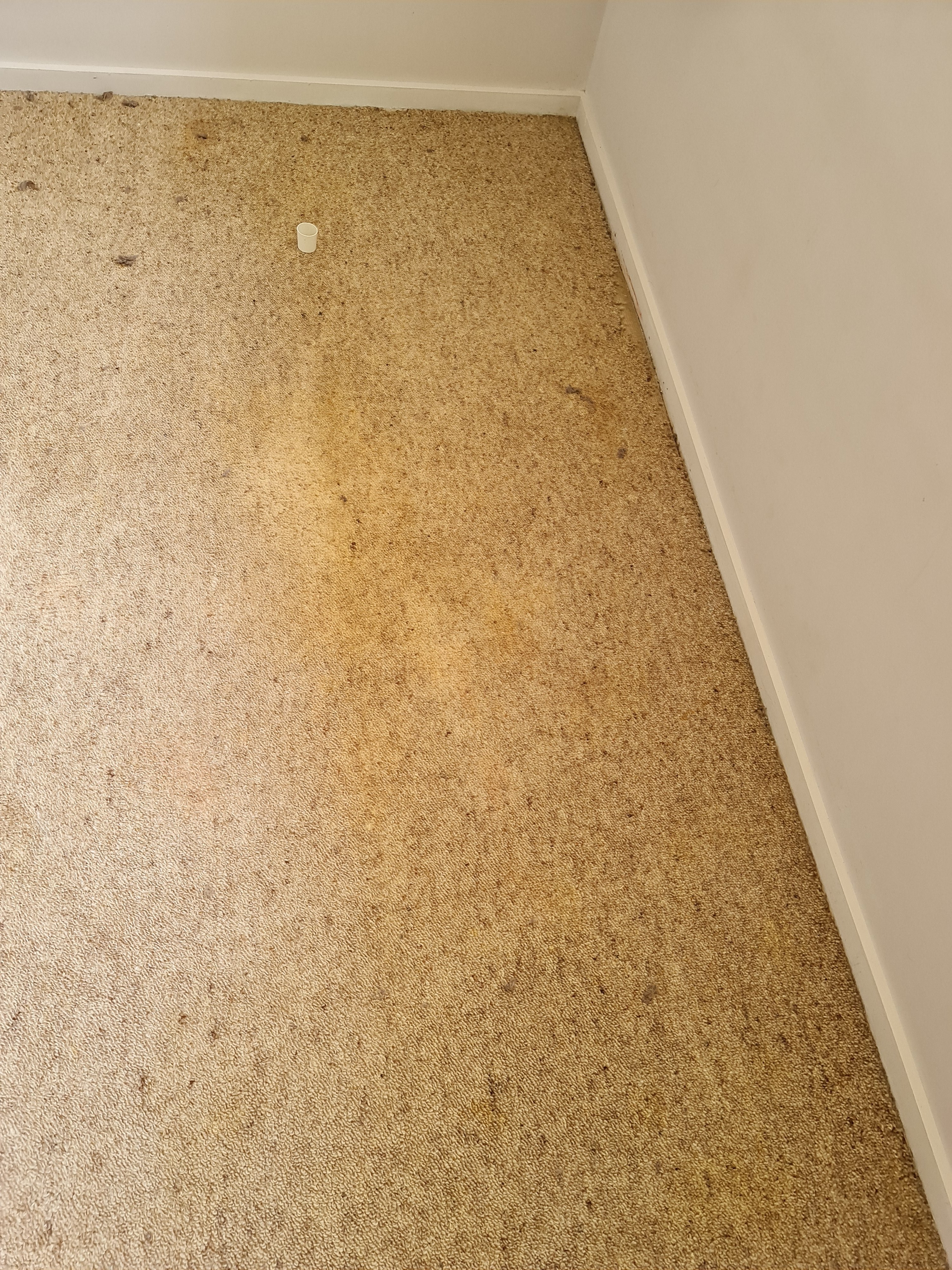

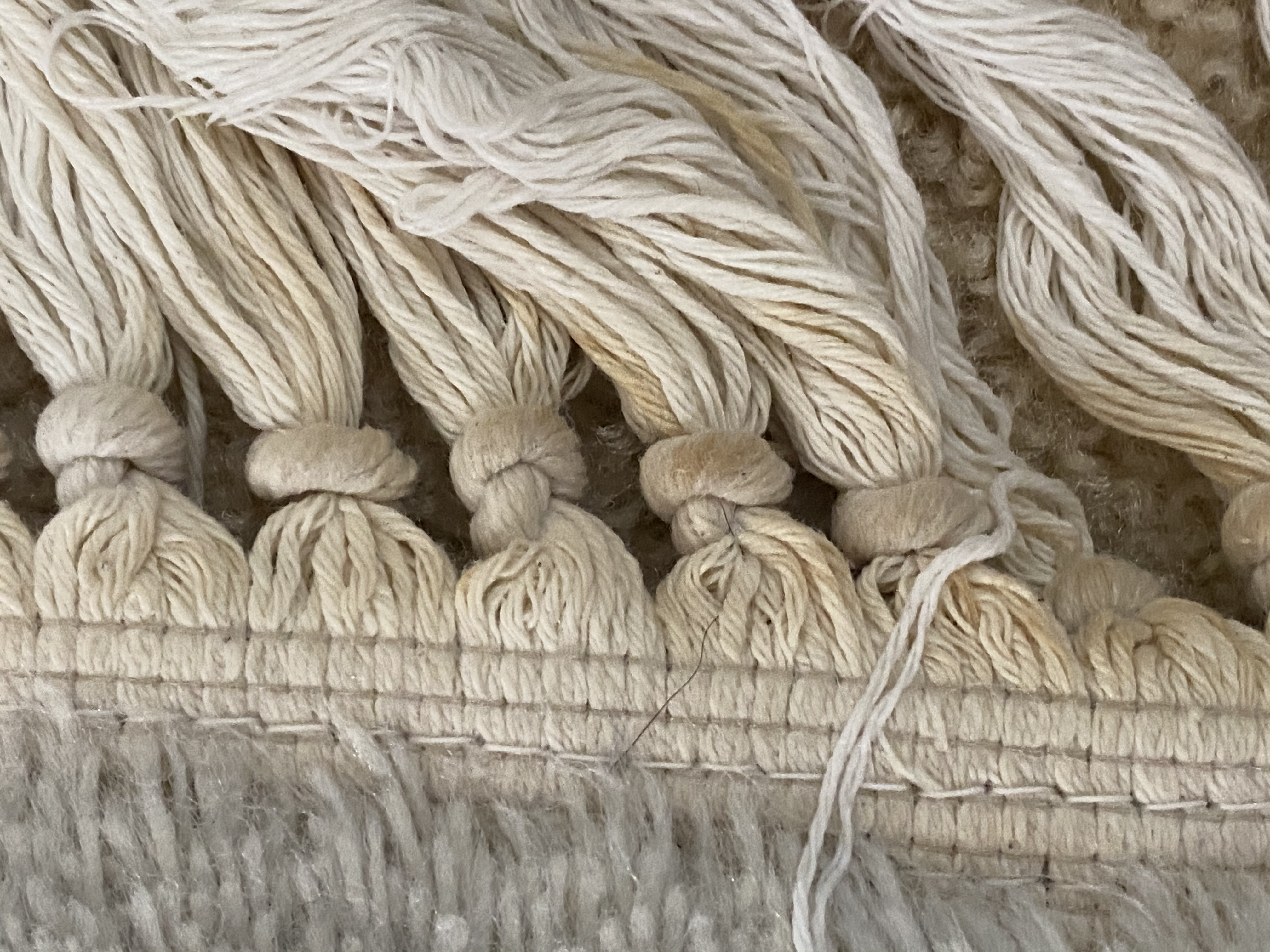

Browning of fringe
Did you pit wash it or try and clean it with your wand?
That was pit washed. I ended up soaking it with acid rinse and drying it face down on a canvas tarp. I placed air movers on the back in an effort to reverse the wicking. It worked. I also sprayed the backing with peroxide as a post treatment which cleared it up more.

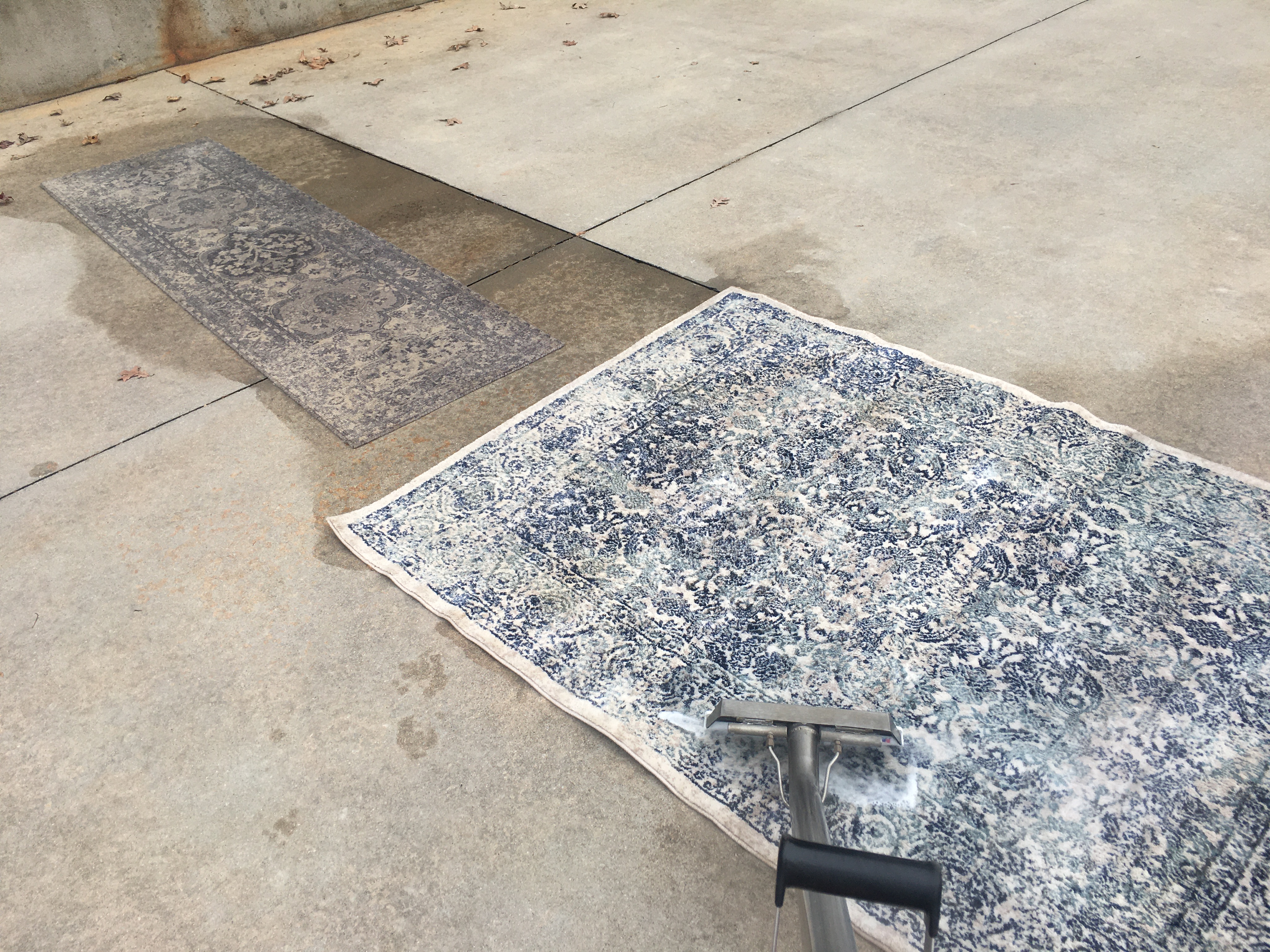

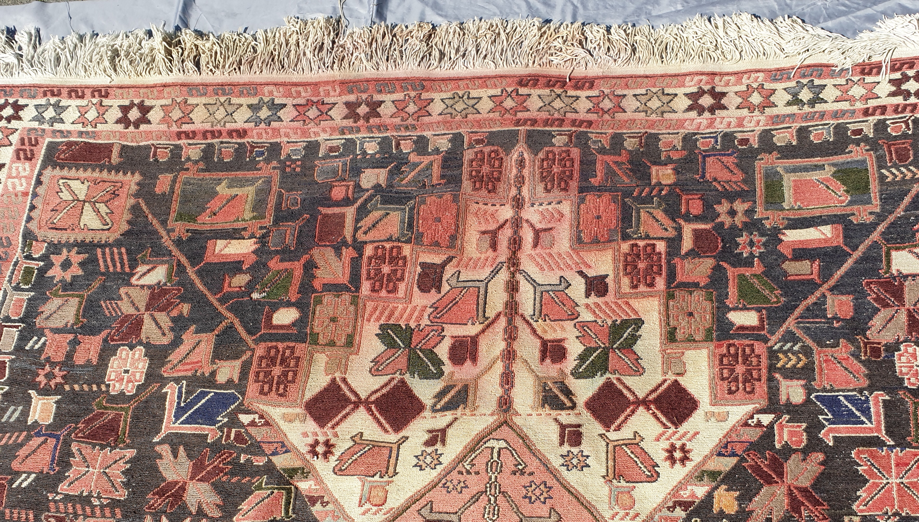

Here is a bleeder for you... the after is going to cost you.
They stored it in the basement and the faucet broke because of freezing and then they dragged it up the white steps. I got the rug looking like new the steps did not turn out as well.

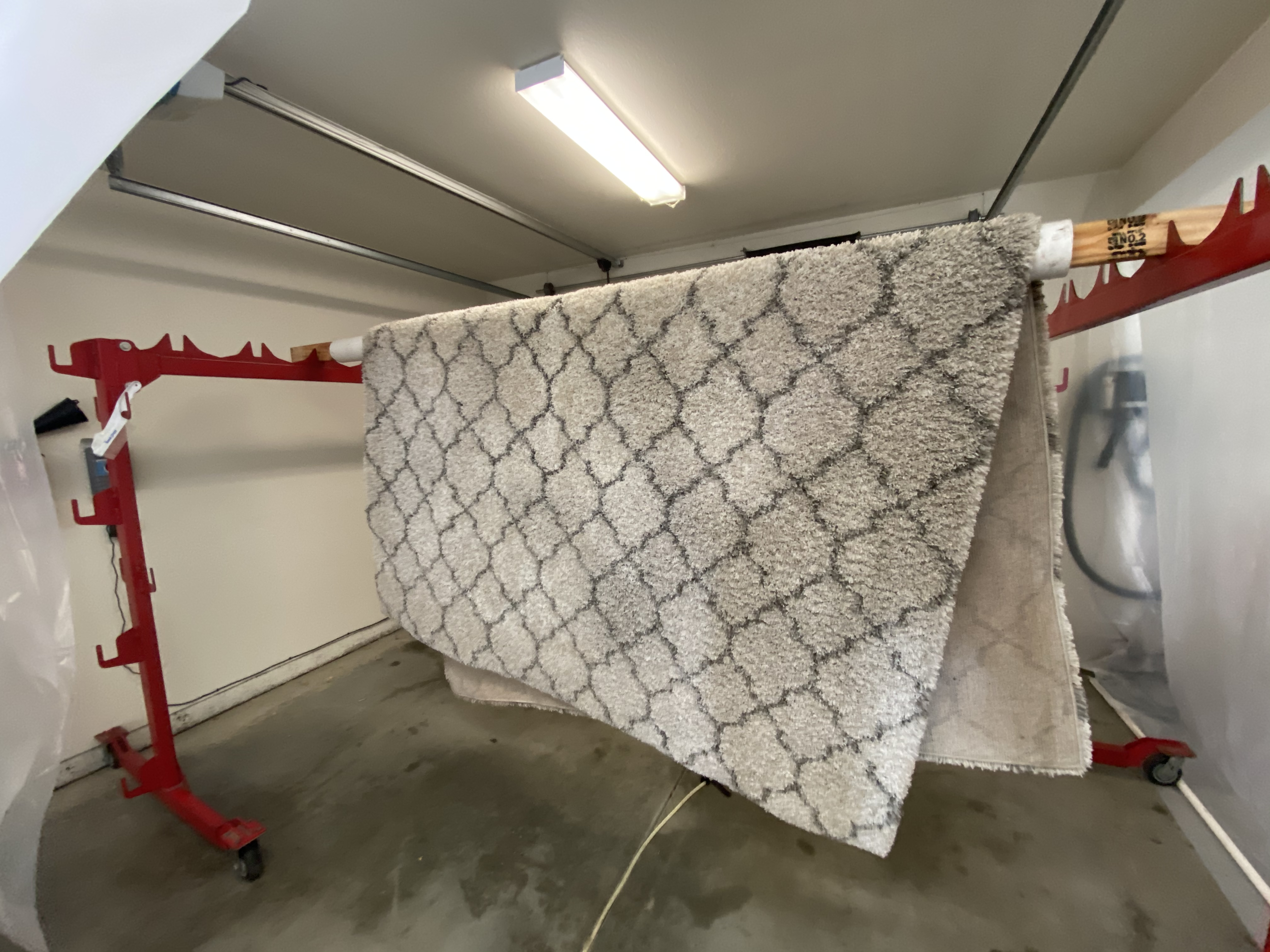

Got the monster done today, and 5 others...
The big one is taking up 4 bars.
I think I’m going to need another hr. or 2 on it....
I’ve got 10 more that need to be done. They are all scheduled to be returned this coming week.
Boo, guess I’m working 7 this week.....

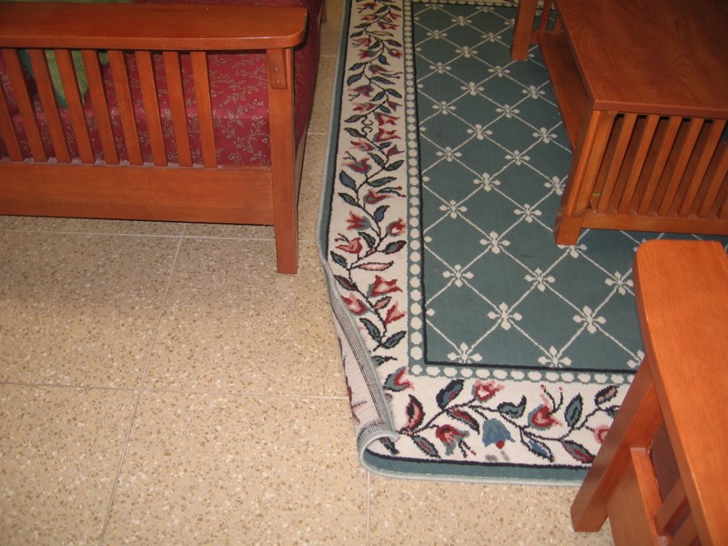

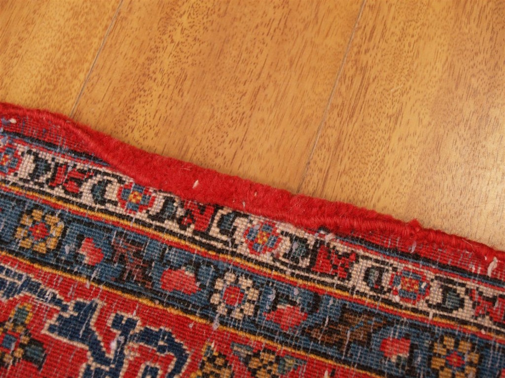

Edge Curl:
The picture you have is what I'd call ripples. The cure is blocking, so I'm not sure those procedures will be helpful.
The edge curl that rug cleaners see is more like this: (rug is upside down)
or this:
The first is caused by uneven tension (weft is too tight) that might be temporarily fixed using a steamer/iron. The second is from people dragging their feet and might be temporarily fixed by rolling backward.

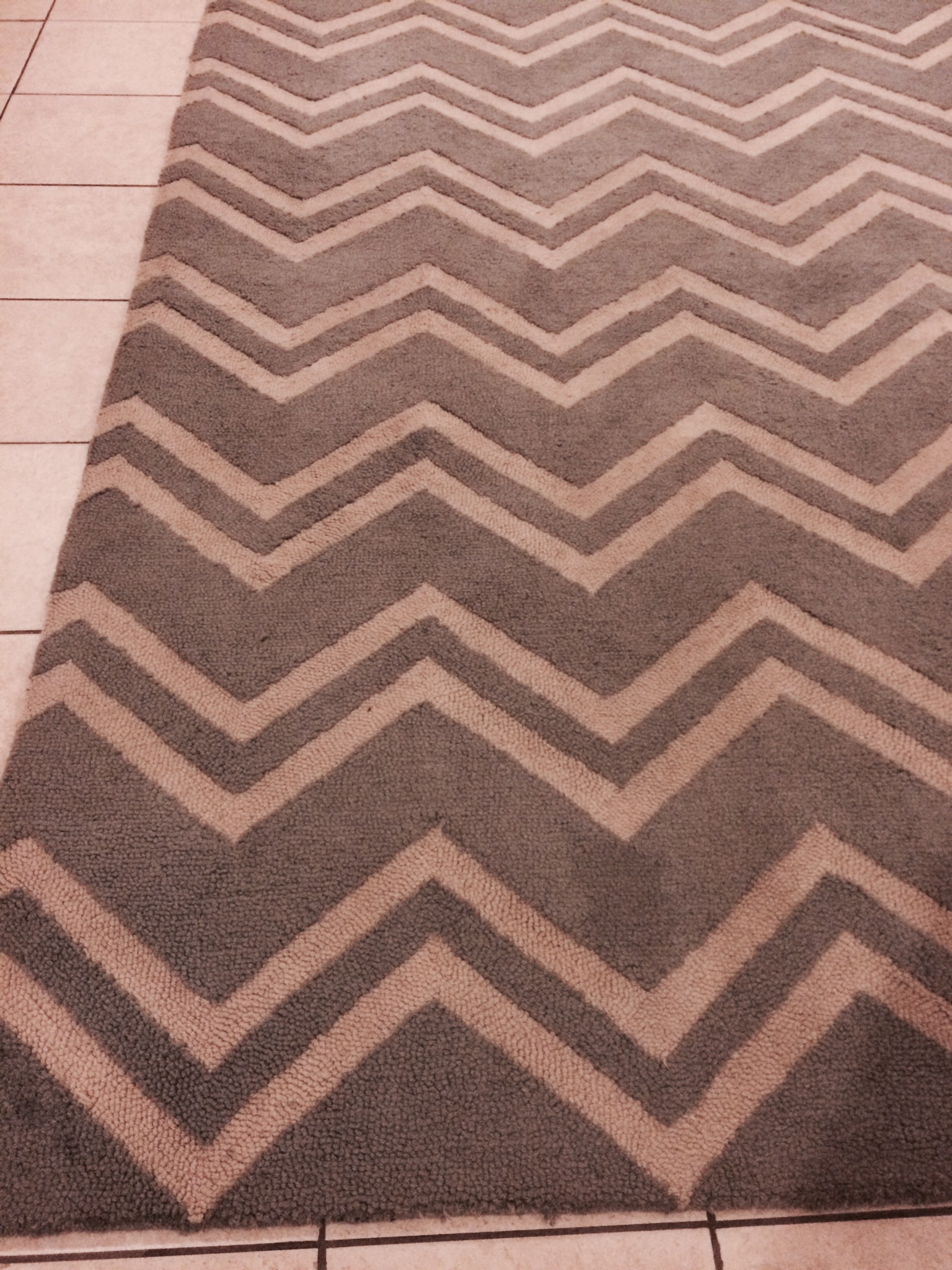

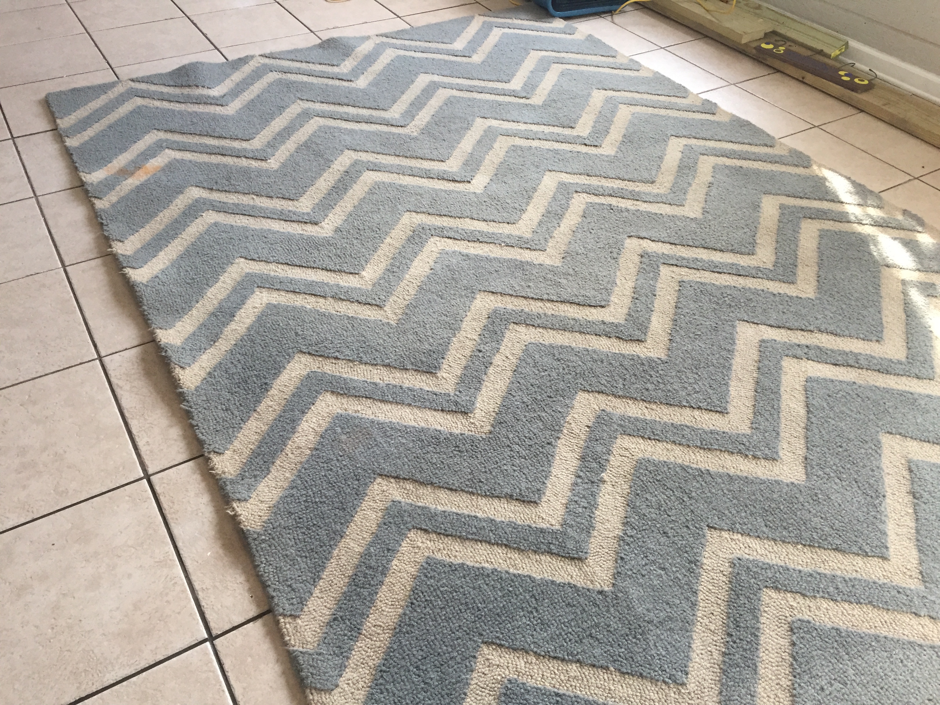

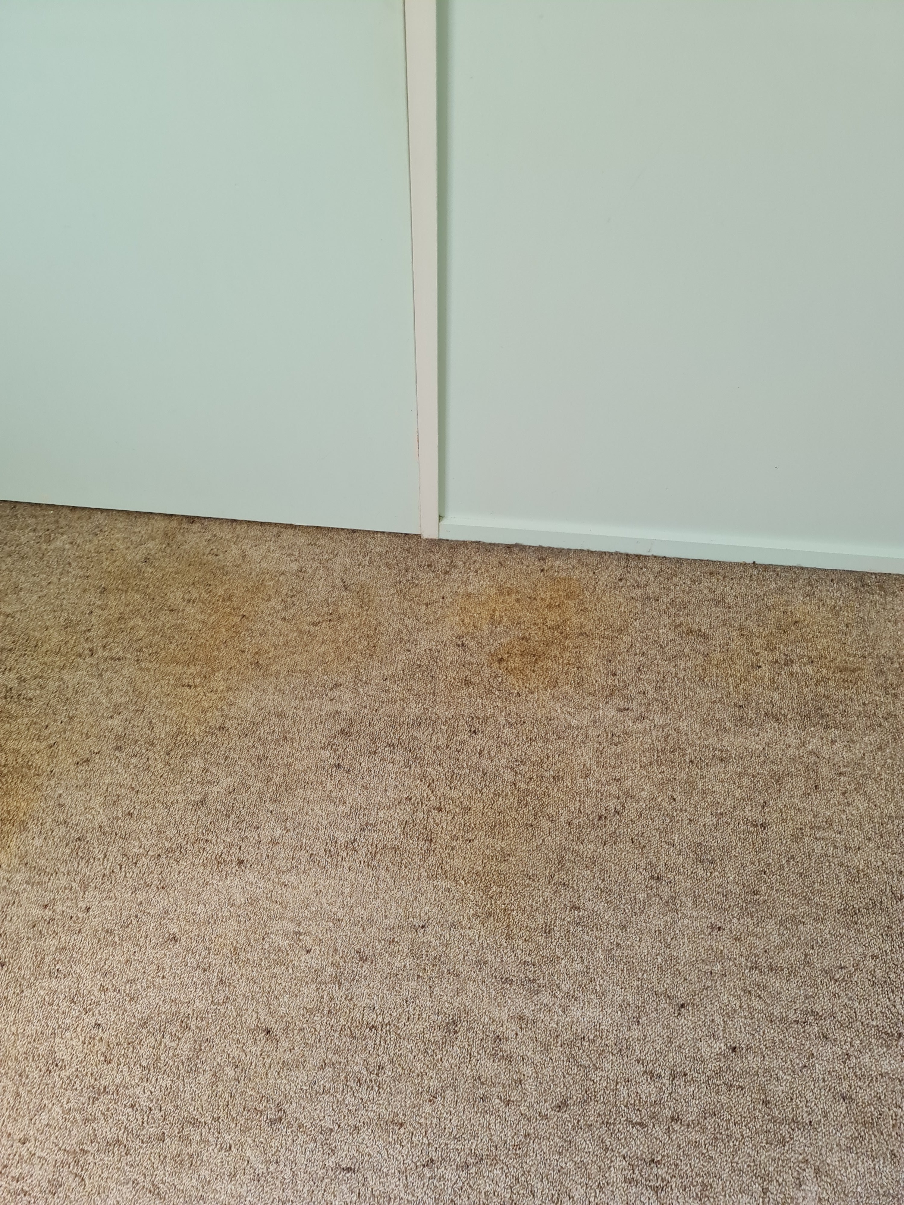

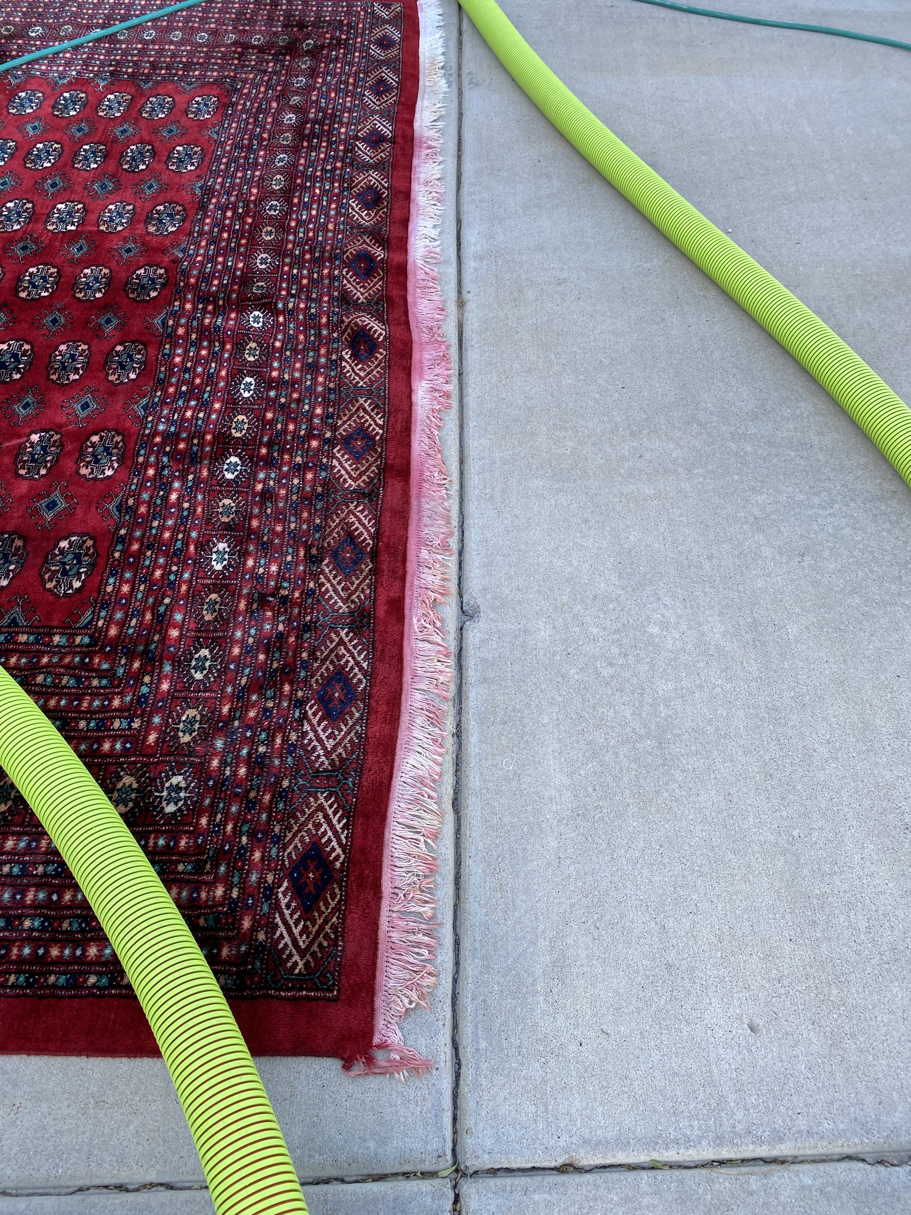

A wool rug that browned from alkaline washing, corrected with an acid rinse:
Not being critical Coastie, just looks like the floor has a similar browning issue. Maybe part of the first photo is a lighting or camera artifact?
Old Coastie
Jun 29, 2015
7,504
Stephen
No, the floor is a beige pattern tile. I guess we can thank iPhone or different lighting on different days for the way it changes tone between pictures.
14,632
Oh no!!! What do I do to fix this? I made the Concrete brown out around the rug!!! Lol
