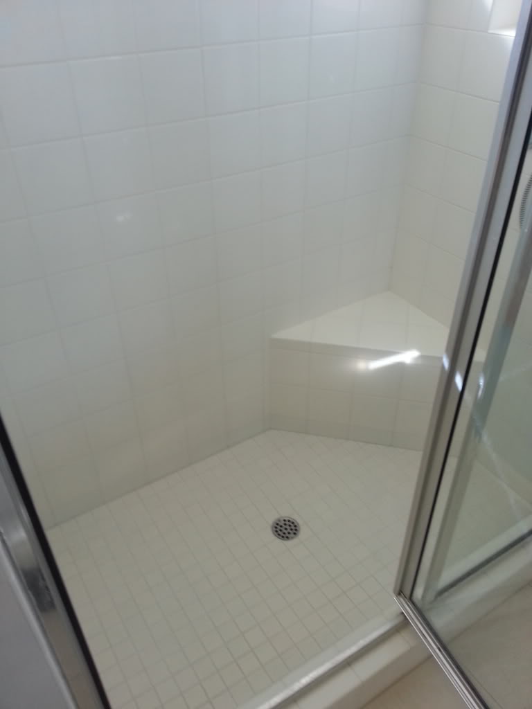

typically...

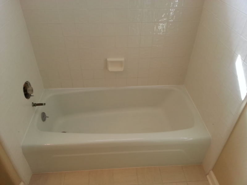

razor blade as much soap scum off all flat surfaces as possible.
Spray down acid cleaner or non acid soap scum remover and scrub
Rinse with shower head or pressure line
Alkaline spray and scrub, rinse again with Cobra hand tool
Dry

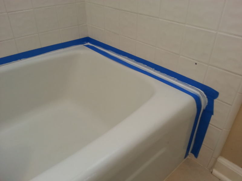

Remove damaged/rotted joint between tub and wall if needed.
Polish tub if needed with Magic Als, diamonds, steel wool. etc..
Seal grout/stone Leave fan overnight
Return next day to replace silicone or grout.
