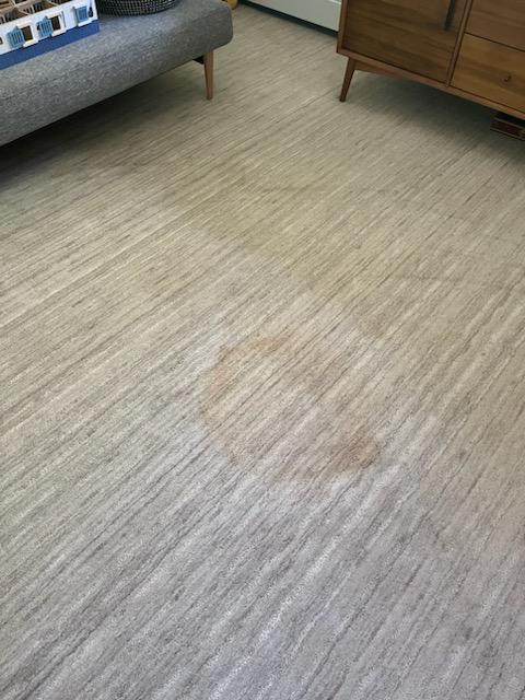

A customers pet had an accident on her Earth weave carpet. The bozo carpet manufacturing repeates mistakes made in the 70's and are using Jute as the backing. I warned the customer of the challenges this Poses.
I cleaned the spots and it looked good but the spots came back. I was trying to not get the Just wet, which the customer may have done with her DIY attempt.
Should I Wet it more and extract more when I reclean it.
walk away and refund money
or use encap and op machine?
I use Sauger encap cose red.
14,624
It's probably just some left over residue from the customer's attempt with their magical product under the sink. I would go back and do just an acid rinse over the spot with about 300psi pull back rinse only and leave a fan behind. I've cleaned several homes with the old jute carpet backing and was successful.

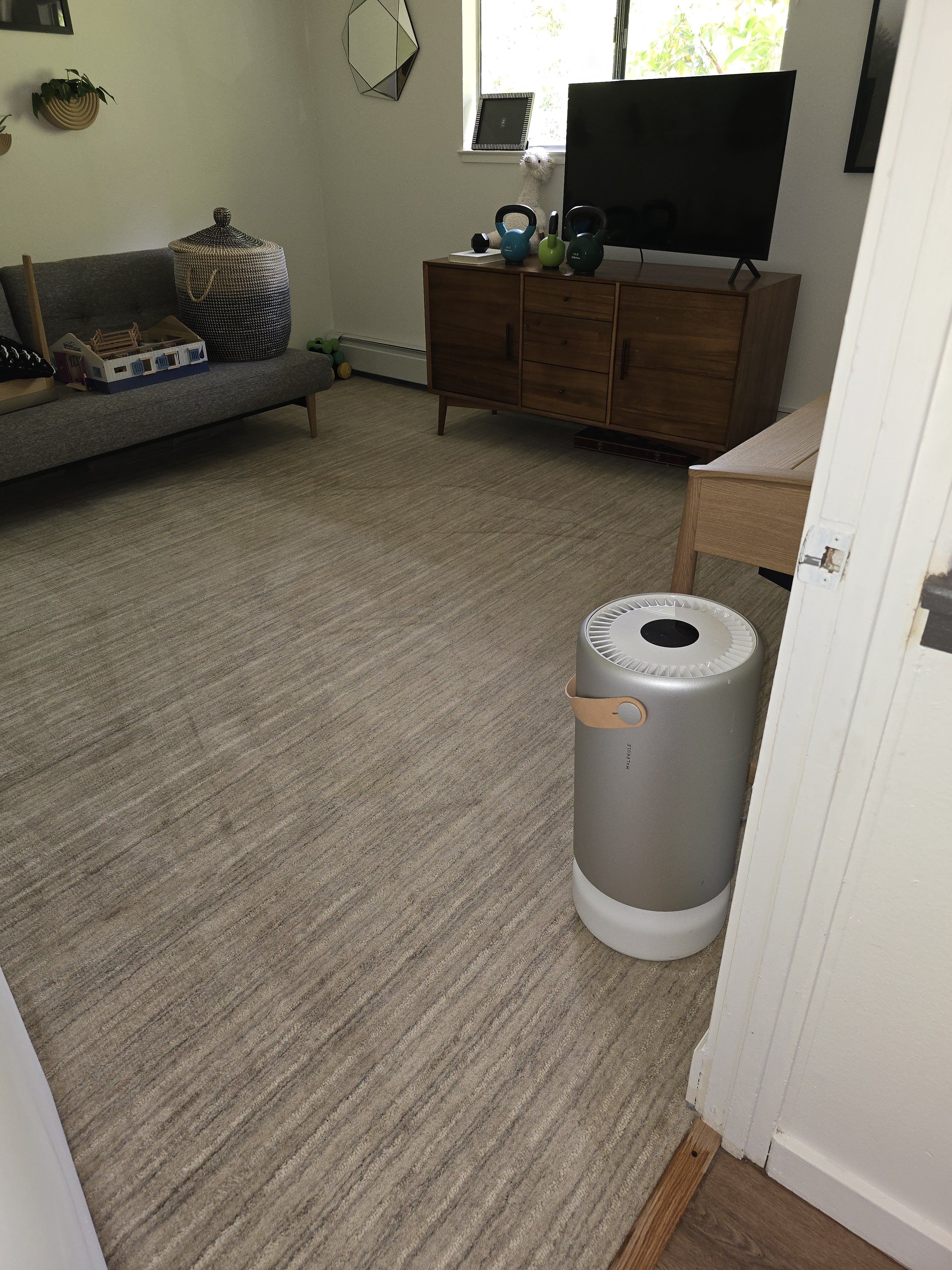

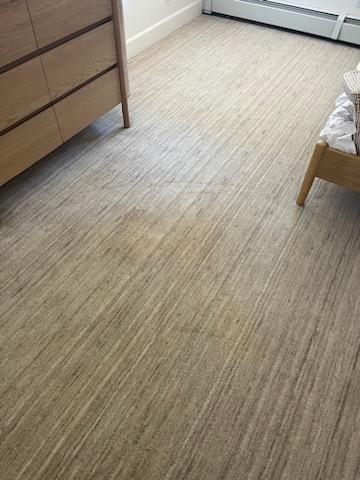

The 1st two photos are after it dried and pretty much same before the cleaning. The last is just after the cleaning. I'm just concerned about over wetting the jute.

Very nice to know this going in. Earthweave carpet is very prone to massive shrinkage if it gets too wet. I've seen it shrink more than two feet over a water-damaged 20 foot installation. (It's difficult, but it can be restretched that far. You would probably have to prove it to the installer as I did.) It also has an adhesive that can wick color that looks like your stain, may go away when rinsed, possibly can be removed with a strong solvent, but may still comes back as it dries.
You could point the customer back at the seller, but if they're like our local boys they don't know much about the product.
Earthwise recommends Host only, if that tells you something.
