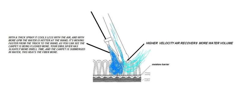

Dealing with wicking issues, is one of the problems that I wanted to address with the O-2 Neutral Rinse.
A lot of wicking comes from dirt being saturated in the tuck of the carpet. We can only extract down to
the moisture barrier and not past it.
As the carpet dries, this embedded dirt in the tuck of the carpet is drawn to the surface of the fibers.
With the soap free O-2 Neutral Rinse, it has a ingredient called sodium borate.
As you extract the carpet you are leaving a small amount of sodium borate in the fibers.
Which evaportes into hydrogen peroxide gas as it dries, no residue after drying.
There are three things that the borate will do to help when extracting.
#1 - Preventing embeded soil from wicking to the surface.
#2 - Continuting to brighten a dingy looking traffic area.
#3 - The borate has disinfectant properties that deal with odor problems.
The next issue when dealing with wicking, is we all know that the sooner the carpet is dry the better.
So we have 99% IPA in the soap free O-2 Neutral Rinse to accellerate the drying of the carpet.
This is especially noticed if you use a air mover.
