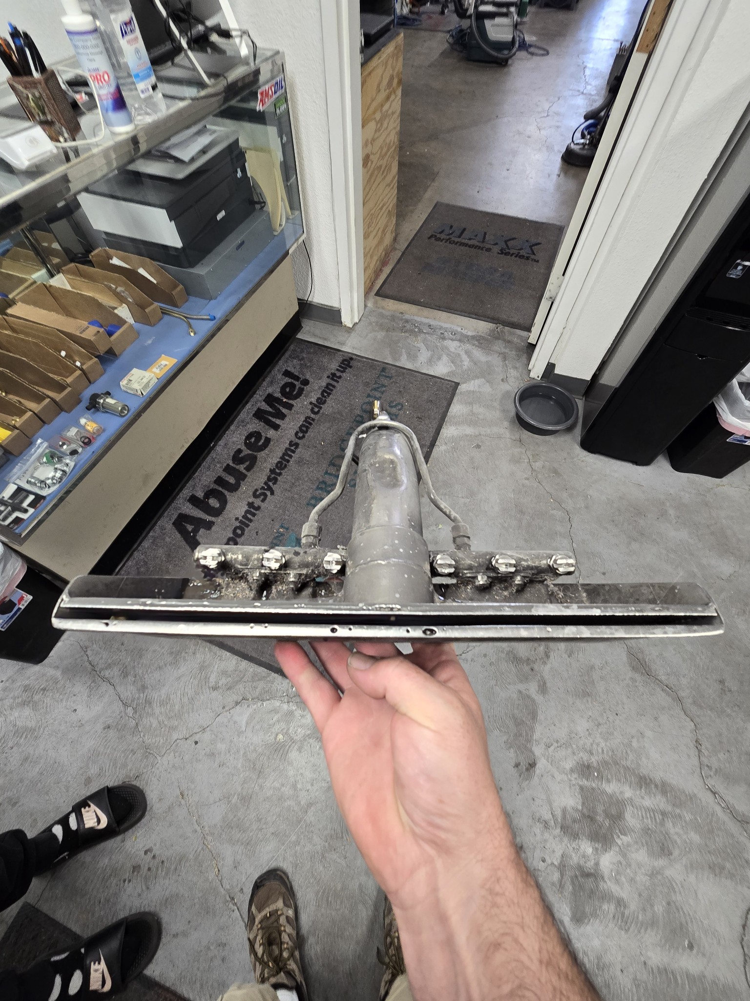

I believe offset wands are harder to push , so you know what wand to buy if you have these issues. I’ve never liked anything offset
117,284
  • Wow
Reactions: Josh Wood

I’ve probably got six “sliders” that fit that tank stuck in a drawer somewhere
