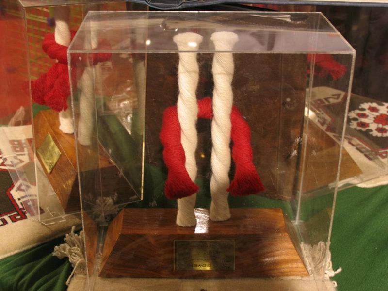

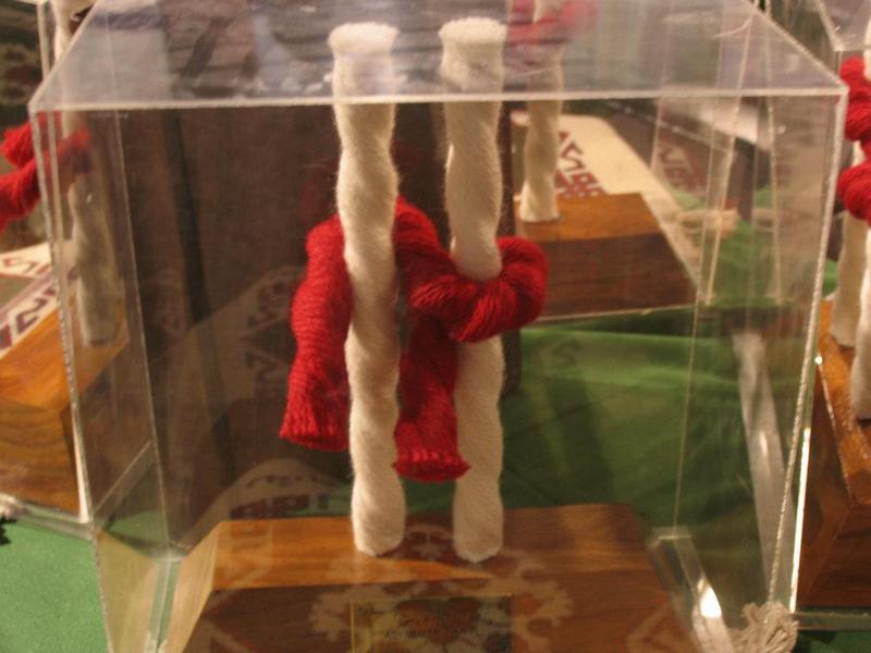

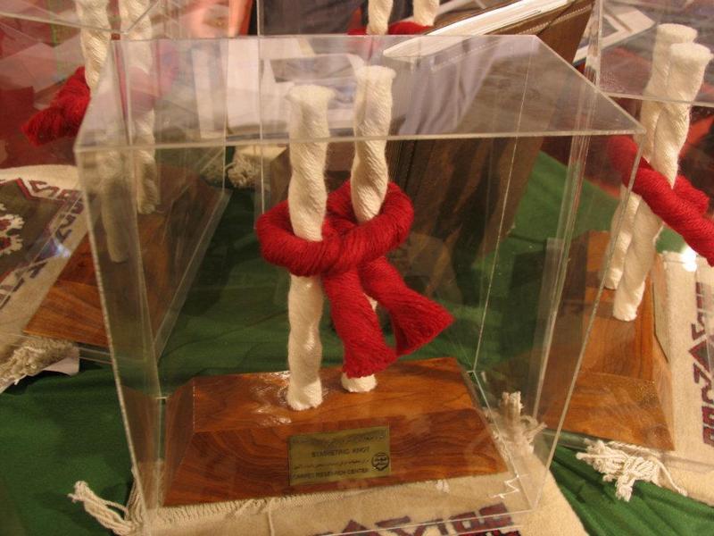

Tom Monahan

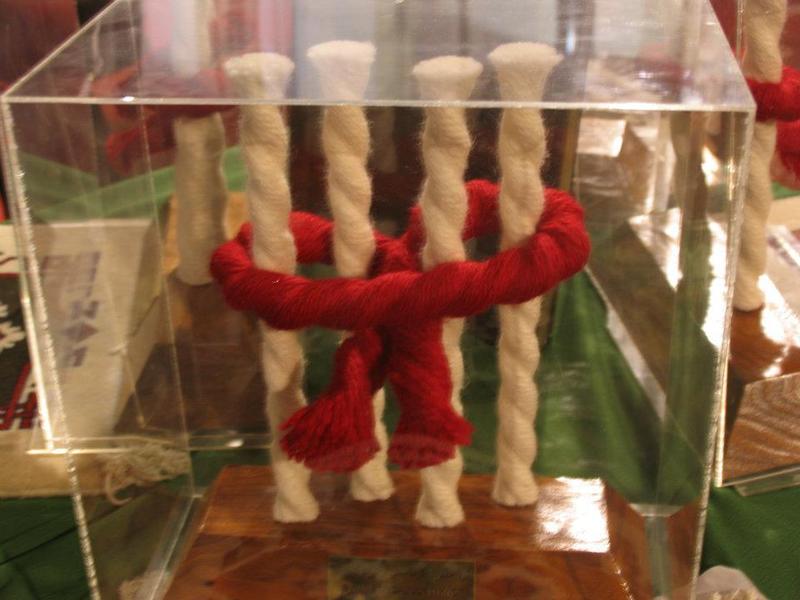

Illustrations of common knots found in rugs:
White verticle yarns are the warps. Wefts are not shown in these pictures.
Quiz: Can you name the type of knots shown above?

Jeffrey Scott Warrington
Symmetrical or Turkish knot
V weave or velvet knot
Another symmetrical knot but this time around 4 warp yarns rather than two. This is done to save labor time and makes the rug cheaper. It requires less knots to fill the same space.
Asymmetrical or Persian knot open to the right
Showed all those knots in the rug ID presentation at Mikefest 2 weeks ago.

rhyde
The term is Jufti when a knot is tied over 4 warps vs 2
