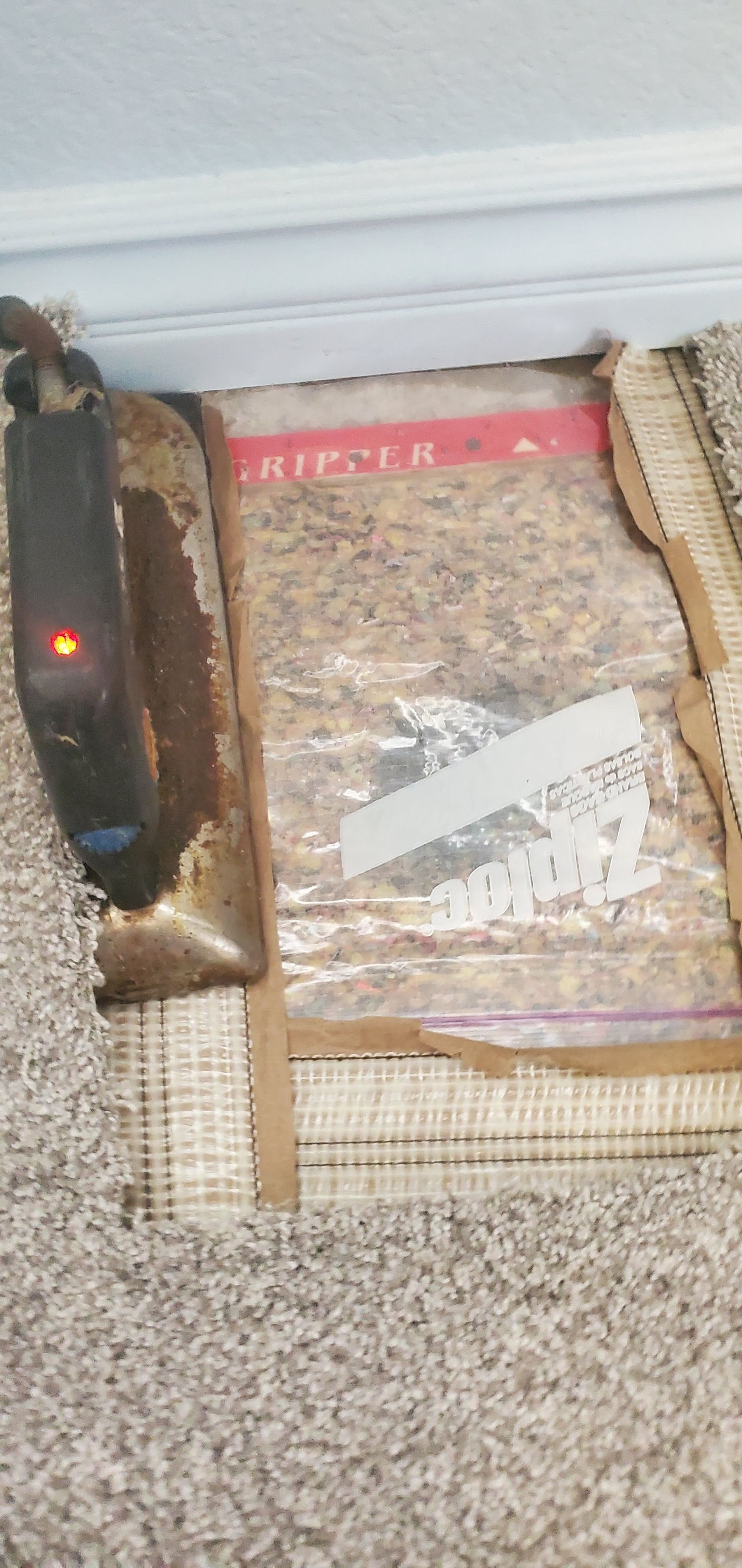

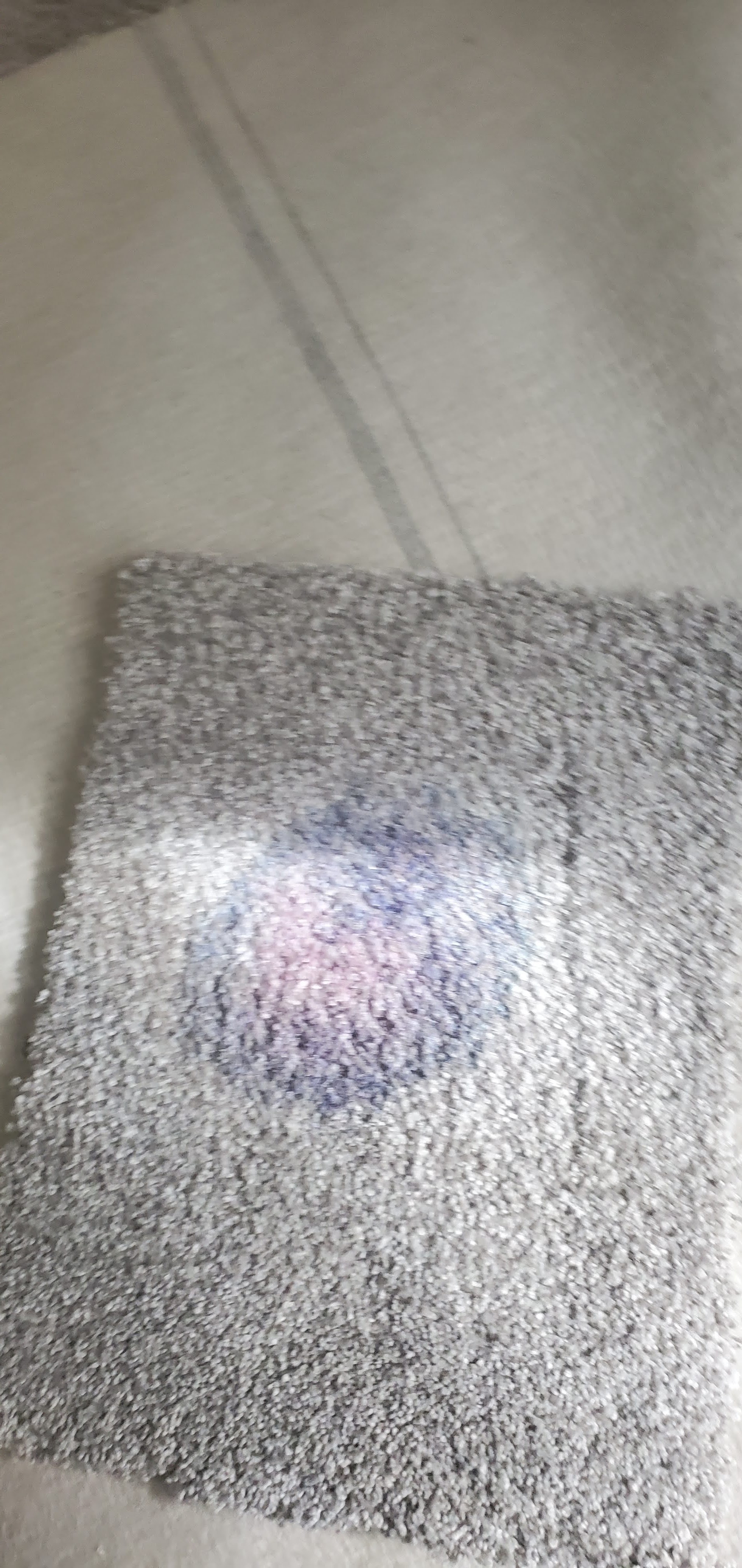

Seriously not all ink is created equal, just cause you got lucky on a sofa and thought you were a hero.
I had a small drop in carpet explode ended up patching it.
You can see the size of the ink spot in the pad.
View attachment 115320 View attachment 115321
been there done that . many times, sometimes even getting rid of the saturated pad with a piece from a closet. those tiny specks can be murder.
been told , that a broken pen lay in the same spot for a long time. draining the ink through the back , into the pad, lurking there waiting for an unsuspecting carpet cleaner trying to be a hero!
