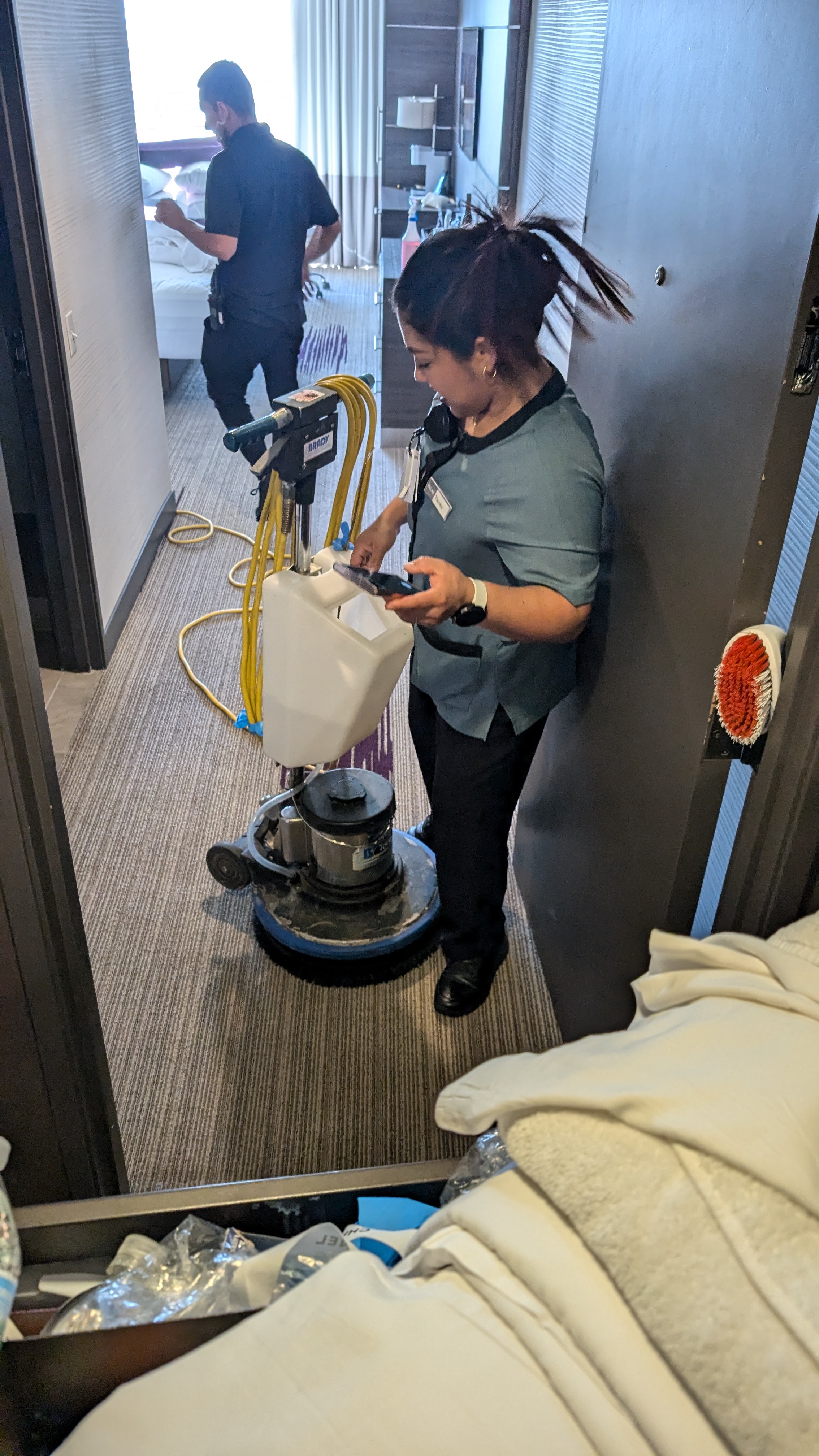

Use a 175 or OP machine equipped with a Fiber Scrubbing Pad to agitate. CRB machines can work in lighter soil conditions but are too lightweight to break greasy soil loose in most situations, regardless of how stiff the brushes are.
