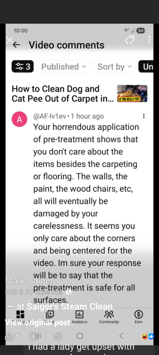

Is this review of Saigers "wrong"
117,240

Did they apply the pre-treatment to the walls and chairs? Was it careless?

Atomization takes our "Pre's" further and wider than you might realize..
So what's the solution?
Isn't the Urine also destructive, more so after it converts to Ammonia?
117,240
My question isn't just about urine treatment but the whole priest spray in the swiping of left to right with our two foot hydroforce lances..
