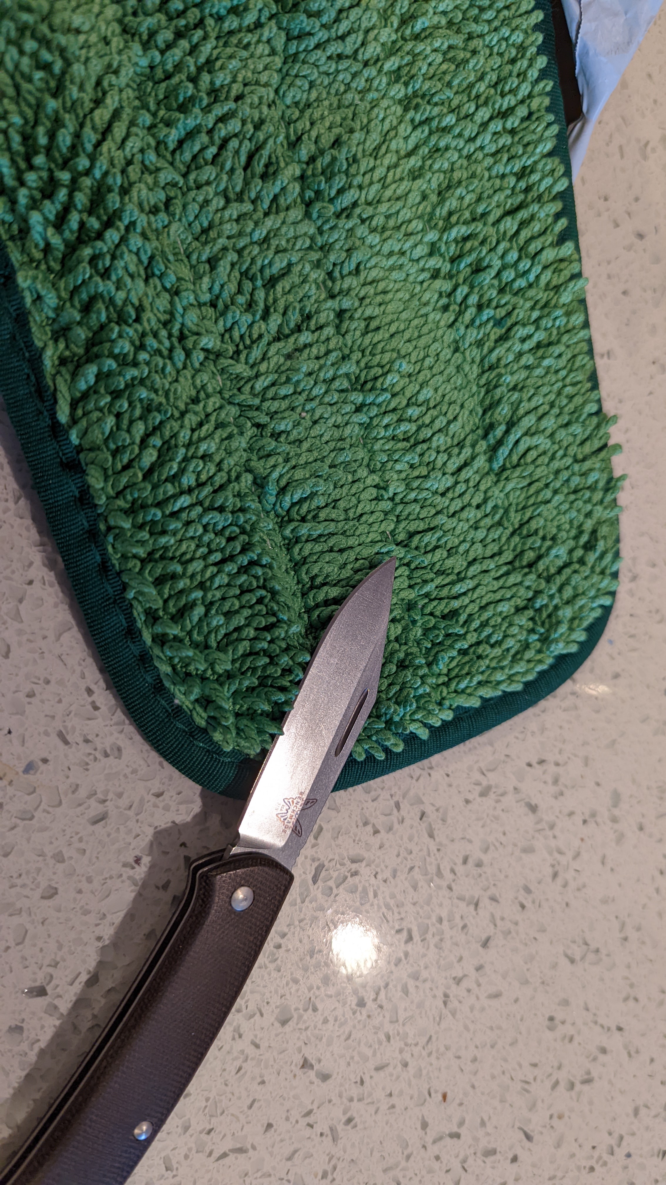

Oh come on you telling me you don't notice how long those little magic micro fingers are on that mop compared to all the restI'm excited about that Benchmade!

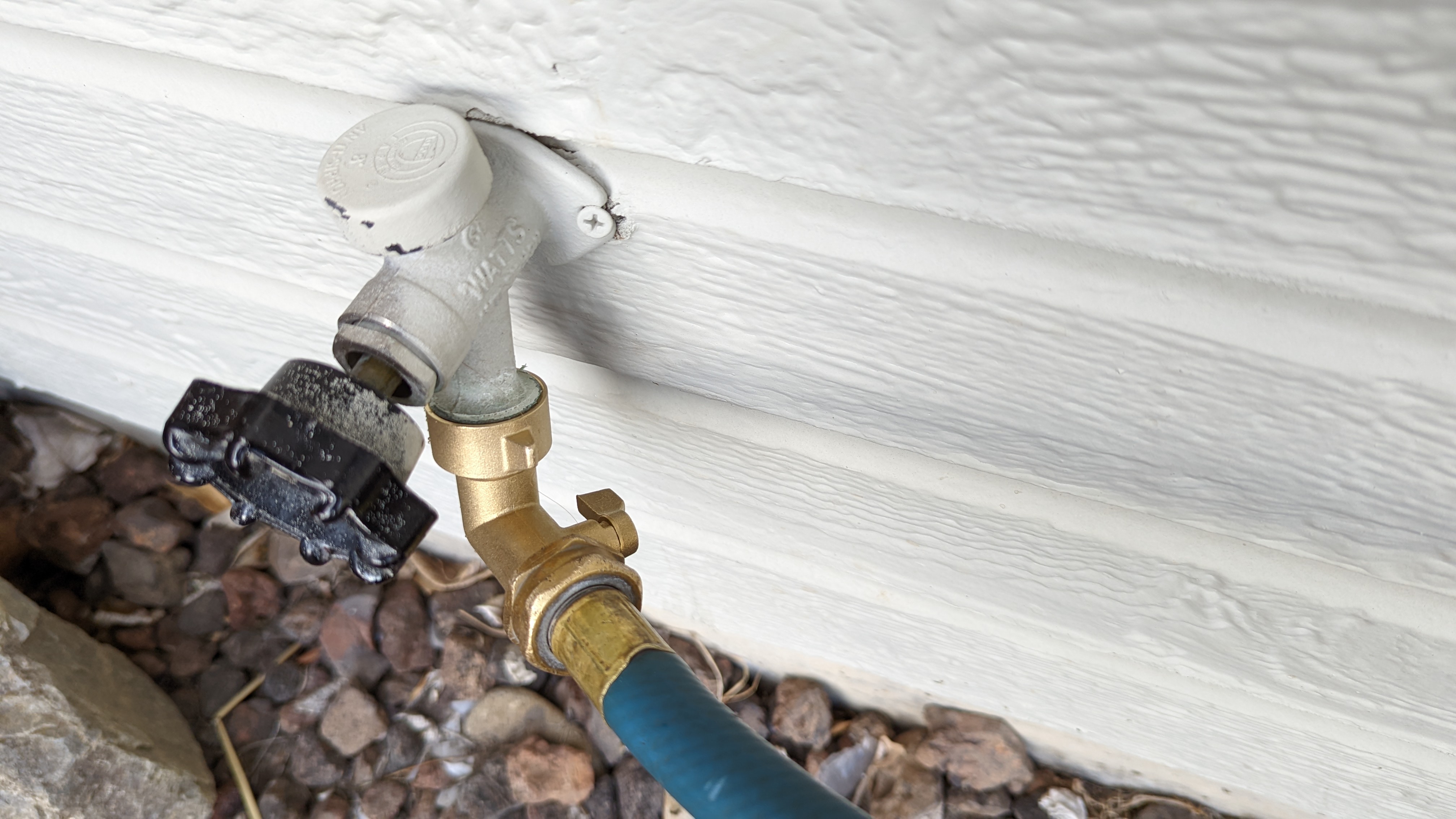

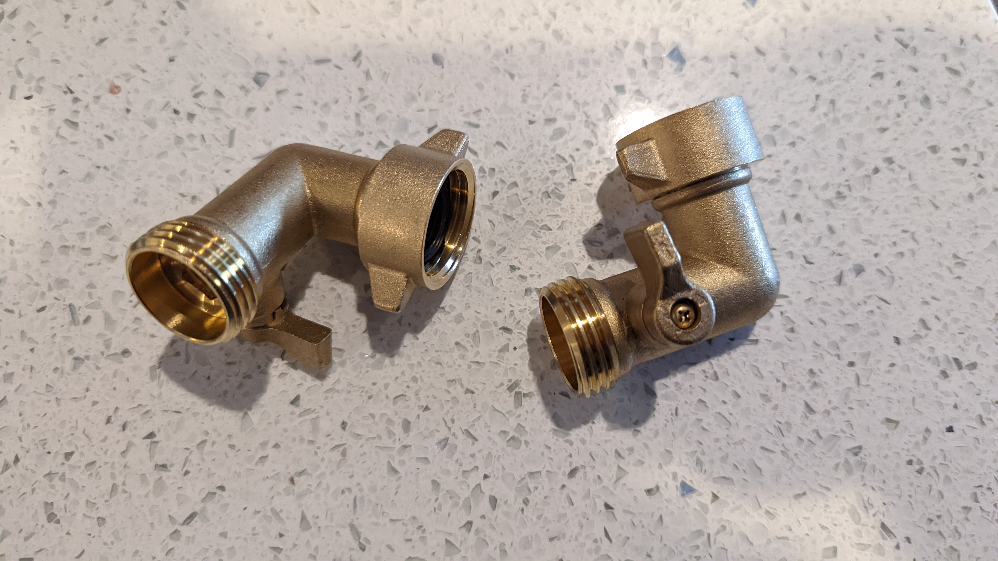

I'll give you one guess...What ya using elbow thing for?
Depends on the application.Oh come on you telling me you don't notice how long those little magic micro fingers are on that mop compared to all the rest
Water hookup?I'll give you one guess...
Link? I want one

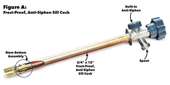

How would that tell you if there is a leak under the house?Those are the good ones...you can see 'em
it's the frost free one's that burst inside wall.
they don't spray/pour until you open the valve.
always, ALWAYS, ALWAYS kink your hose and check for back pressure regardless of season
Put your adapter on and leave it shut off.How would that tell you if there is a leak under the house?
Open the faucet.
If you hear water running it is leaking behind the wall.
The main reason that frost free units break is because they didn't disconnect their garden hose. When it freezes, the water expands into the pipe and eventually breaks it.
I've seen that.and/or some idiot installed it wrong (tiled back) and it doesn't drain out
