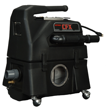

Ok...Thinking of a women tech here....this is for "empty" rental turnovers. This would probably not "fly" in an occupied residental setting. For one thing you are utilizing all on site resources, toilet, tub, hot water, waste disposal on site, substanial electrical usage, very loud. A residential customer would lose their mind!
Provides for near continuous cleaning....
Rotovac CFX PowerPod...39 lbs
CleanCraft 150psi rescue box pump... 12 lbs
Mytee Turbo Hot...2400watts...22 lbs
Now add the tools...rotovac, glided wand,etc and a OP/rotary machine ....especially ones that "compact" for transport. Also a 20 lb vac booster could be nice.
Does anybody make a better 300psi or more pump... packaged...to plug in? Better heater in same weight range?
Who makes the lightest, most compact, yet effective OP machine?
That is a bitchin little machine ,Tom. I saw how they have a large fresh tank that can snap onto also. How is the vacuum? Is it dual 2 stage motors?

With just a single wimpy cord on that thing, I can't imagine the motors being anything special, so the vacuum is probably pathetic.
For the price Rotovac wants for that slug, you'd be FAR better off either getting an M5, or picking up a used Mytee on Ebay and pimping it out.
Big deal, so they put on a 250 psi pump and a 27 gallon holding tank. They already have provisions for hooking directly up to a faucet. Why settle for that wimpy ass 250 psi pump, when you could get a killer external pump with the flow and pressure you want. Plus, the water would be hotter just running it through the solution line, versus letting it sit in that big ass tank.
I don't see any pricing on their website. I thought I remember the original fetching about $2500. Now with the added pump and tank, it should easily surpass $3000.
To each their own, but anyone considering one of those, should really reconsider their long term business plan.

Just talked to Rotovac ...PowerPod Only!
duel 2 stage vac model, single cord...$1600
duel 3 stage vac model, double cord...$1900
For another $100 they will give you a wand that presumedly works at household pressure.
Comes with connectors and hoses for house hot water hookup.
Both models can be connected to your TM vac hose and will act like a vac booster that pumps waste to on site disposal.
The things that appeal to me are... small size, light weight, on site use of resources, automatic on site disposal of waste, ability to connect to my TM when needed, credible "back up" performance. I still think you need some pressure and a hot water booster.
Anyway...Rotovac is actually somewhat close.. 100 miles..probably should run down there towards the end of the month and see the demo...if I like what I see.. I will take their 7 day use demo and try it out on some rat nasty rental carpets and write a review.

One thing to be aware of with the CFX, it has sharp little hooks, (4 of them) that connects it to the docking station.
These are at about calf level.
When carrying the CFX, it can easily cut the skin, (for those that wear shorts), especially carrying it up or down stairs.
Other than that, it has plenty of grunt with two leads, DUAL vacs; and waste pump-out.
The pump out is also pretty good, but make sure you install the filter correctly, sideways, not up and down with the ports (holes).
You may also need plenty of foam buster when cleaning after previously poor cleaning techniques. !gotcha! or you may find foam coming out the exhaust pipe.
For this reason, I also tie the electric cables up to the carry handled with velcro straps, well out of the way of any moisture.
It is a damn good little workhorse, albeit a tad noisy.
The docking station can be awkward to take up and down stairs with all the weight hanging out over the front, (I don't), having two people makes it easier, but.............................
This reason alone makes it impractical for the average woman, let alone an old fart like me. shiteatinggrin
I have modified my docking station by putting in a float valve so it is continuous fill to about five gallons, not twenty-seven.
I have also added a tee piece at the rear where the solution goes into the 250psi pump, which has a long tube running to the front with a tap. I have it tied off to the metal solution line. !gotcha!
This allows me to easily empty the fresh water/solution tank of any excess water, instead of sucking it out via the vac; hose.
I can get really close to most jobs, so it stays in the van nearly all the time.
I'm currently looking at putting a 500psi pump in a wheely box with a five gallon resevoir and continuous fill, using this as my solution pump, and just the CFX, hooked up to my 360i.
