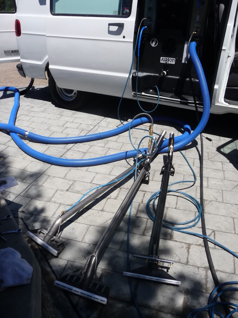

Hey Mike....how about some pictures of the lay out inside that van....??

what a cluster fuk that is...no wonder it don't work.....those are not even the same type..they don't even look like check valves
