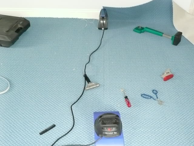

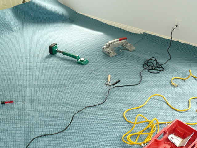

Here is a carpet small pattern. The smaller the pattern the more to line up. This makes it harder for us to do. You will see the runoff. What I did was start in the middle of seam. Stretched both ways to achieve pattern .

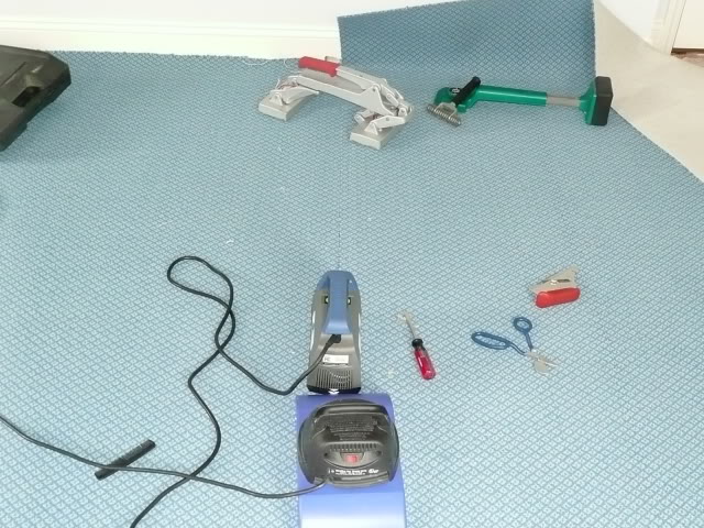

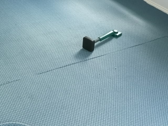

Secondly I take my Kicker and achieve a match. That will be the next picture here is the line up.

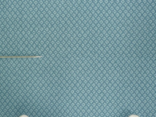

What I did was kicked it up to achieve match. As you could see the rest of the seam is not done. This is how we spot weld it could be anywhere I was lucky enough the pattern was pretty good after I kicked it.

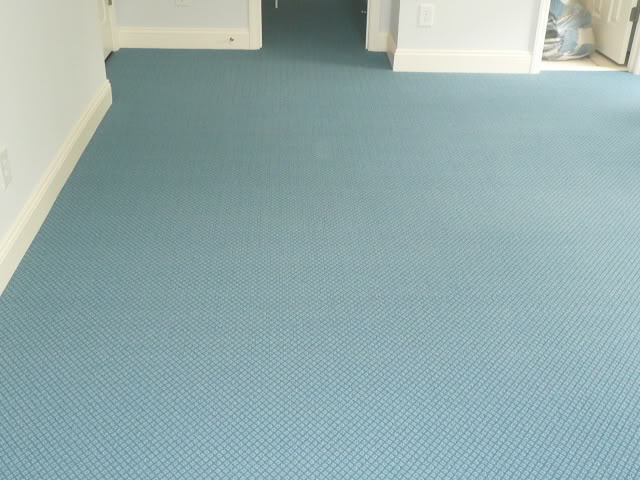

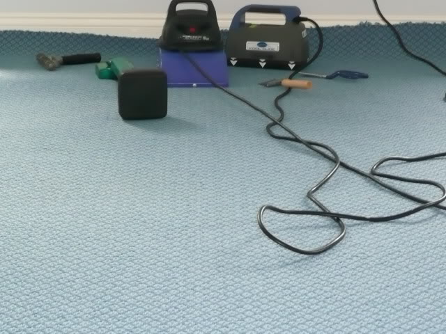

Now I tweak it with the pattern stretcher . I am also where I started the seam.

As you could see the seam on this end is done. You see the Kool glide, pattern strecher and Seamer Down Now.

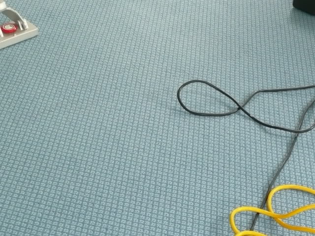

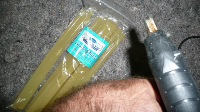

Here is another run off. Spot welding needed. I am showing the kool glide sticks along with the orcon Peak Buster . Sometimes like on friezes or some pile carpet s, I like this tip better. You seal both edges it is neater.

I am sealing 1 side and the same wil be for the other edge. Both edges get sealed.

By the size of the bubble you can determine the run off. It was a 1 full circle which is about 1 inch.

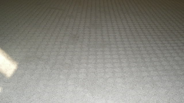

The other side of the run off.
If you notice I made some line to match my product . If the lines are off so is my workmanship.
