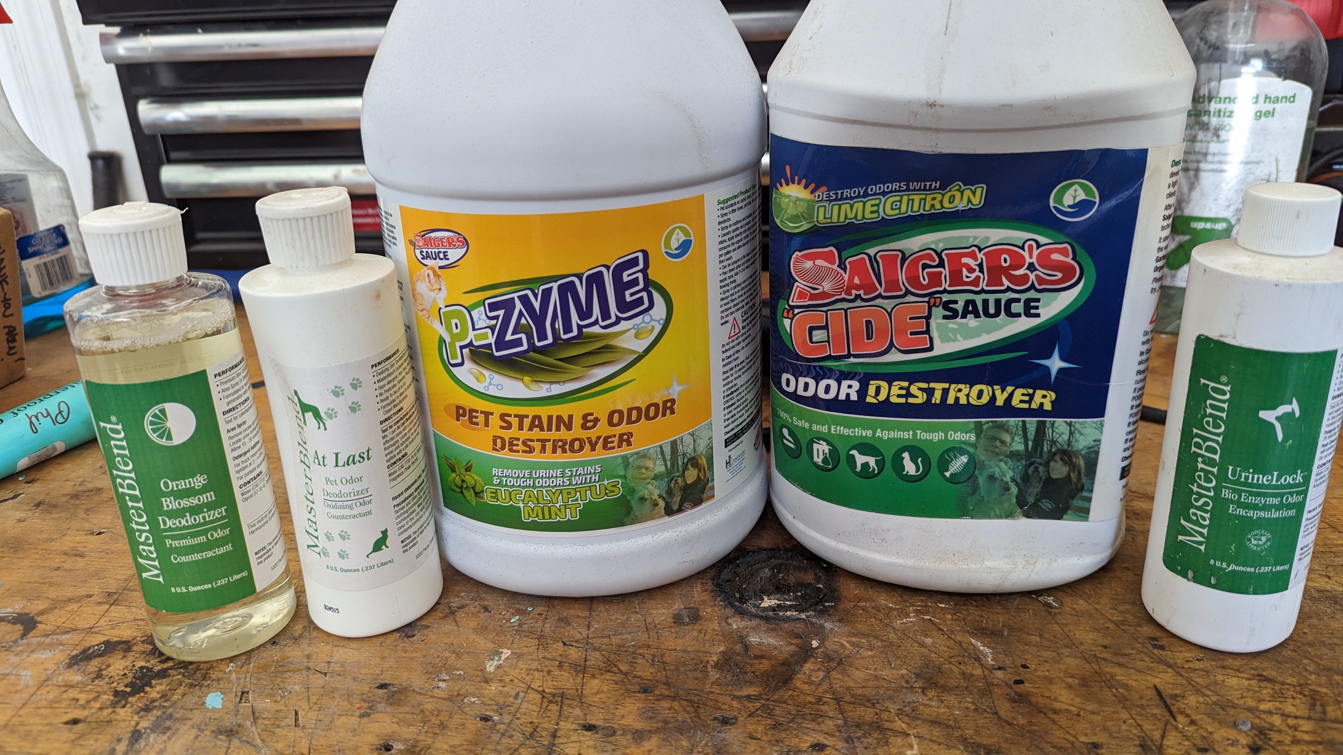

Smoke on a skunk job. The cherry was so strong, they were wishing to have the skunk smell back.I know there are some skunk specific products, that I don't have any on hand, and I have no time to get any ordered, so in your experience will any of these products work....
thats a pretty full on deo, I've only used it once on a pet job and had same experience as youI once used a cherry deodorant from un
The project is tomorrow, so thanks.I'm sure you've done something, but if not:
1 quart 3% hydrogen peroxide
1 tablespoon of baking soda
1 drop of dish detergent
Works on contact.
If you have any chlorine dioxide stuff in your free loot, that works too.
