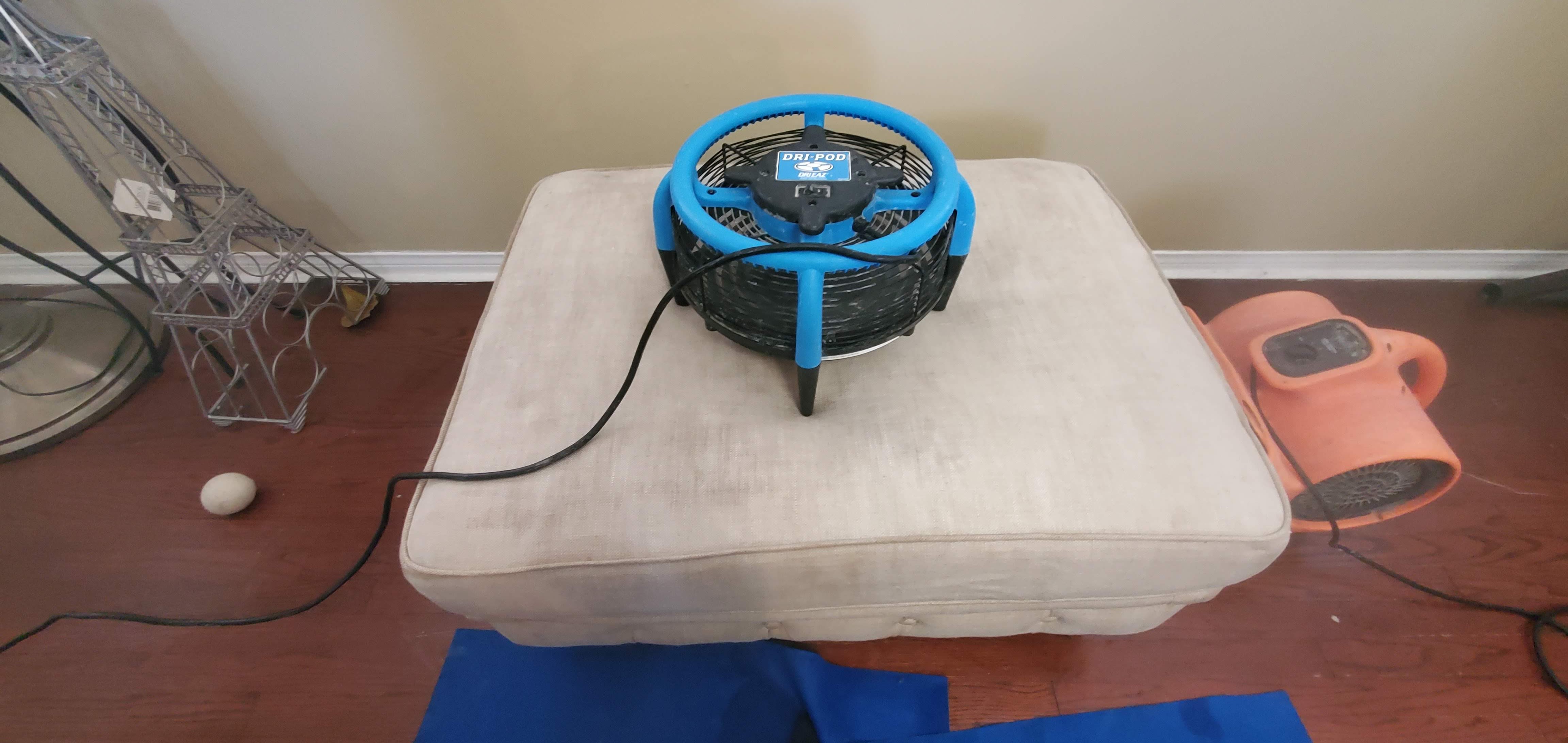

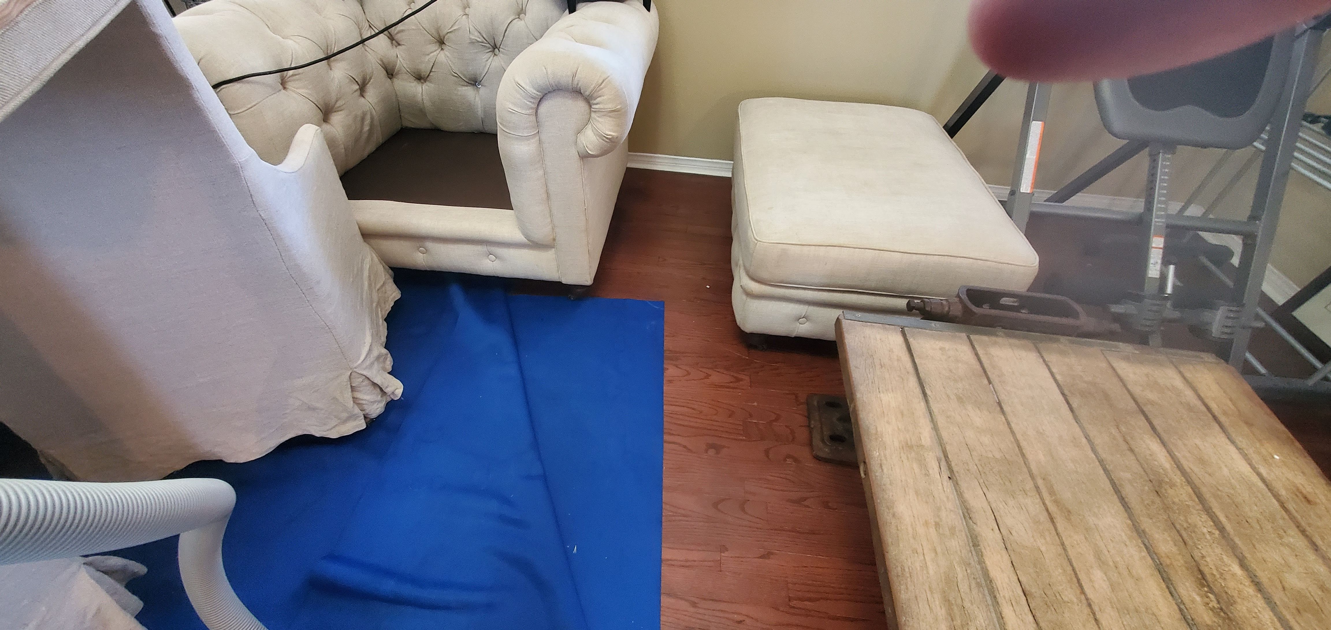

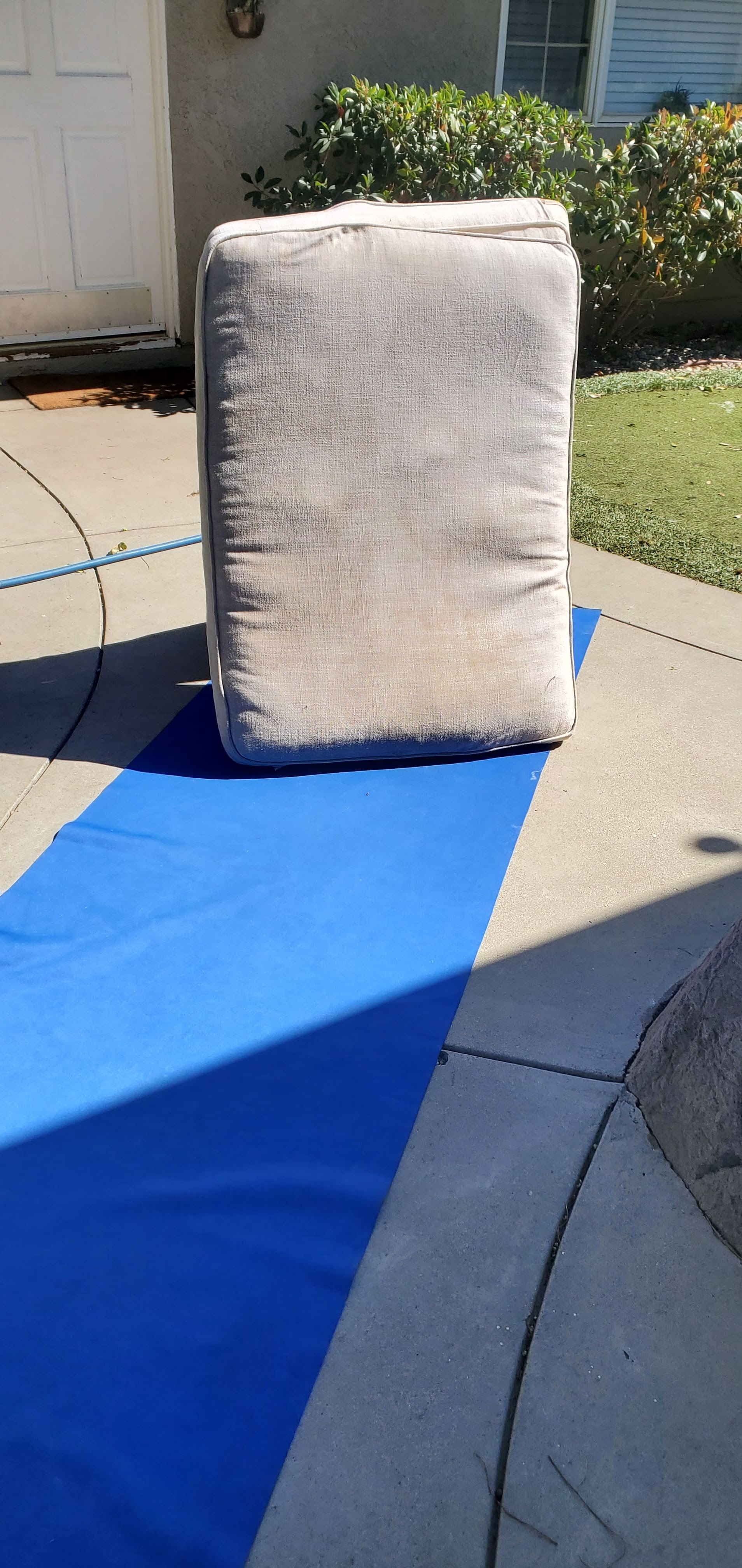

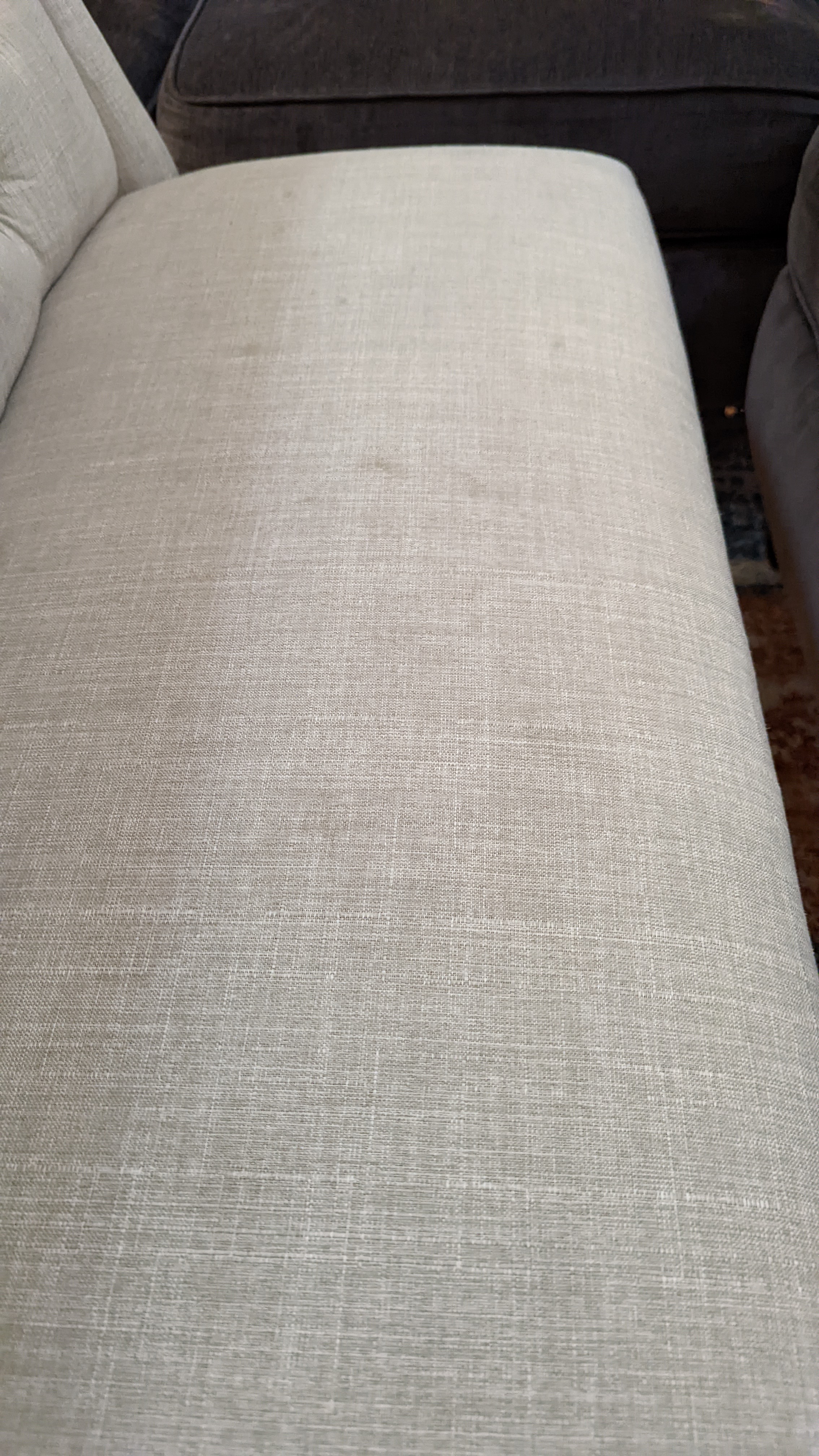

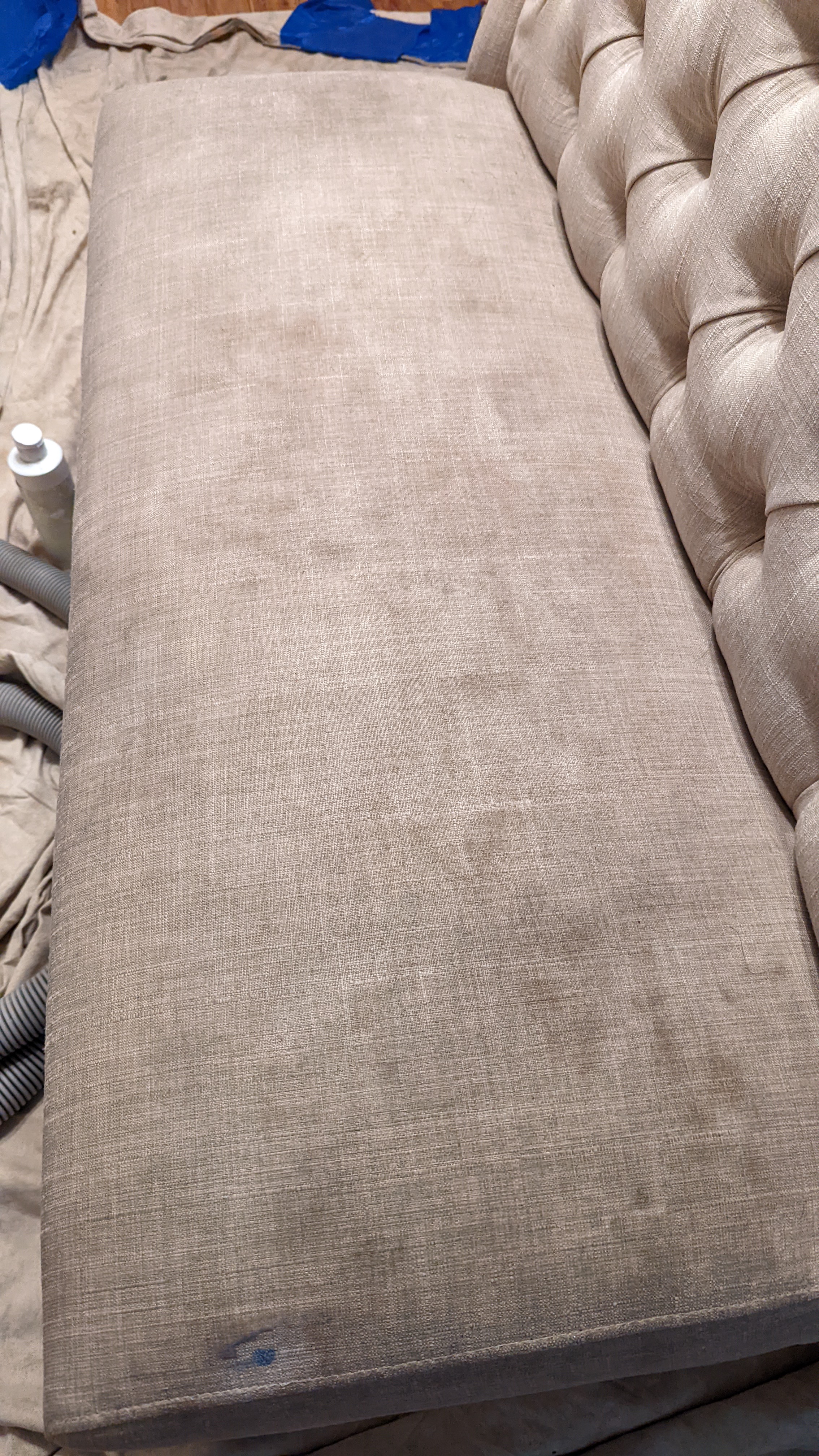

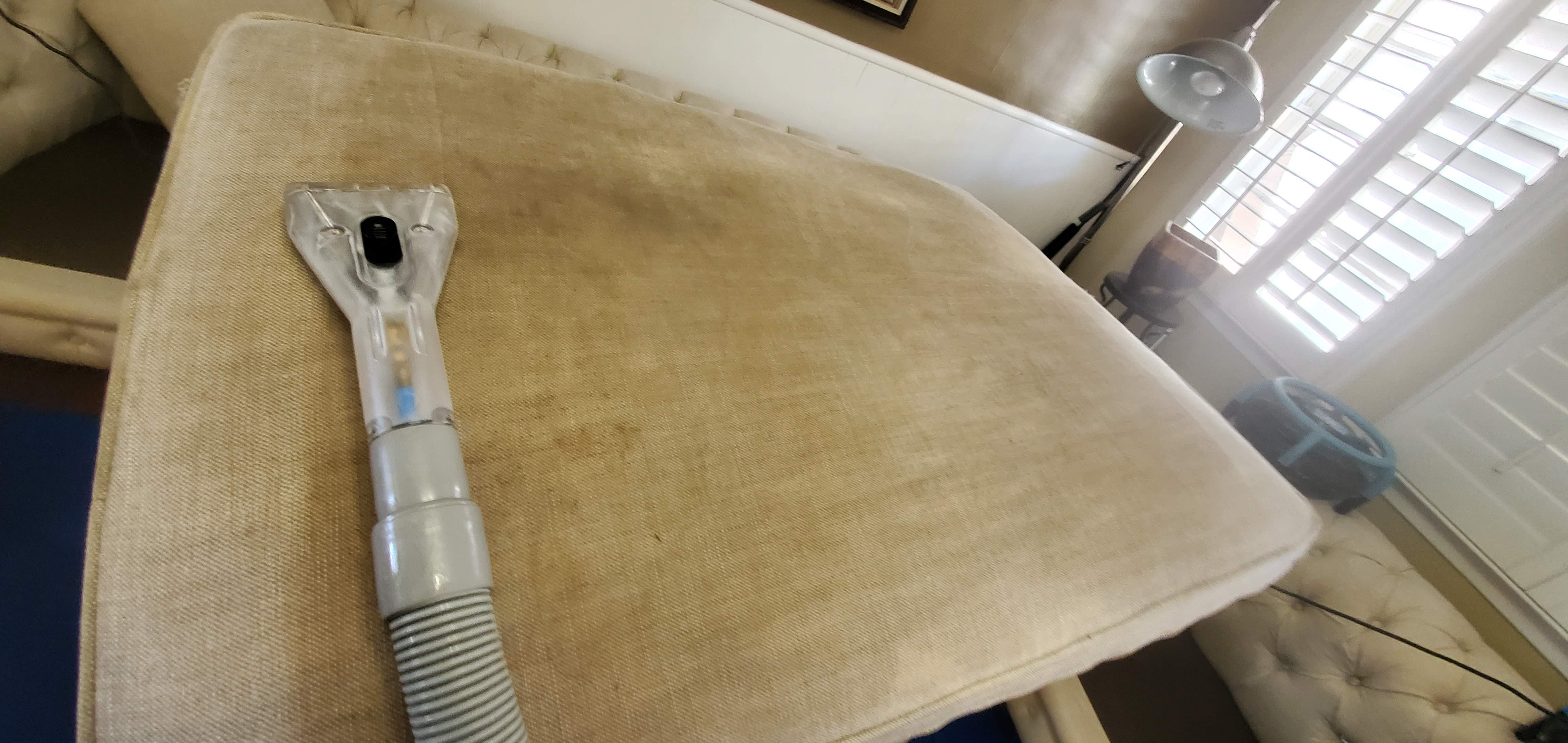

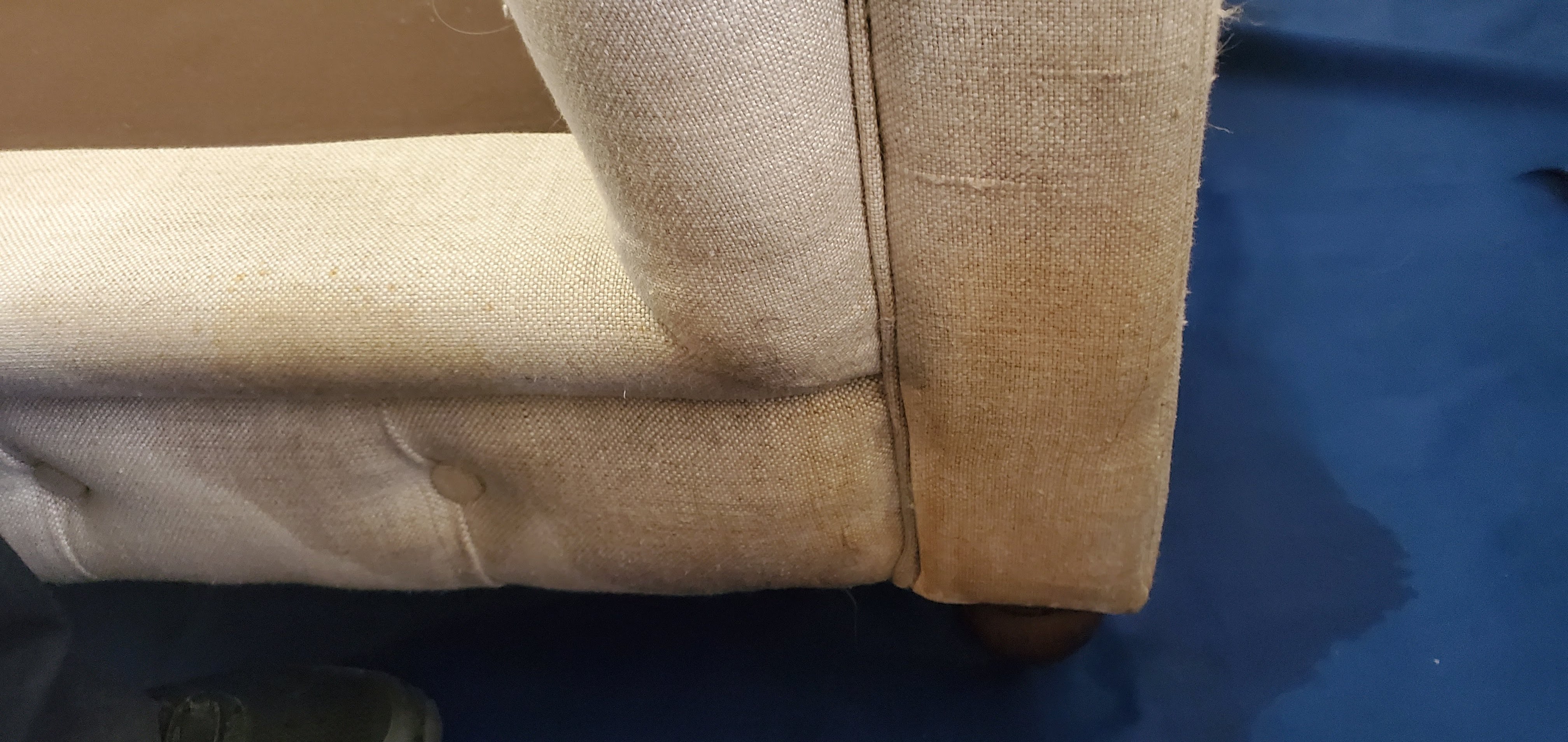

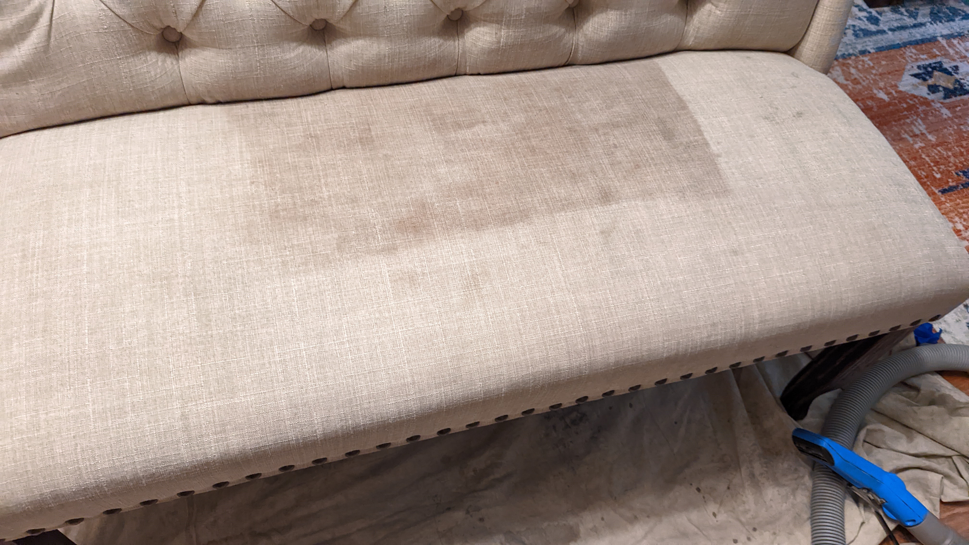

11,487
I warned the guy, pissed on all the frames and the dogs use it as a bed.
Thought it looked bitchen until it didn't.
3 seat cushions streaked.
He was an ex cleaner and swore he was replacing it just do.your best.
I got the pee stains off frames came out great.
I told him throw those last cushions in the washer with oxydol. And put them back on the foam to dry.
