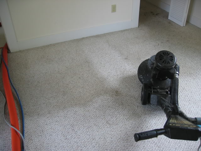

Someone got a pic of a real Counter Rotating Brush machine for George, I think he missed that little detail, they really are cool machines, and self clean the hair from the brush as you go.

I need to get my RX 20 running for some big commercial accounts. I am killing myself wanding these 10-20K sq. ft. monsters. Most my Saturdays booked out for a while....
I am going to see about just getting a new head. I priced parts at $500.00 to get it running straight plus glides for $200.00, or just a new glided head for $1000.00. Prolly just get the new head.
If I am running a greenhorn at 12 flow (4 #3 jets) what should I jet my glided RX at?
