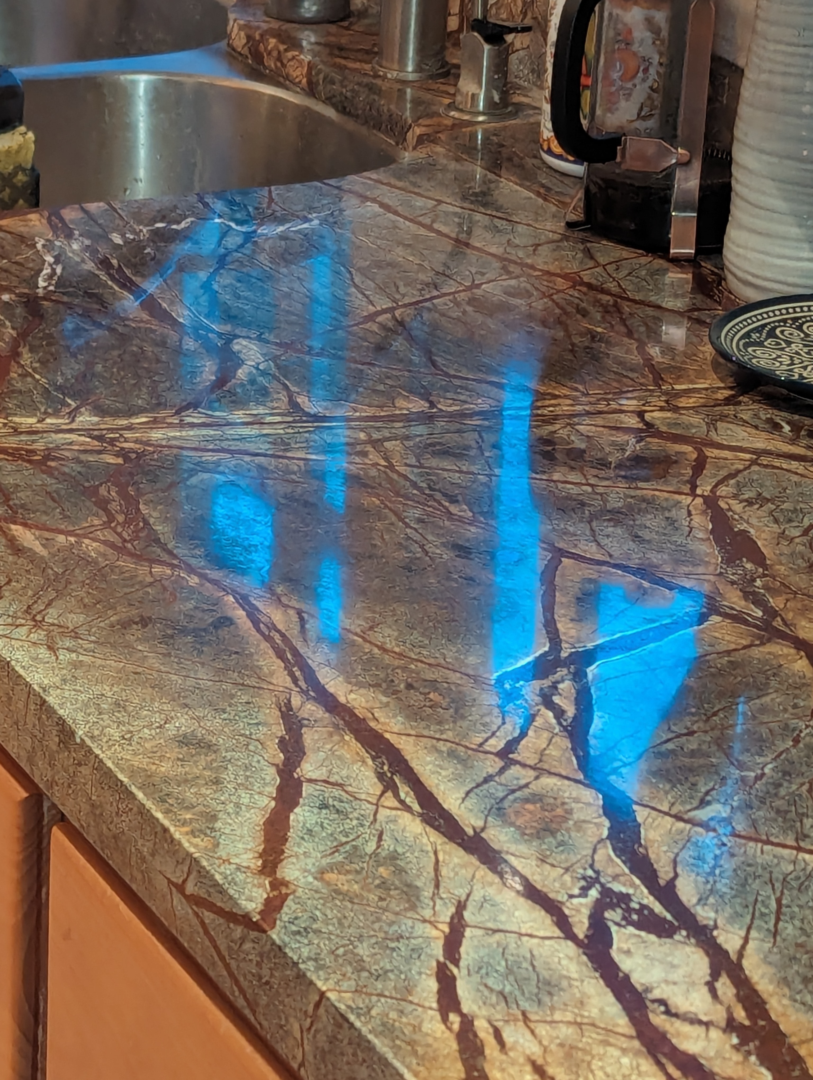

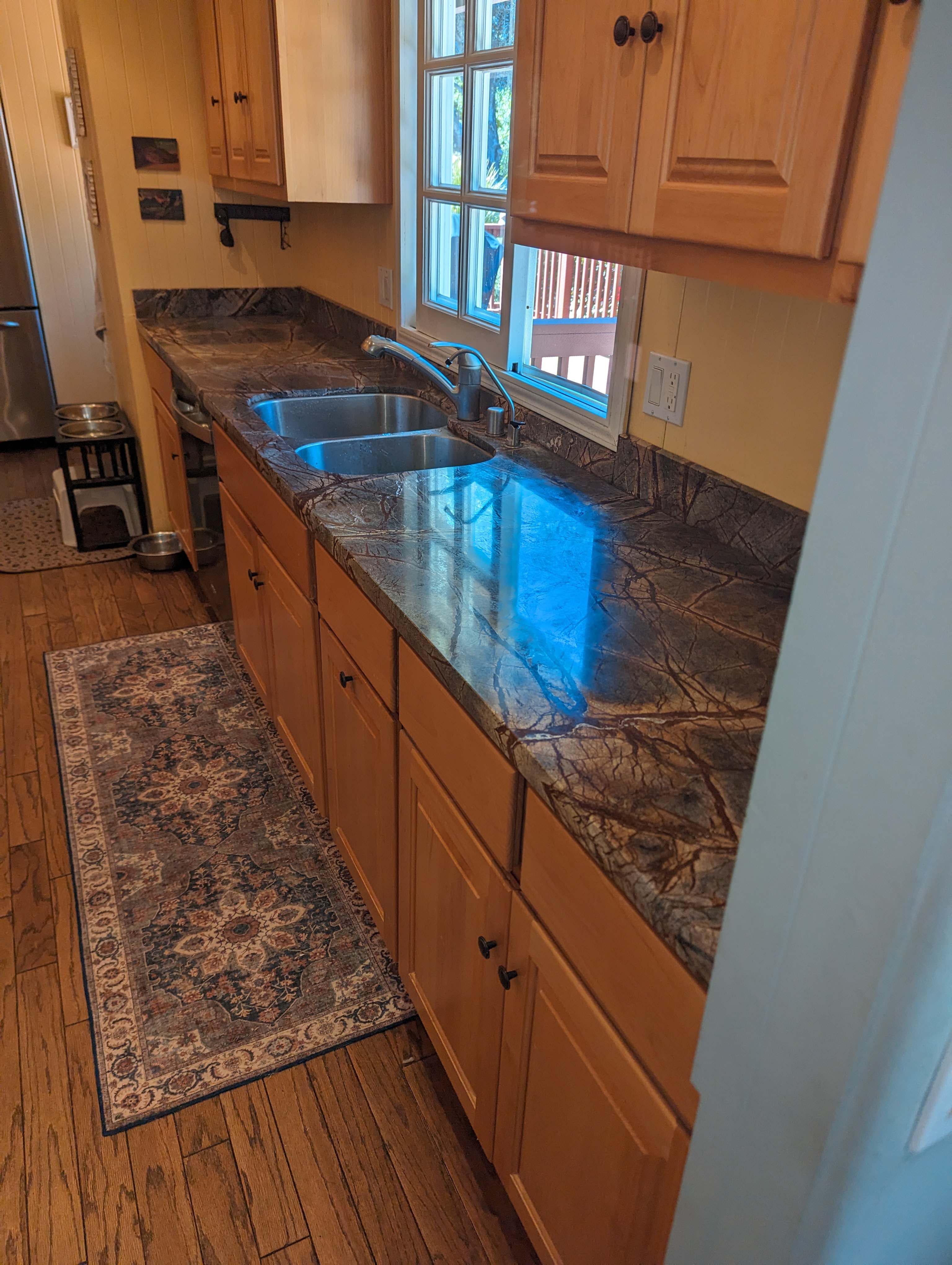

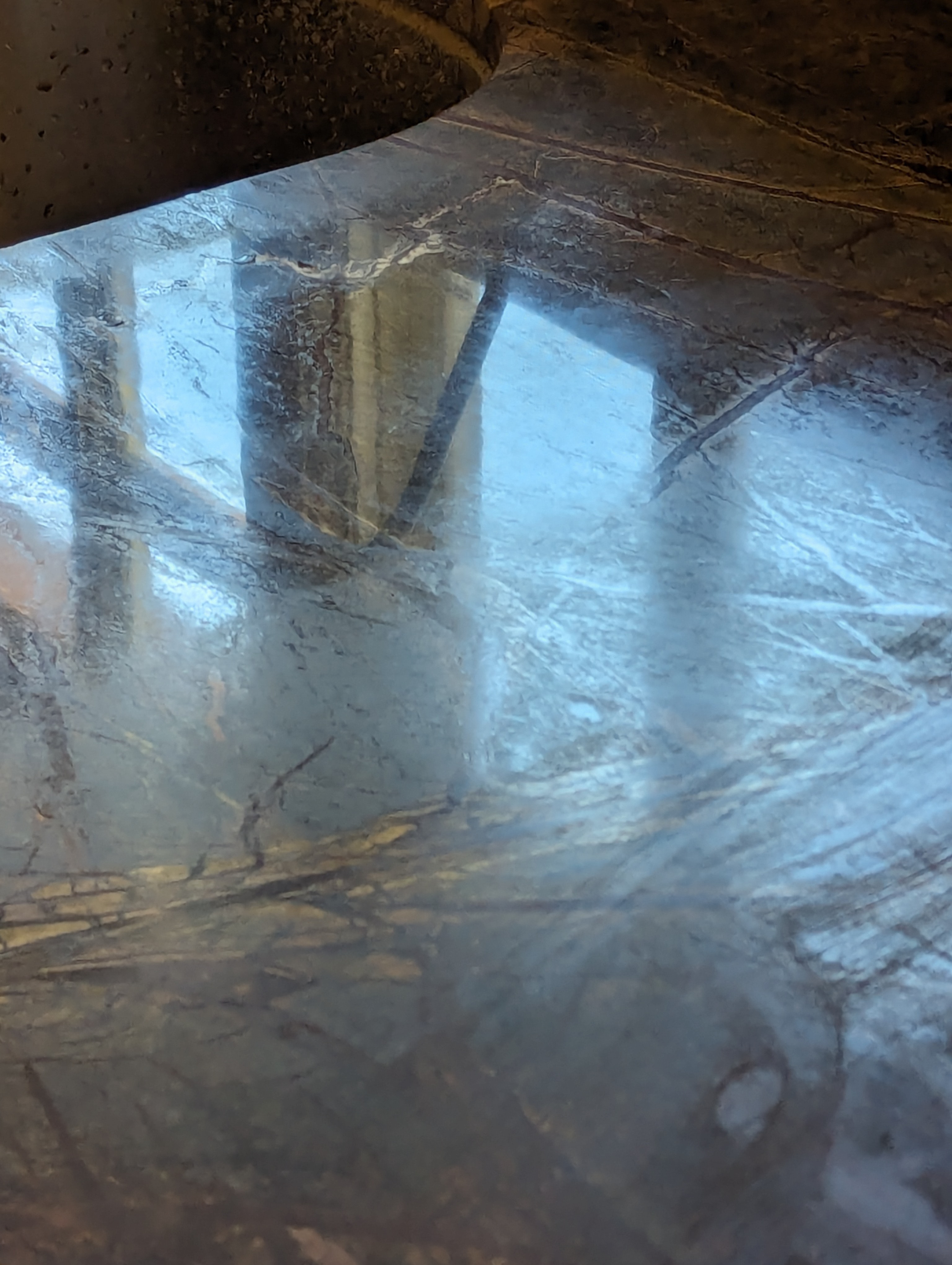

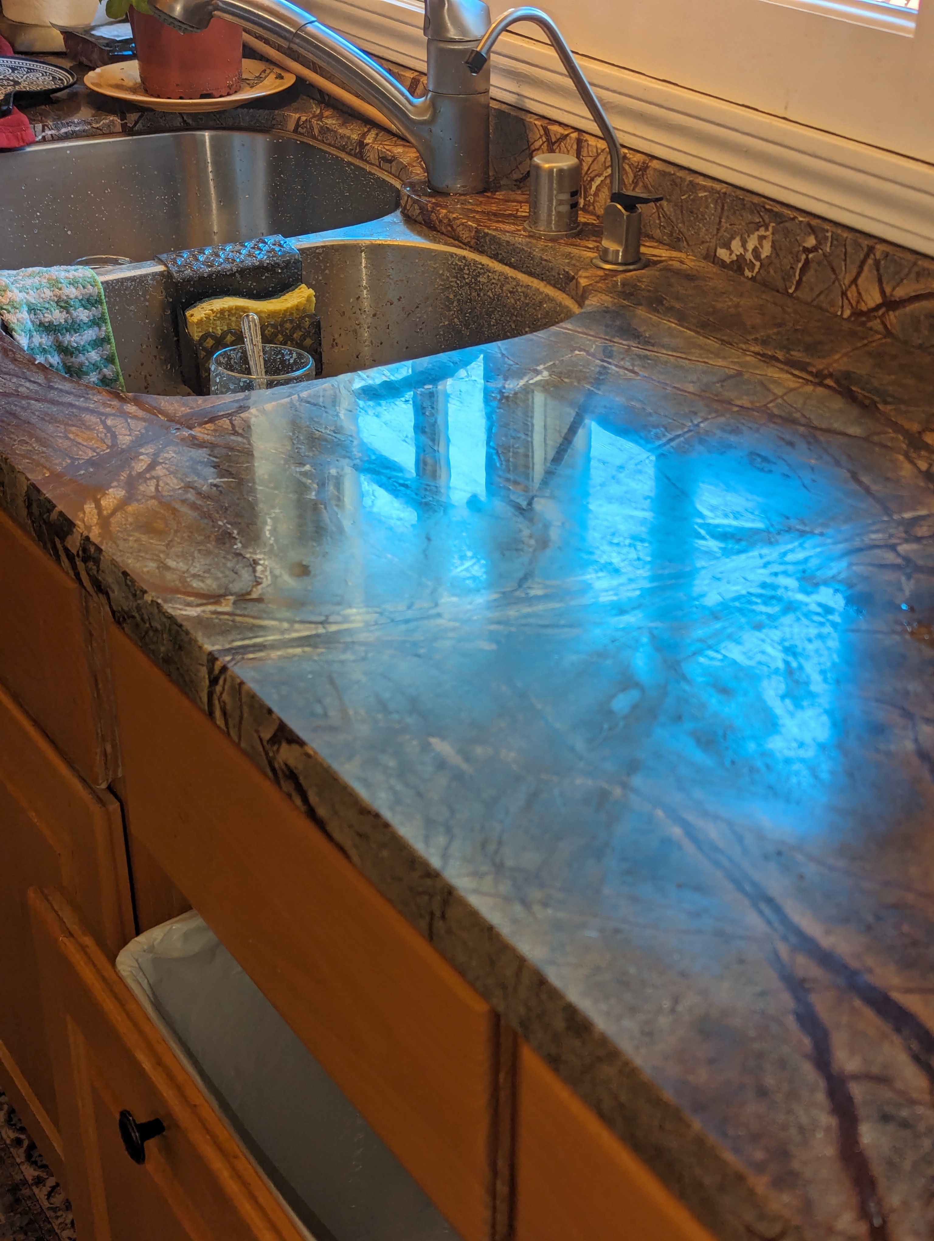

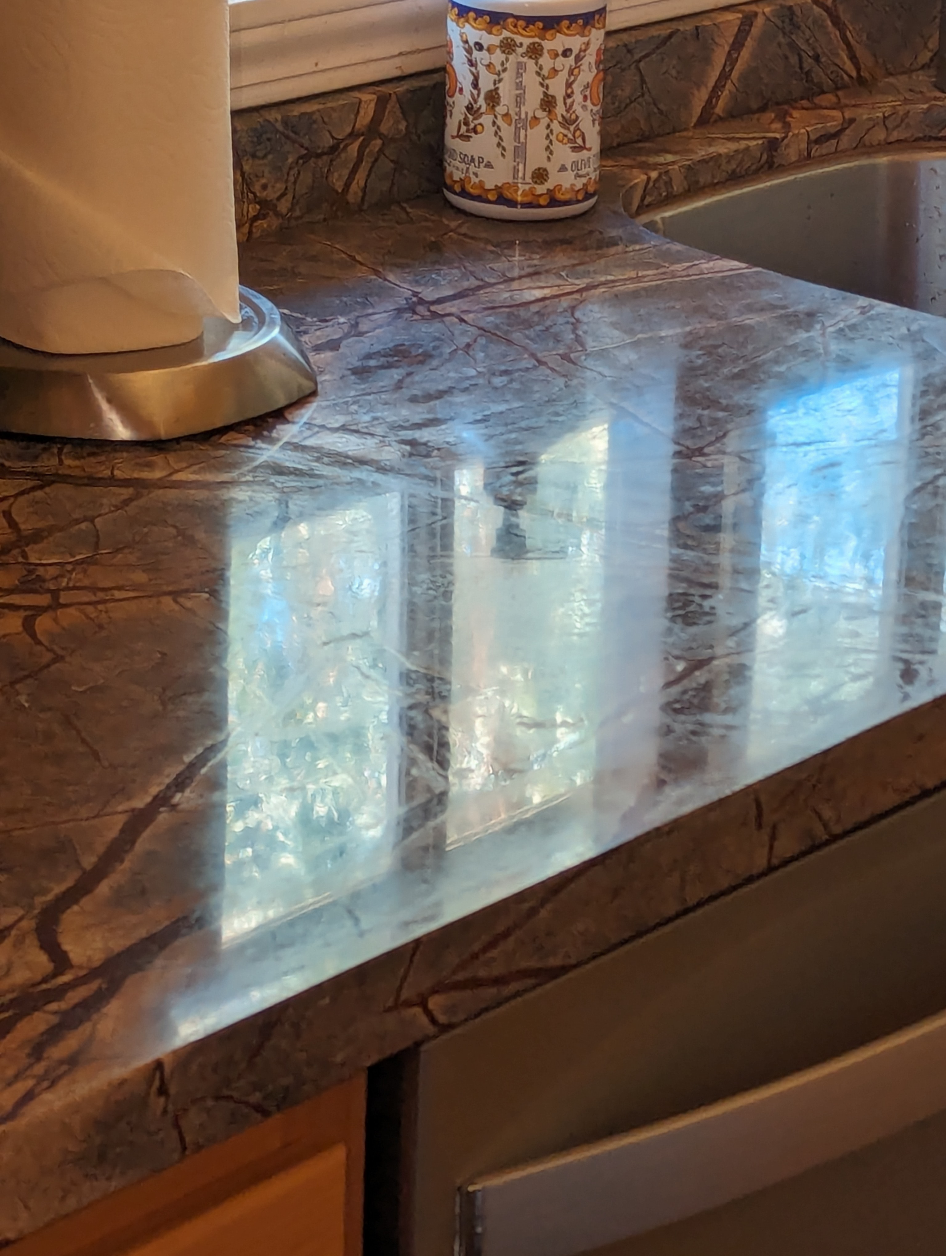

These countertops where I live, I tried polishing them a while back look like crap.
So I ran 400 diamond 800 and 1800 over it.
You can see the before in after demo in the last two pics.
Sealed with super sealer.
I'm stoked they look so much better.

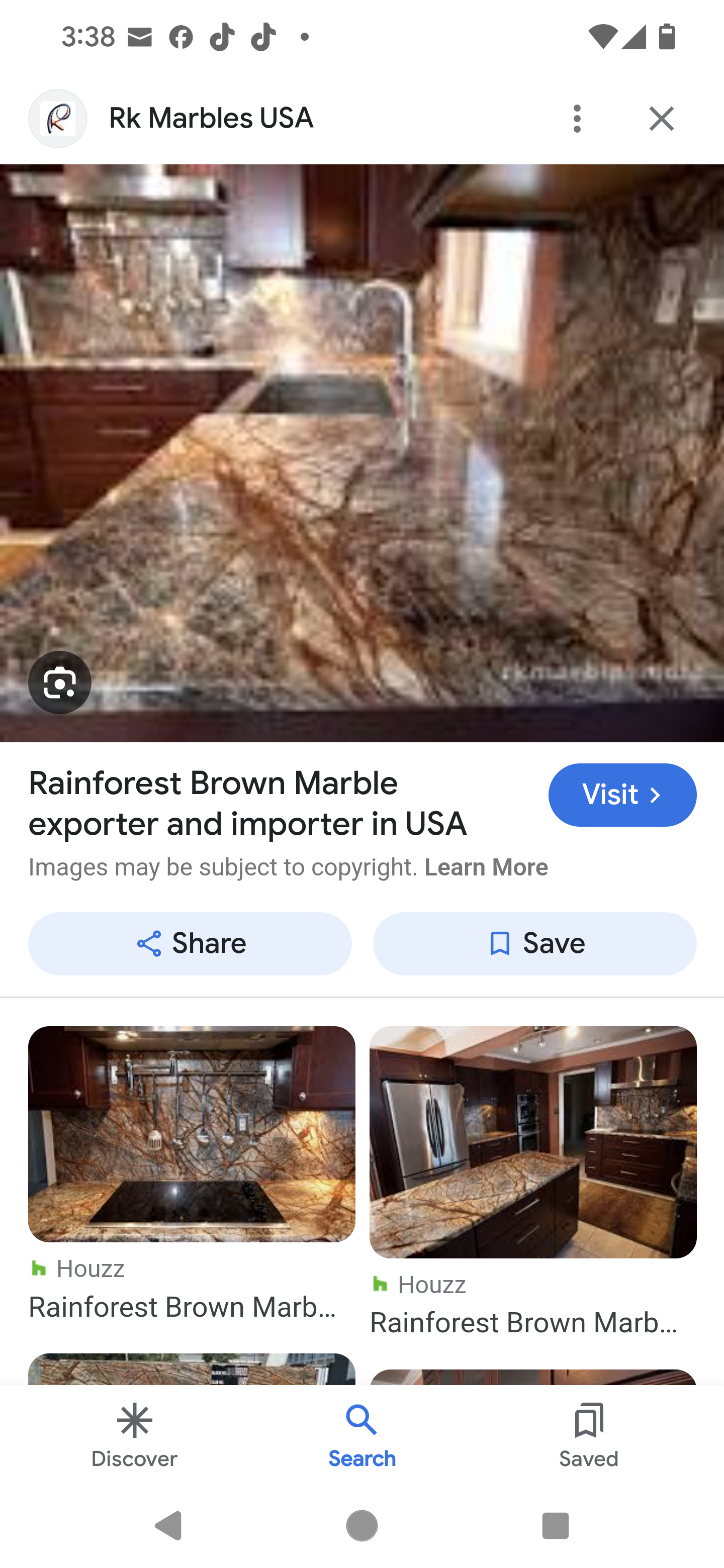

Rainforest Green Serpentine
Technically not a Marble, but is acid etch-able...
