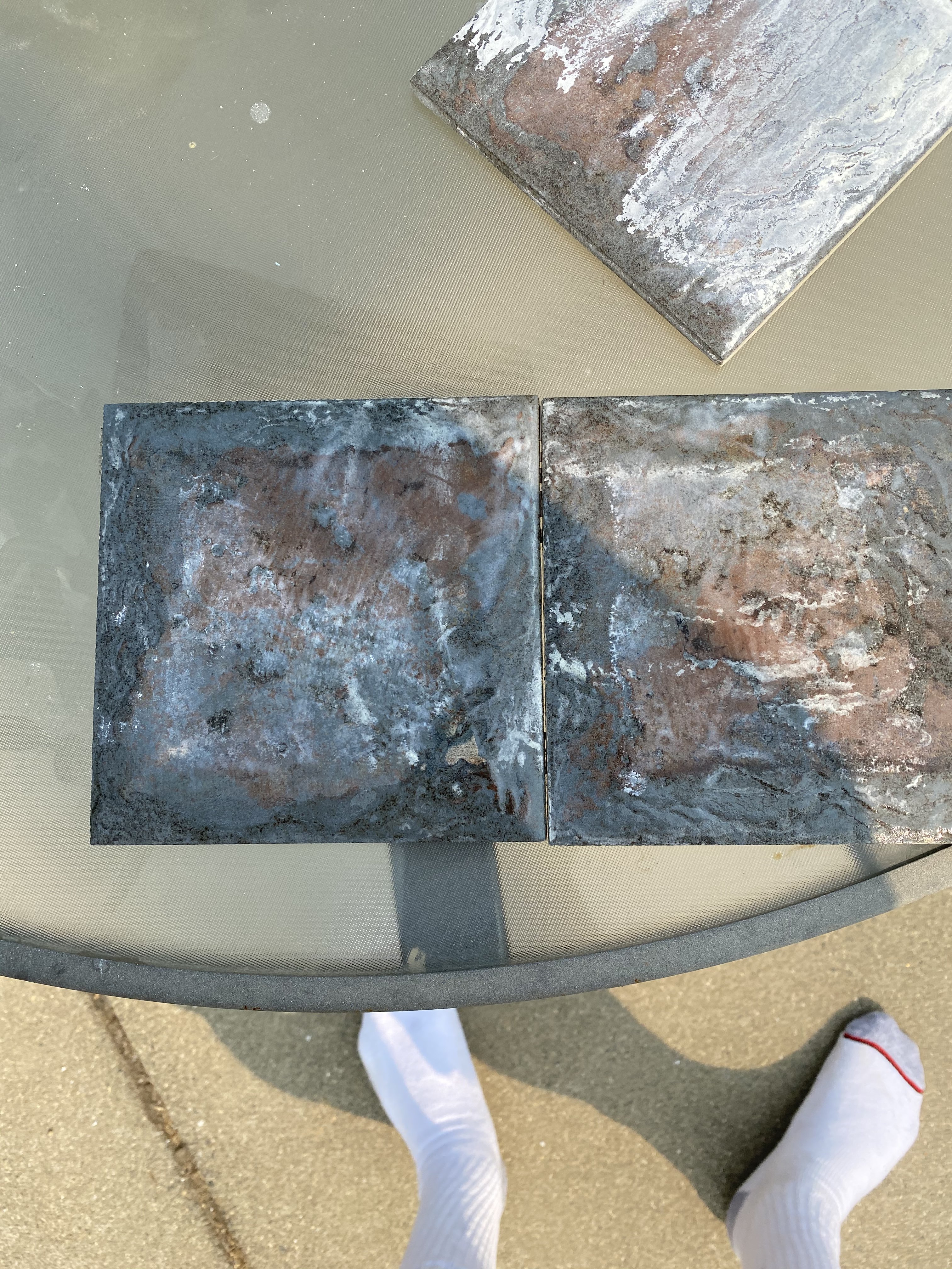

Today I’m repairing my pool. Some tiles under the waterfall came off. Before I put them back, how do I clean them up? Soak in muriatic acid?

dont know what strength your muriatic (pool acid) is, I do use it as last resort occasionally but RESPECT it

They’re getting better but not perfect yet. I soaked the tiles overnight in the acid. It ate through a bit of the deposits but not all. I’ll soak them in CLR next.
What I’ve learned so far. Muriatic acid is some nasty stuff. Wear breathing and skin protection. Also I learned this stuff is great for releasing grout. It made all the grout turn into sand and just fall apart off the tile. So, if you guys have a job with porcelain tile with grout haze everywhere, clean it with muriatic acid. Wear protection and ventilation is a must.

They’re getting better but not perfect yet. I soaked the tiles overnight in the acid. It ate through a lit of the deposits but not all. Ill soak them in CLR next.
I’m diggin the socks homie
Isnt CLR just sulphamic (sp?) acid? How strong did you mix your MA? Maybe mix lil bit stronger

thats how I first learned to do it, had a large area covered in haze
spoke to an old school tile installer, he came and looked at it and sorted the whole floor in time it took me to do a fraction
