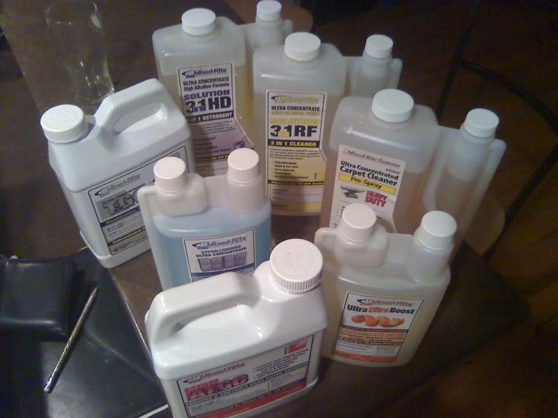

I'm a bit surprised that a rinse/emulsifier was not in the package.
two different heavy duty presprays, a neutral pre spray, a deLimeO booste,r baby blue spotter, a tile cleaner and a soap scum remover.
Maybe we could get a run down on the virtues of each product here....

I used the 3in1 HD on a white olefin rental mess and a nylon resi yesterday.
Worked great, rinsed free and smelled lovely.
but the bong burns did not come out that Ultra Mint would have gotten.

I've tried the high alkaline on 2 places. Niether were rat nasty or anything but it cleaned up well. I didn't use the neutral cause the carpet in both were not of concern for stain protection. I used end-zone to rinse both and the carpet did look brighter.
Only time will tell with this stuff. It will probably take me a few weeks to see if I really like it or not. Anyway so far no complaints.

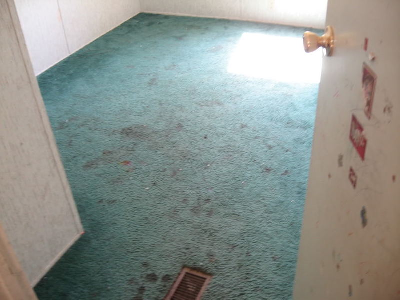

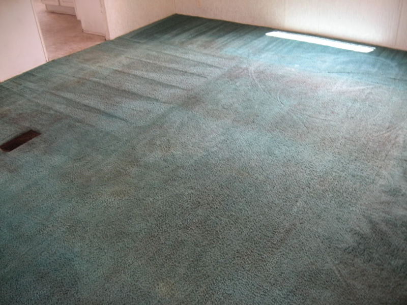

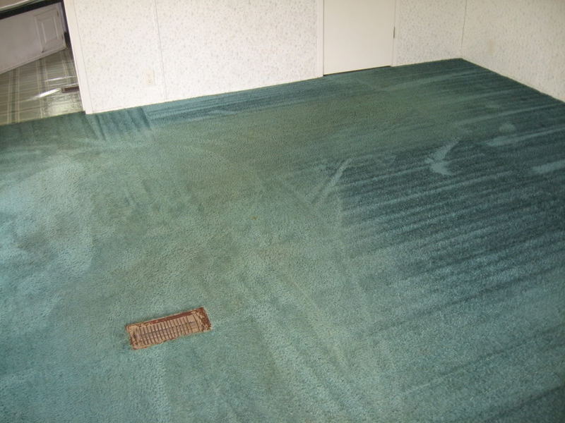

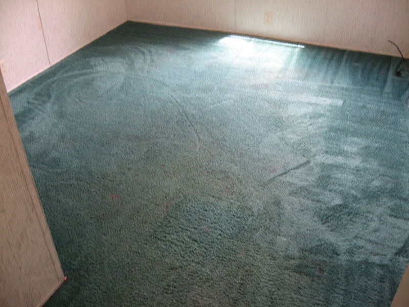

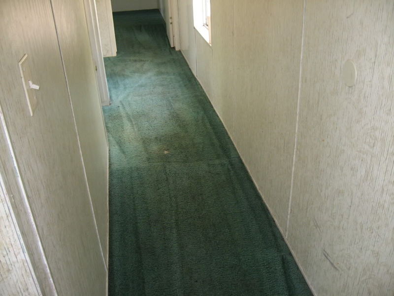

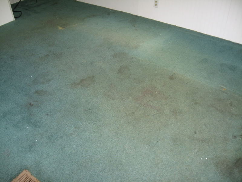

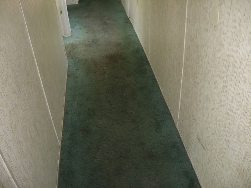

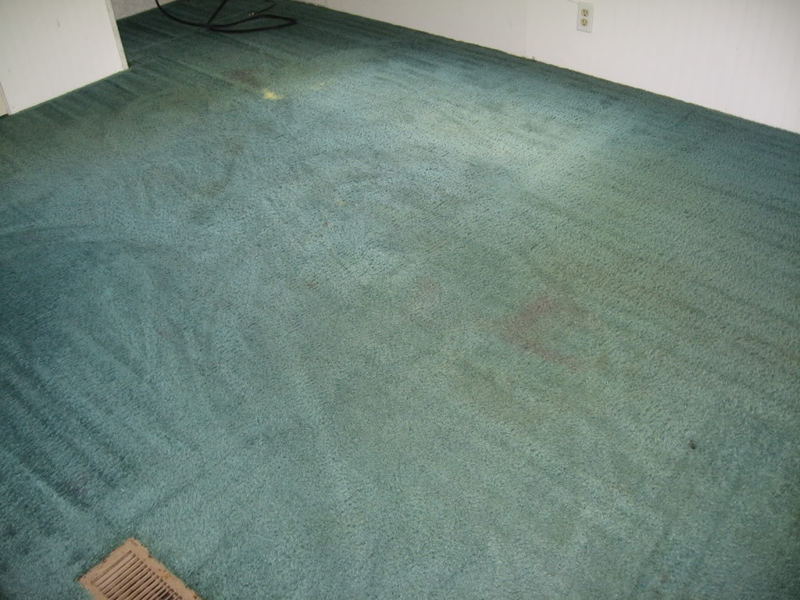

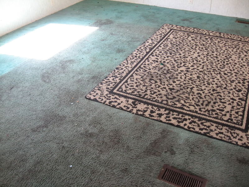

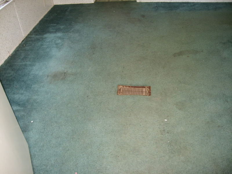

I got a call to do a rat nasty move out trailer today. I tested out the mixed right high alkaline 10.5ph stuff. I don't think it's quite strong enough for this kind of work but it does ok. I give it an 8 out of 10 for trashed rentals. I don't know if it would be good for restaurants unless they were nylon and not filthy. I'd say it's a mid strength cleaner. Powerburst probably would of done better, 12 ph was needed but the owner was happy and I did better than his previous cleaner. Took me 2 hours.

Perhaps. But its a trashed rental. People rent places like that for a few months never clean them. And move out or get evicted. Places like these just get trashed again. So cleaning them to make them livable for these kind of people is the only option that makes sense.
Also the carpet was heavily worn because it wasn't vacuumed in probably 9 months. Probably only swept with a broom.
I would of roto scrubbed this job but there was no power. I ran my vacuum off an extension cord but I wasn't gonna try running my scrubber off the extension cord.

Where's the afters?
Im sure you worked hard Tim, but I am not impressed with the results. Who knows if other cleaning products could of done any better. Some Landlords need to quit being so cheap.

I don't think it would of come much cleaner even with powerburst. New carpet will look like that in 9 months. Not everyone out there lives like civilized people. People like this live like animals, they don't know how to clean. They are most likely meth heads. And there has to be a home for everyone other wise they would be on the street. So there is a market for slum housing.
I did one about as bad a few weeks ago and and it cleaned up better with a different prespray. However it still looked like crap. And the people who moved in and bought it (it was a forclosed double wide) were very happy with the results. So who am I to argue. Both this and the other job should of been replaced in my opinion.

Tim you need to use more prespray, add 40 vol and get way more aggressive with your pre scrubbing.
You do pre vac right?
Those carpets should have been replaced but you could have done WAY better.

I couldn't roto scrub this bad boy like I said no power.
As far as chems I mixed accordingly to the bottle, probably 8-10 oz of the stuff. I sprayed down the whole place very heavy and gave it plenty of dwell time to make up for no rotoscrubbing. And I had maybe an inch left in my HF with a yellow tip on it. So I nuked the hell out of it. I put 3 cups of point blue as my rinse and rinsed at like 5-6 to nuke this place. It just wasn't coming clean. I'm thinking they may of done engine repair in this place....but I don't know. Peroxide may of helped but face it it's a rental and the extra effort just wasn't going to do anything for me or my customer. All he cared about was an improvement and I did that, 90% of the crap was gone and he was happy.
I also love how people say they can do better just by looking at a picture. I even went over many of the areas 2 times with prespray and many many passes with the wand. It just comes to a point where it's not worth it. I'm also beginning to think many of you guys have never cleaned filthy carpet, not everything will come completely clean. And if I was getting 50 cents a ft I may could of done a mikey type clean, but rentals you clean as quickly and cheaply as possible and spot cleaning is not even in the cards.

How about a rake?
Brushing can do wonders, especially compared to just dwell time
Tim, you took good pictures bud. In my 23 years of sucking filth I have seen that exact home many times. I know I could have done better.
But who cares its all about the pay check right?
at the very least you could have groomed it.
