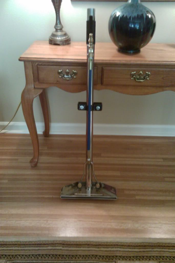

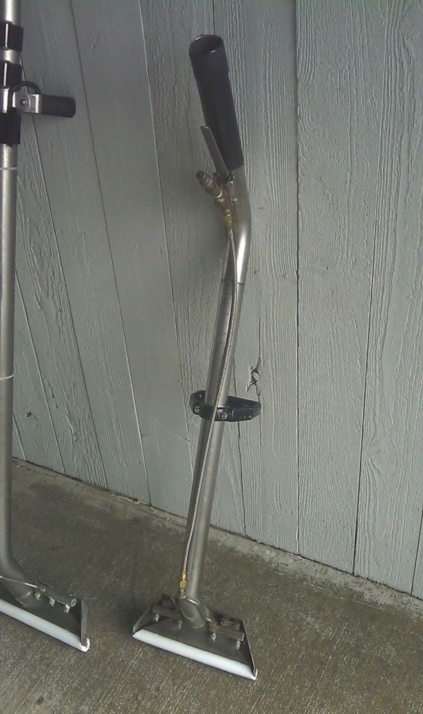

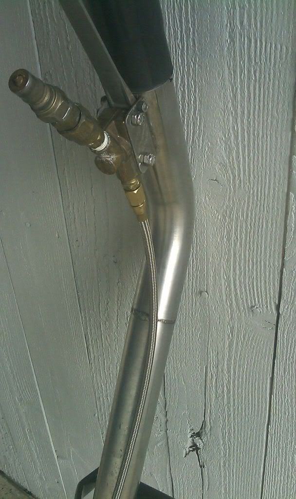

I took my Prochem quad jet wand and cut off 14 inches and re-welded it to make a custom stair tool. I'm just a tad over 6ft tall and 14 inches seemed to be the perfect amount to remove. It is heavier than normal stair tools but once you get use to it, it works awesome! I can clean stairs faster than before and not have the fatigue I had before when using my titanium wand. (How many people use their regular cleaning wand for stairs anyway?)

I thought about doing that, but I didn't want to cut up a 700 dollar wand. I purchased my first stair tool ever today and used it on a job. I really like it. It is just the right length that I can clean the steps without bending over and landings are easily done. The tool is 36 inches and has a 1200 psi valve so cleaning at 400 will not be a problem. I thought the price was fair at 145. I still plan on using my 4 jet wand, but it will be nice to have a smaller tool for tight areas. The flow is 4 which I thought would be too low, but it seems to be fine. Eventually I may go up to 6.
