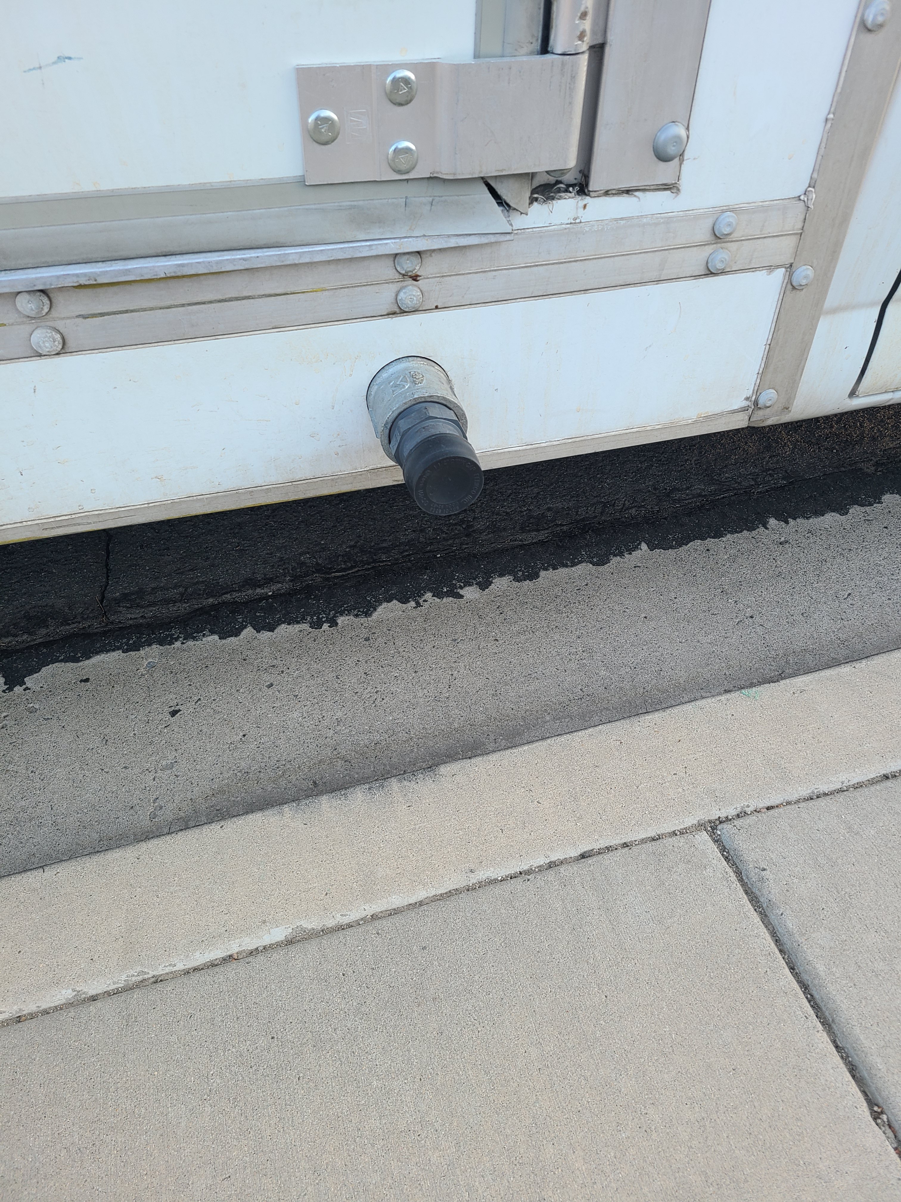

I am thinking Bout mounting stuff under the van .on my current box truck I have my dump line ran through the floor and mounted to the bottom so I don't get spillage in my truck supper nice to have will post pic in a sec .I am open to what it takes to do it right i will look into it for sure .
