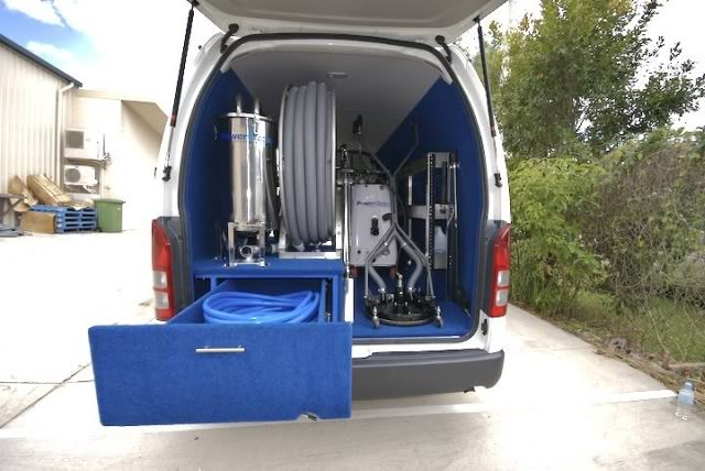

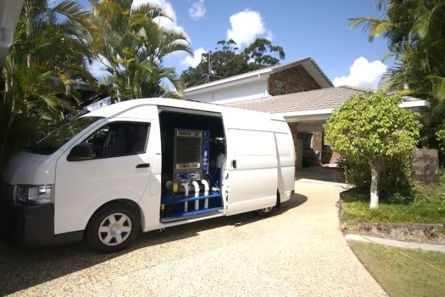

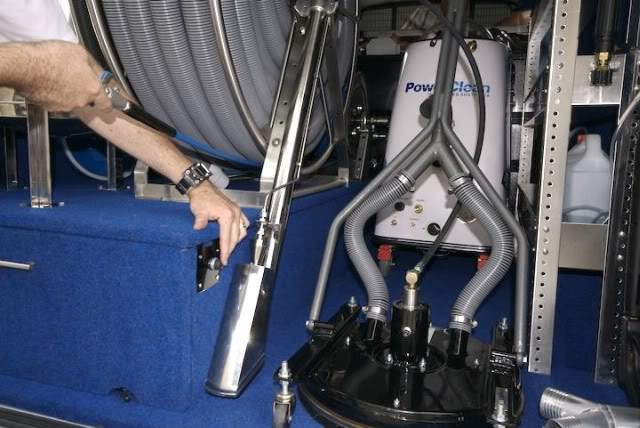

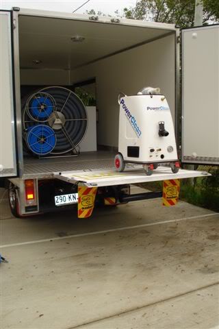

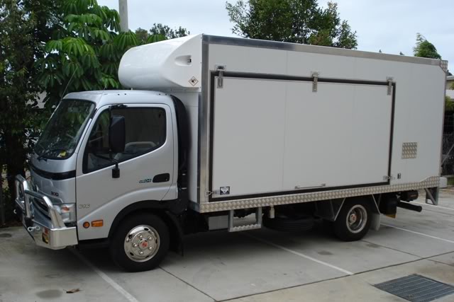

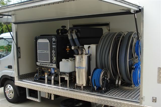

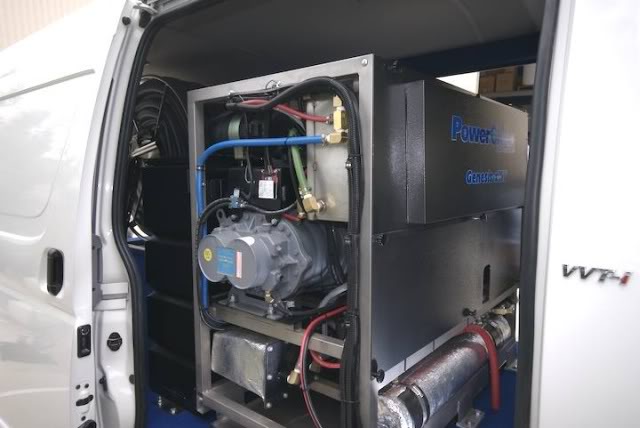

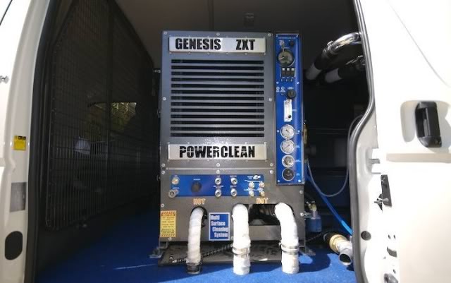

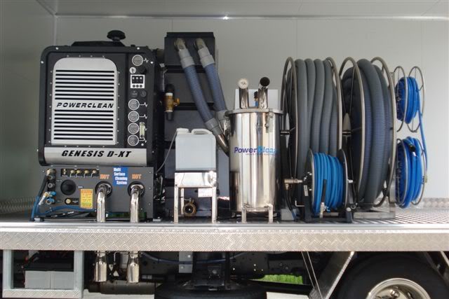

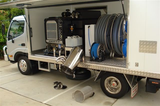

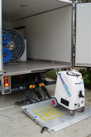

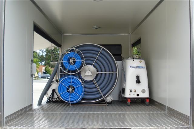

More installs as requested...
1st CLASS all the way. Our American distys SUCK in comparison. There is NO comparison. Most American truck mounted vans would be condemned if they we're houses by the government.
PURE, PURE QUALITY!!!!!!!!!!!!!!!!!!!!!!!!!!!!!!!!!!!!!!!!!!!!!!!!!!!!!!!!!!!!!!!!!!!!!!!

Those look terrific! If I had been able to get a setup like that when I was purchasing from Powerclean I would have. That is some nice looking stuff.
Do you know if those of use with a couple year old Genesis can get that new "larger" waste tank? It appears to be the same width from what I can see, but it is taller.

That really is amazing. I am quite impressed. I love the look of all that stainless.
Why can't we get that in America?

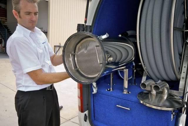

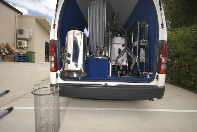

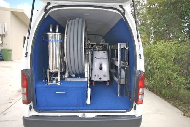

Very nice installs on both trucks. I like the idea of using more Stainless.
I think that since the equipment costs more over there, that it is installed and maintained at a higher level.

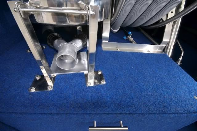

I like the tilt-out feature on your inline filter. What was the cost of just the filter?
We had a line of NSS tank vacs that emptied the same way and customers liked that feature.

The only thing I don't like about the filter, is how HIGH up the vacuum connections are, I see that being a problem. Other than that, I want an external filter badly.

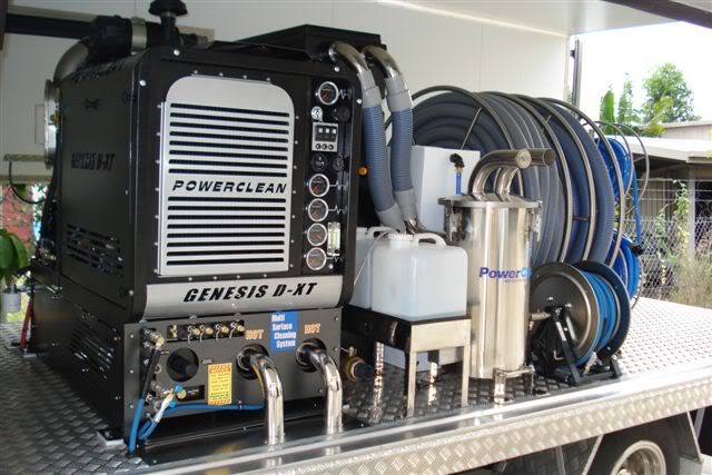

Thanks Larry. I think you are right about the expense.
For instance, in some of our other installs, you may have seen a custom 300 gallon water tank fabricated out of Stainless Steel. It is nothing special, just a rectangle tank with bungs for in and out taps, and 3 baffles on the inside. The cheapest we can get a metal shop to manufacture one of these for us, is around the $3,000 mark over here.
Everything is more expensive. That truck you see in the photo’s above is $45,000 by itself and the pantec cost the client another $30,000 on top of that. Everything from cars to food to petrol (we pay the equivalent of $ 6.50 per gallon) is more expensive over here. Due to the cost of things over here, I think when the cleaners do purchase nice machinery, they really do look after it because the replacement cost is so high. We put a lot of work into it to make sure that they don’t have to come back every few years to replace their equipment as well.

Fred Homan said:
Would Powerclean sell that external filter by it self?
If you contact PowerClean Industries in Chicago Fred, I am sure they could answer that question. While I cannot comment 100% on their behalf, I am pretty sure that they will be manufacturing these tanks very soon.

I'll give you a quick run down of our installations starting with a new van
We then rustproof the floor
Fit marine grade ply and screw that to the floor.
Fit insulation into all of the wall cavities
Cut Zinc sheeting to size and rivet it to the cross members of the walls
Apply marine carpet to floor, walls and doors. Measure up and start fabrication the custom racking and auxiliary tanks
Before it gets completed and loaded before it rolls out of our factory...
If you have any other questions Patrick, don't hesitate to ask. :)
Jim

Here are the finished photo's of the rig that I partially posted earlier. The Stainless racking and wraps have now been completed. On board currently there is 2 dehums, Cimex, 22 air movers and still a lot of space left over. All the racking including the chemical lock box is stainless. Came up great!
Side view showing the PowerClean Diesel D-XT Genesis.
Finished off including the wrap.
Jim
