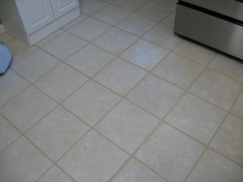

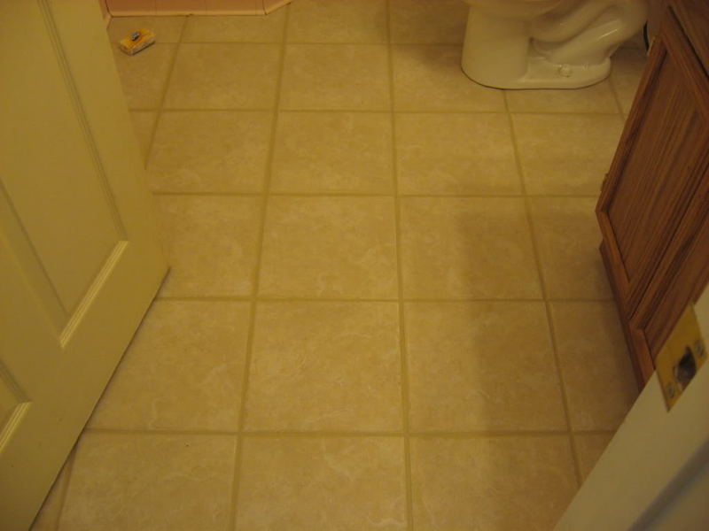

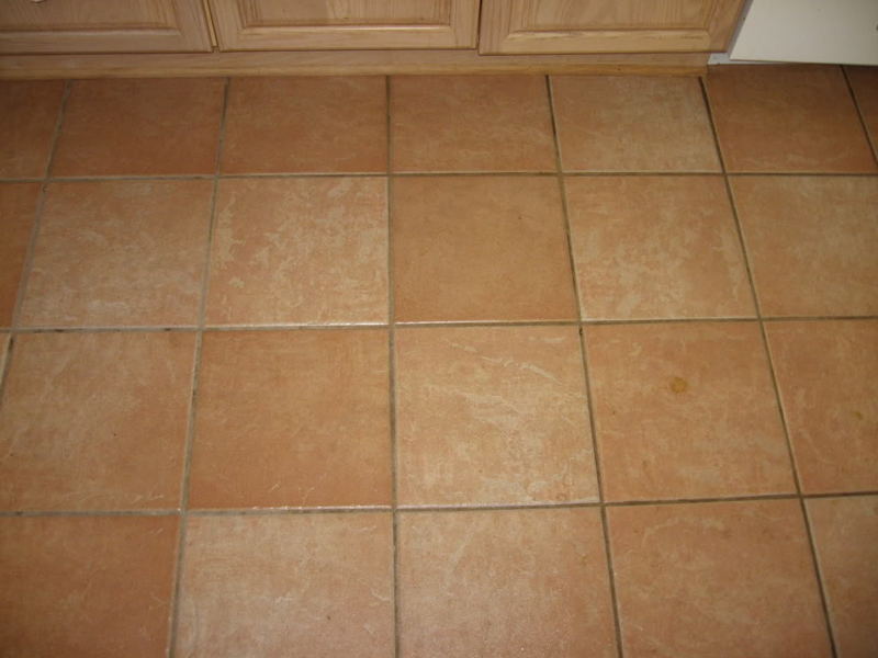

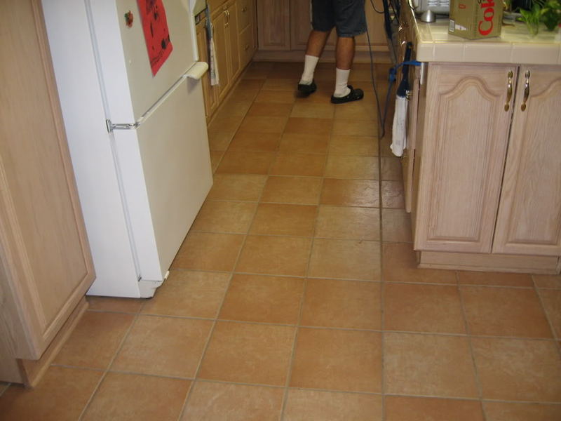

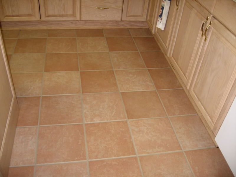

This was my first time on the floor...I did my countertop a couple of weeks ago. My wife helped me and we finished it in about 3-3.5 hours and it's aproximately 300 ft. That's with cleaning and everything. Looks good to me.
Before
up close
After
Before and a glimpse of me wearing my crocks in socks....a fashion no no???
After
Before
After
Before
After

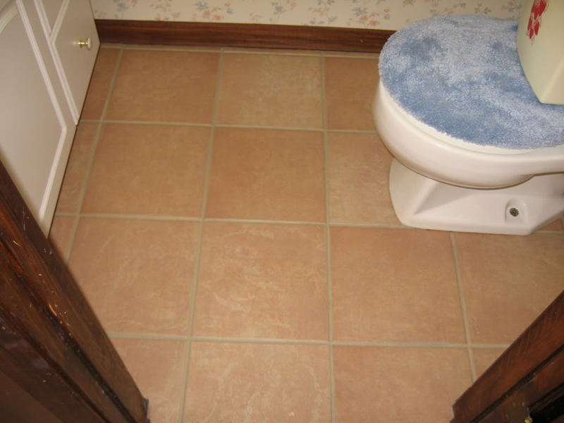

This Old Grout.....Tec color parchment.
I have one more family job to do.......but I feel comfortable doing it for pay now. It's pretty easy.

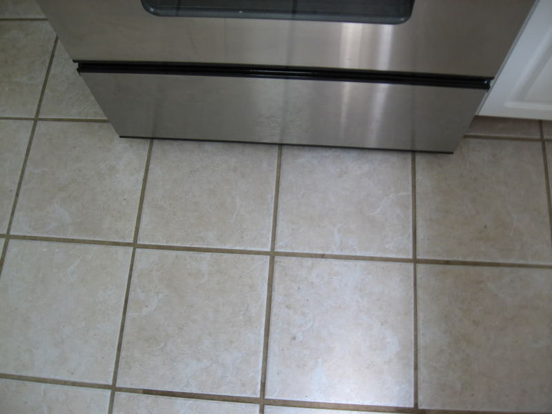

The pictures were while I was vacuuming or after is was vacuumed. I've cleaned it before and the grout is stained from oil/grease. I didn't take any pictures after cleaning. To be honest it didn't look much different but I knew it wouldn't. I just cleaned to remove any oils etc on the grout. I only did one coat of color seal....it's all you need as far as I know. We did 2 coats in the bathroom where it was grouted darker....it wasn't dirty to the point of black....actually it's a dark grey color. They started to grout the floor that color and didn't like how it looked.
As far as the edges it's not really that tough...you can wipe over the tiles...I go diaganal in both directions to get the lip of the tile. If you see a heavy spot on the edge it's best to get it cause it will be harder later. But if it's just a slight bit don't worry it blends in plus when you buff the tile with a dry towel after it dries some....it rubs off don't wait a long time cause it gets hard and you'll have to scrape it off if there is a lot. In my opinion it will come off with traffic and later cleanings if it's just a little bit. The sealer penetrates into the grout and unless you really try to wipe it off the grout you can't. And if you do wipe some off you can touch it up with the brush since there is usually plenty in the brush to touch up without it getting sealer on the edges. .

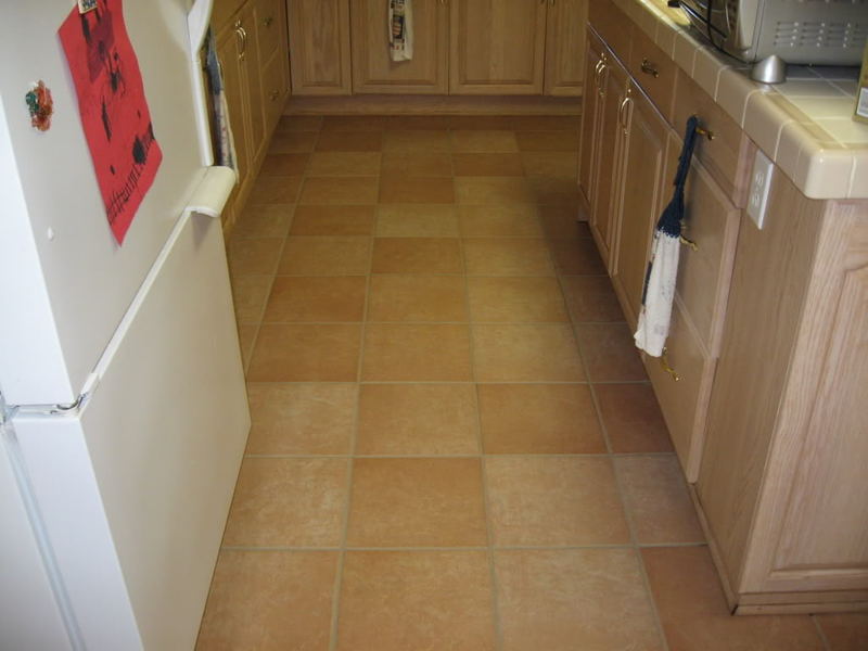

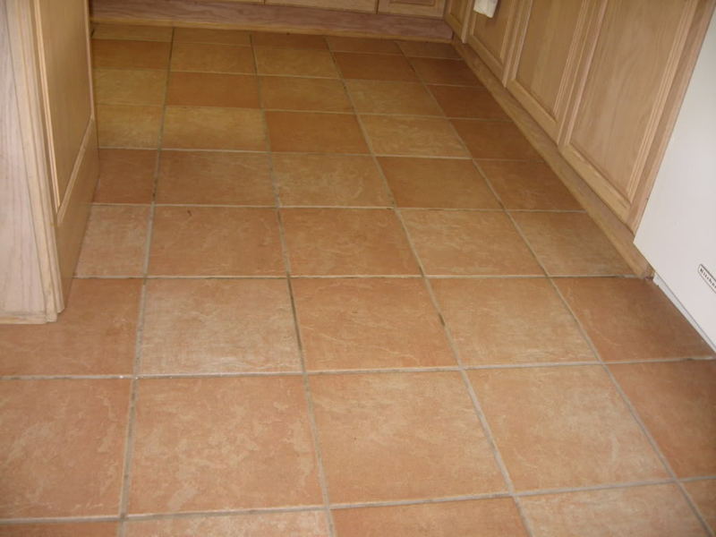

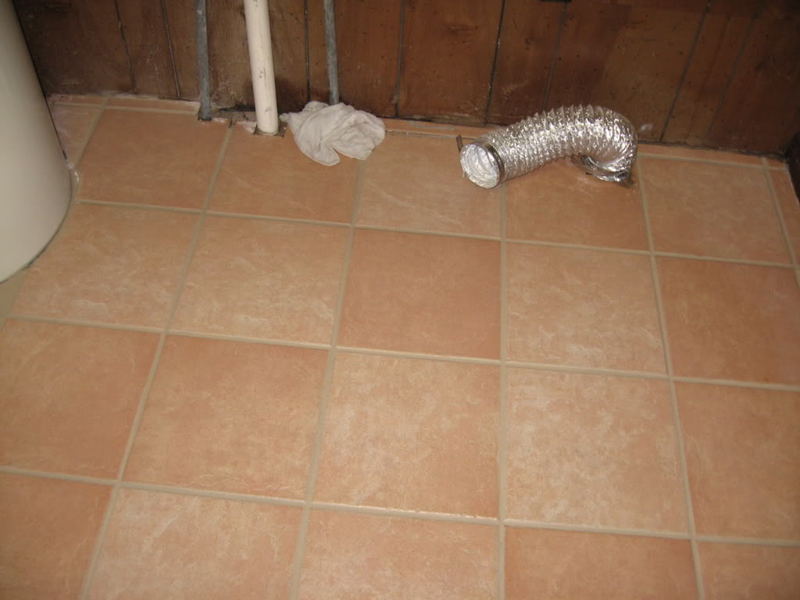

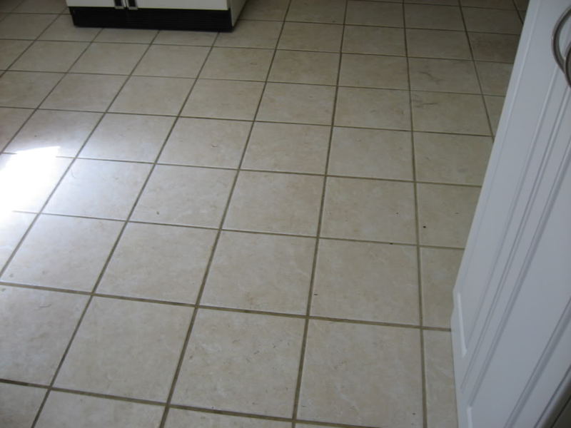

Here is the last one for free
Before
After
Before
After
Another after no before though
This job took 2 coats cause we went from a dark brown to a light color. Second coat went way faster than the first.
