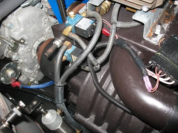

I took my hoses off to replace them because the actuator arm did not seem to be getting enough air to open or rise.
Thought it was simple so I did not pay enough attention when I disassembled them.
Seems I have a three way connector with a connection left over ?
If you have a boxxer 421, Please post a picture of the configuration ASAP !!!
Thanks

The center one will be the supply(constant vacumm from the source. One of the others will open the diverter and the other will close it. Pretty simple, try it one way, turn the therm switch on and off, see if it works the right way. If not just reverse the hoses.

Its an image shack ad. Very clever. Trying to sell anti virus software. Ill try to post the pics another way.
J
jerry ACC
Re: Need picture of air hose system to diverter arm for HM 4
Thanks Tony.
The pics helped, I got the POS running.
