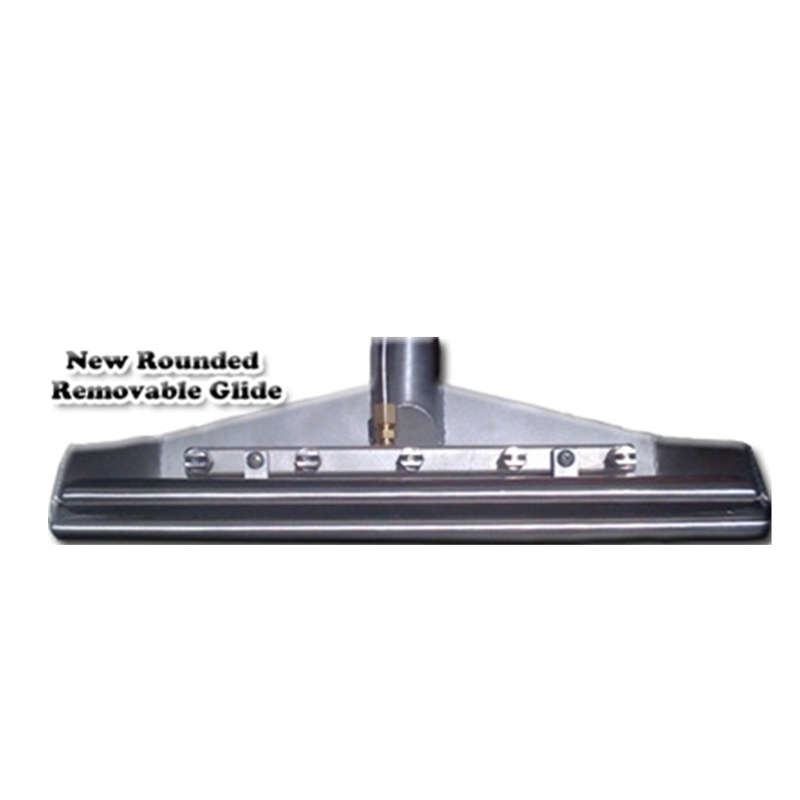

Big Boy Original! With New Rounded Stainless Steel lips!
This Big Boy wand started a following like we had never seen before. Now the same wand is even better with rounded stainless steel lips!
All decked out with 14” heads, 5 stainless jets, 1200 psi, low profile head for an incredible reach and ALL shiny stainless construction Big Boy is back to please.
The weight of this wand is all directed to the head to reduce chatter and make it easier to glide!
Should be easy to use but no base board and transition area protection that Glides provide

So.....when do you think they will "get" it?
Clueless.
You lead that fricken horse to water, but then you just end up beating the damn thing.
Frustrating....another year of phone calls, 'so what about those round SS glide wands?'

I love how he says all the weight is in the head so it will have less chatter.
That just tells me it's heavy as hell.
Would love to try one just for the hell of it.
Wonder what they are charging for it?

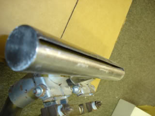

and when the rounded glide wears a thin flat spot at the vacuum slot and forms two razors, and the gap between those razors grows each month making pushing the wand real interesting.
Let me dig up a pic of this exact thing:
and let me tell you this, that slot is razor sharp.

Rounded surface area is the key.
I've got a experimental wand just like that in my office!
The gig is up greenie........................

Can't they just make the lips rounded more?
Hey Greenie, can you make the part near the baseboards on your glide not as thick so we can get closer to the baseboards?
Have you tried anything like that?

has the typical jet system as well, straight down spray.
Still won't work as well as a GH. Old tech.
Could a glide head be made from SS rod, ie solid, rather than a tube?
