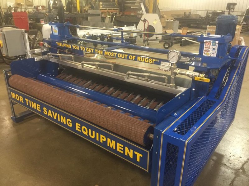

Tom Monahan

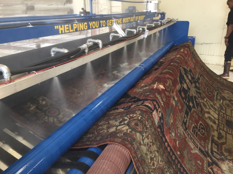

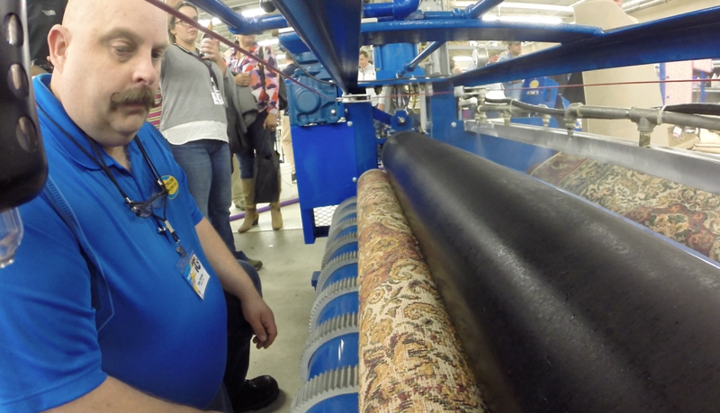

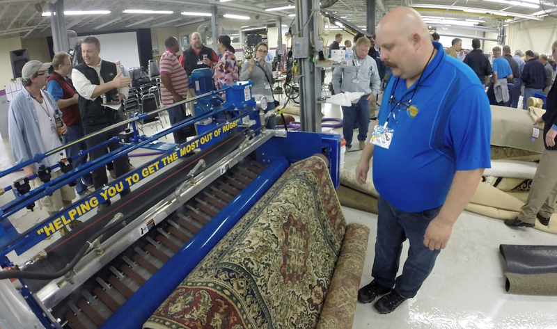

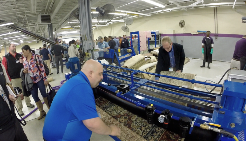

Legacy of the Moore Standard:
Simple to operate - Built to last - Mechanically Sound
This machine will be demonstrated at Rug Summit 10 at Hagopian's this week

A wringer/rinser is possibly one of the most versatile and useful machines a medium size plant can have after a centrifuge. I bought one of the last ones the Mor company built nearly 20 years ago and we still use it every day, all day long.

I like the looks of the machine. It's close to the design of the Mor wringer we have, one of the last built by the Mor company under original ownership. The front end on the one exhibited in Detroit had a slightly different feed with the rug going under a roller bar that puts about a 20 degree 'bend' in the rug, allowing water to build up at the bend. I suppose it's a rinsing function (the pile of the rug being flexed under water) but I prefer a direct feed to the main wringer rollers. The machines are built to order so you can specify whatever small details you like. I'd add a variable control pressure pump to the front jets and a reverse switch. Reverse allows you to put 'mud rugs' on the wringer and run them backwards and forwards multiple times till most of the mud is squeezed out; kind of like a super squeegee, but infinitely less work. Cost is a major inhibitor, but as it stands now I could sell the machine I bought years ago for at least twice what I paid for it and I can't begin to calculate how much labor cost and sweat it has saved us. Money is cheaper today than it ever will be. If you bought a tool that cost less than an one employee for five years, and could sell at the ten year point for exactly what you paid for it, it makes sense even if you are only washing 500 square feet a day. And no, Tom and Greg don't pay me to say this stuff. I am a true believer. Anyone who cares to visit is welcome to see the tools in use.

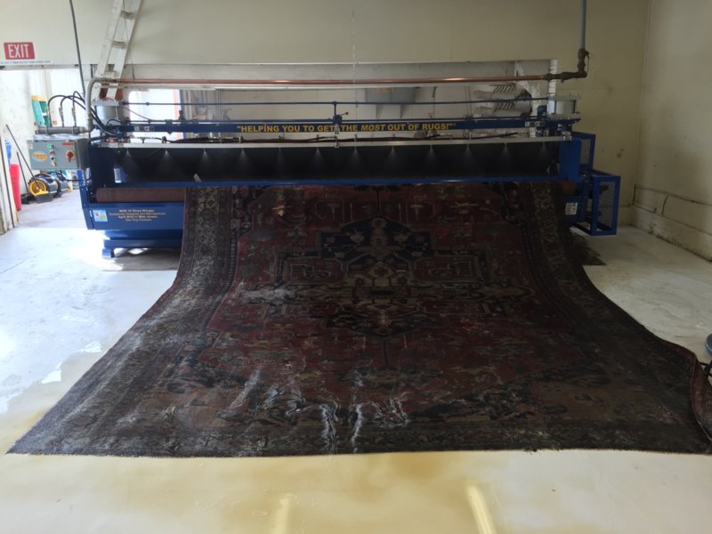

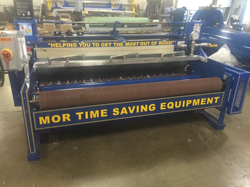

This 16' MOR Rinse Wringer was delivered earlier this year to a California operation:
. Current cost $125,000

That pricing seems fair and consistent with other CF products, for what you're getting. Does this unit have a variable speed control for the conveyor function?

Absolutely! It has a reverse feature too. Additionally, you can dial in the squeeze setting for the wringer rollers.

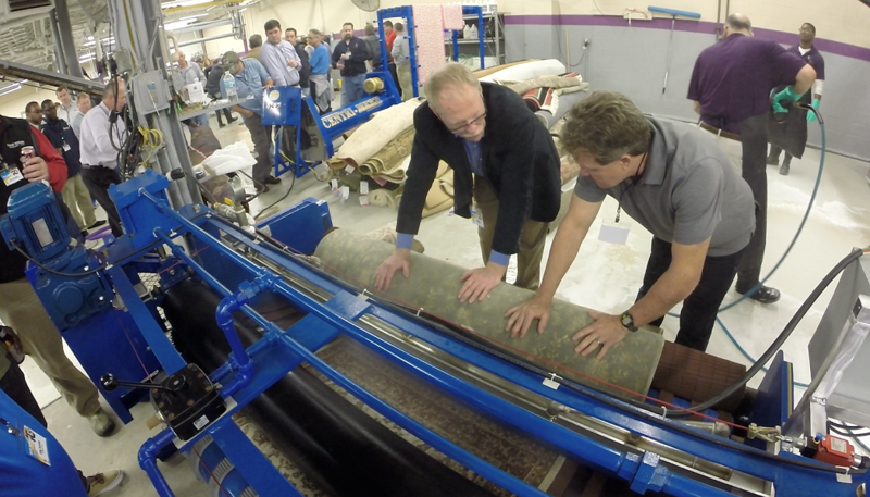

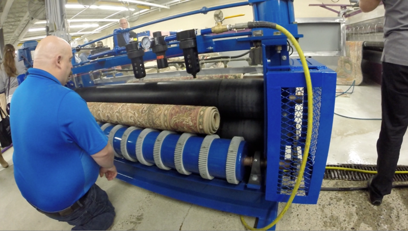

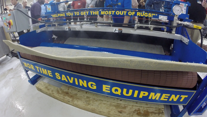

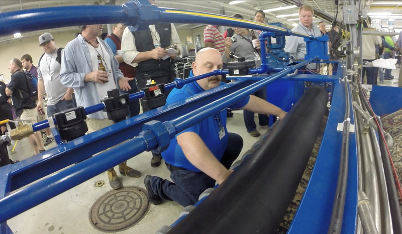

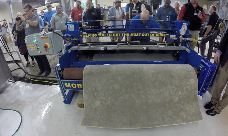

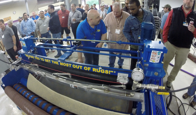

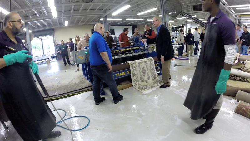

From Rug Summit 10 - This is to assist in someone's dreams:
