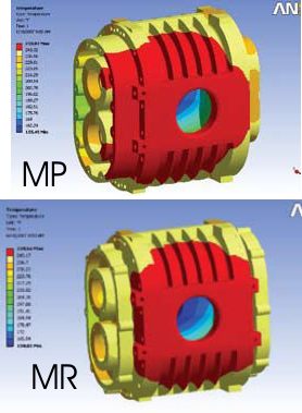

These photos show two Infrared thermal images:
Top image is MP Blower showing heat transfer into "Gear Area"
Bottom image is MR Blower showing no heat transfer into "Gear Area"
Caption from MR thermal image:
With FEA thermal analysis, a good design was made great.
• Innovative bearing housing design with air gaps
reduce gear end sump temperatures by 15°F,
extending lubricant, bearing, and blower life
Larry
