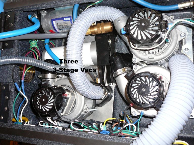

Ok so ken tells me that you can buy em with all three vacs parallel? Would this be a better configuration?
I'm also wondering why all that heat couldn't be put to use heating the water? Something like the perfect heat system powerflite uses? Or would that be breaking patent laws?
"Perfect Heat" isn't really perfect. It's very difficult to heat water with hot air and those vac motors don't produce enough to heat water. Mytee makes a little air manifold to cool the motors with outside air. If Larry wants to try them I could send him a couple.
The reason the hose is going inside the vac motor is to lower the airflow and thus the amp draw, I think. Correct me if I'm wrong. (it won't be the first time)
What I don't understand about that is how do you get a sealed vacuum doing that? Wouldn't it be better to just run it OVER the exhaust port and seal with a hose clamp to ensure no leakage?
Either way, I just don't like the looks of the way they shoehorned stuff in there.

truckmount girl said:
There are some SERIOUS tight bends in that vac plumbing.
Question for those who build portys:
WHY are vac motors always mounted to the floor of the unit? Why can't they be mounted to the inner walls as well to more efficiently use space and relieve overcrowding/overheating/tight bends? I'm sure there must be a good reason....what is it?
take care,
Lisa
From my perspective there are a couple of reasons.
#1 The waste tank needs to be quite strong to hold the vacuum pressure, that is why they are always ribbed and usually round. The supply tank has no vacuum pressure on it so they are designed to be molded around the waste tank.
#2 The placement of the bottom of the waste tank needs to be above the rim--toilet rim that is-- for gravity dumping into a toilet or 5 gallon bucket.
#3 The vac motors need to be accessible for replacement and in one compartment helps.
You have three compartments--fresh water--waste water--engine compartment. You are locked into the location and size of waste tank as high and round. This leaves a space behind or in front of the tank and there has to be a compartment below the waste tank.
If you put the motors above the waste tank then your weight is very high and tippy when empty. Carrying a load with two big empty tanks and all the weight high is unbalanced. When you go to more vac motors and a heavier pump this increases the tippyness. I believe US Products builds extractors this way.
Another problem with the motors under is you have to suck from the top. So they run a pipe up the inside of the waste tank. This is to make it look sleeker but takes volume out of the waste tank. Ed V runs his hose on the outside I believe.
Greenie mentioned he could not get three pipes from the motors to the top of the waste tank, if he did he would end up with a much smaller waste tank and three penetrations( I love that word) of the bottom of the waste tank to seal and three shutoffs to try and place on top of those pipes.
I don't know why greenie didn't put a manifold on the bottom of the tank and a 2.5" or 3" single pipe up???
These machines are normally designed to handle two motors and a pump and a heater in the motor compartment. The building of a new mold is expensive so most people trying to hotrod a porty are using an available box. The Mytee Breeze has one of the largest motor compartments and the unit is inexpensive.
In a non mobile unit you would mount the motors over the tank which is the best place---less hose (less power loss) and less waste tank volume loss.
We are also limited by overall size and some of the quirks of rotomold design. I dnon't know much about that but Mr Mytee does.
But the easiest way to hotrod a porty is add a booster or two.
Greenie and Mr Mytee i would love feedback on my thoughts.
Rick

rick imby said:
Rick, #1,#2, & #3 are right on.
Yes, regardless how you get there, you need to have vacuums suck from above the "foam line", and you need some air/water separation, that is actually something you never hear about in a 10 gal. porty but it's a HUGE factor in high performance extraction....it's also the reason a guy like me can only do "so much" when hotrodding existing machines.
It's a good idea, you took the words and thoughts right out of my mind. Problem is, we have to work from the current avail. parts, there aren't any readily avail. 2.5" float shut offs, and I've not yet seen 2.5" wire re-inforced hose and 2.5" custome vacuum manifold motor mounts.....but who knows, John Labarbera is a crafty dude.
lol...John will love that one
True....just match it up, you don't want to overpower it in the tug-o-war.
***Side note***
My thoughts as to why the vac motors last better in an upright position is because when (not if) water gets sucked into the motors the residual water drains away from the bearings. If it were a dry vac I believe the motor orientation makes very little difference---This is just one of my theories.
Excellent theory, and true, therefore it's now a Rick Fact.
Heat and water is what kills vacs, if you changed the brushes annually BEFORE they wore out, and protected from heat and moisture, they would last an incredible time....nobody changes the brushes enough, they wait too long.

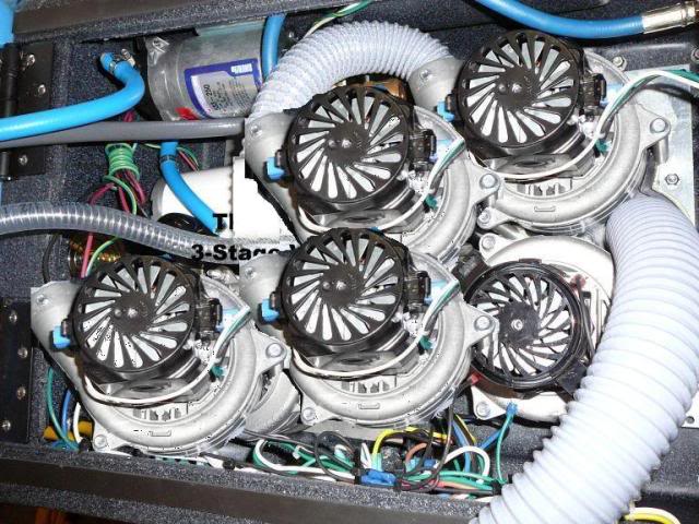

Mikey P said:
Larry, did Ken design this, you? or both of you?
Was it tested in a normally wired home for a few hours to see if it's safe?
While Greenie, and Terje are jumping all over this, they do make some very important points about fire safety that I feel you should be addressing.
Mikey;
The concept of this machine was most powerful machine operating on a 15 and 20 amp circuit.
This is, like all high performance portables we offer, our design.
The prototype has been tested with new Extech clamp-on ammeters extensively.
No functioning 20 Amp circuit breaker will trip; running this machine for hours.
Most houses have had 20 Amp circuit breakers for the last 20 years.
Larry
P.S. For the record, we pioneered the 1st 3-vac portable many years ago.
It ran on two 15 amp circuits.

Greenie
Larry, are you sure?
The Steamway 900 is a pretty old machine, and there might have even been one or two before that that had 3 vacs in series, I'll have to see if Les remembers any?
