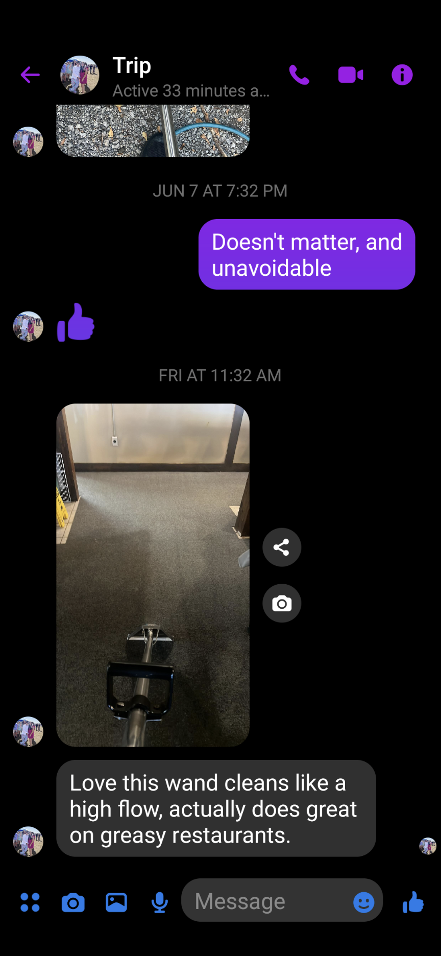

Trip Moses
matt if you were "attentive" you would have realized how you could have trimmed the back of your 530 Glide @ two little slivers off the corner edges and it would have fit in all the way in, and I've sold my extender Benders to people that are far more astute than you so I take your attack highly personally, and, I have 4 last words to say on the subject.
No soup for you.
Just today...
THIS IS NOT ME. THIS IS A DIFFERENT TRIP. I DO NOT DO RESTAURANTS. I AM A HIGH END HACK.
