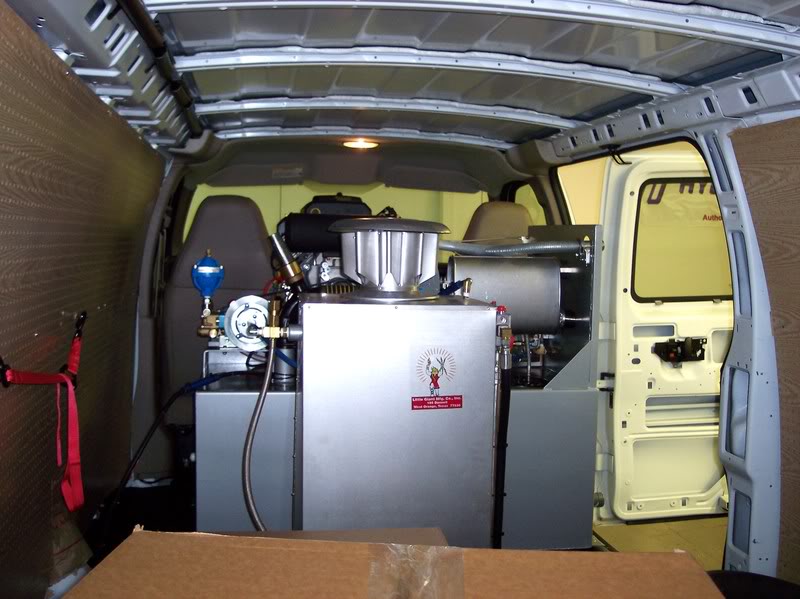

The TNT has been in existence longer than any truckmount in production. It is on it’s 35th year of production. The superior design of the TNT not only does not overheat, but it power-ventilates the van with the engine. Having the engine between the seats makes it very easy to service the engine. Simply sit in the seat, turn around and service the engine. When the TNT is running in a van, you can actually sit in the driver and passenger seat and there is zero heat coming from the unit in the truck. The engine has a high CFM cooling fan built into the unit. This high CFM blows air across the cooling fins of the heads. Then the Little Giant heater is located directly behind the engine. The high CFM of the engine blows across the heater and power-ventilates the entire van out the back door. After completing a carpet cleaning job with a TNT there is very little heat in the van due to this superior design.
This is a photo of a 22 year old TNT. As you can see, the exhaust pipe on the top left can be tilted upwards away from anyone’s face. Also note the location of the LP heater, behind the engine. The engine power-ventilates the entire interior of the van.

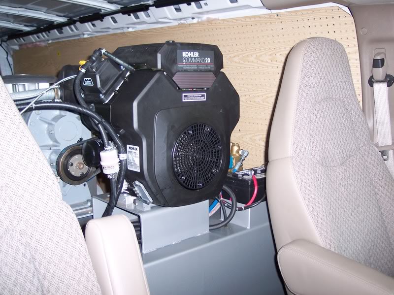

This is a photograph of a TNT installed in a van. Note the ease of service by having this location and also the location of the fresh air intake on the engine.

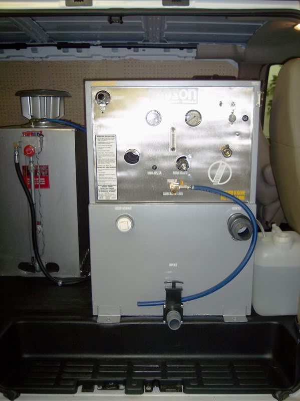

This is a photograph of the heater being mounted behind the engine as you can see the high CFM fan on the engine blows all heat out the back door.

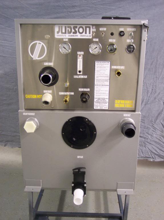

This is a photo of a TNT that has the new engine exhaust location. It is located below the blower exhaust. In this photo the blower does not have the 45 degree deflector on it yet. After installation of a TNT there are a lot of options with exhaust directions.

My thinking was not how hot am I going to get in the van,but how hot it will get in the in 110 degree heat with an air cooled motor,I am just using my Mikey given right to my opinion :lol: not pissing on you,I like your simplicity.
