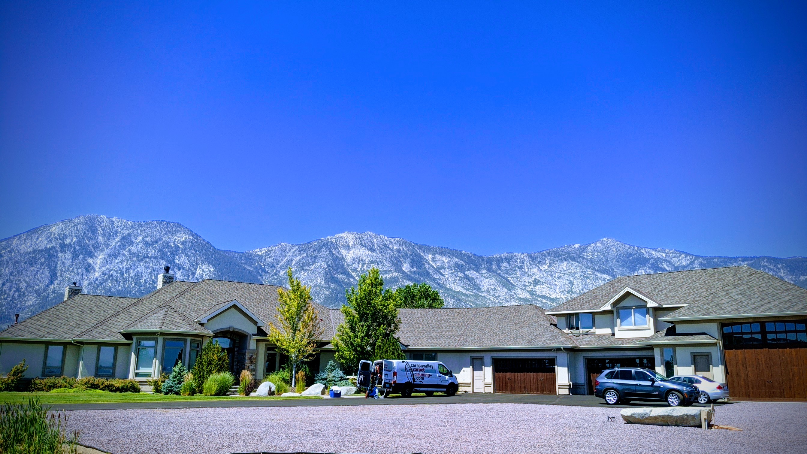

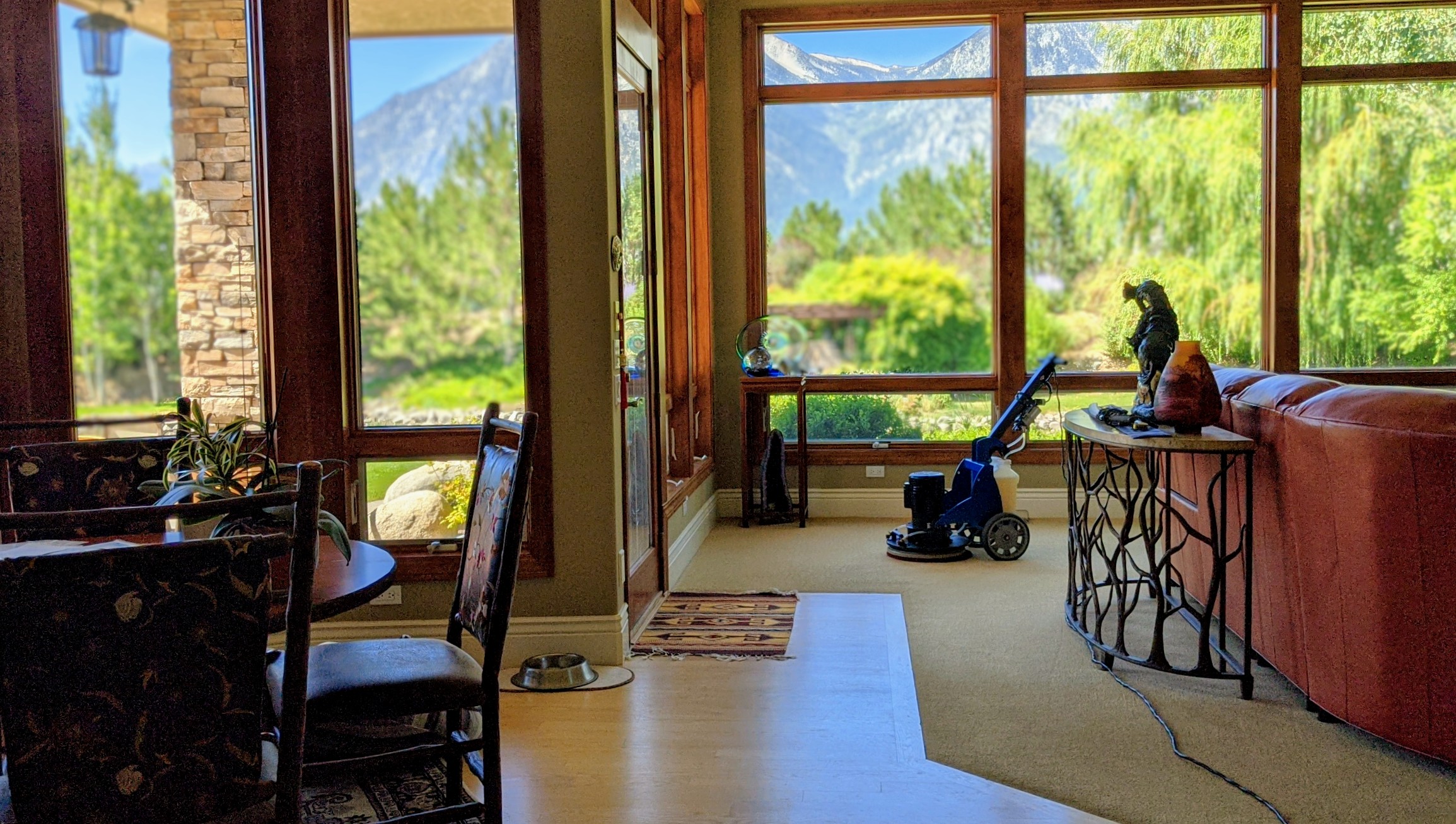

The richer and tidier the client, the more likely I'm going to use my TOPS Phoenix
5 rooms, 4 small spots..
Would have taken 200 ft of runners and 542 corner guards.
Doors stayed closed.
Carpet is fluffy, spotless and dry when I left...
117,317
I fully explain the process and she already knows I'm the only carpet cleaner they're not 100 mi of here that offers every method..
Ounce and a half a PCP maybe an ounce of peroxide maybe an ounce of top spotter and 6 pads.

Jim you're thinking of the jigglers of old with a short throw that were more prone to turning carpet tufts into Don King hairdos. These larger orbit machines along with the miracle of microfiber are extremely safe on every pile I've touched, no distortion and they're actually correcting cornrowing if you can believe that.
This house was 600 ft of carpet made spotless fluffy and smelling good with one gallon of water and an ounce and a half of chemical.....
Let that sink in
Now what do you think it would take the hot water extract that?
30 gallons of water?
And how much chemical?
What's the point of over cleaning when you can under clean and cause no harm and have an ecstatic customer?
