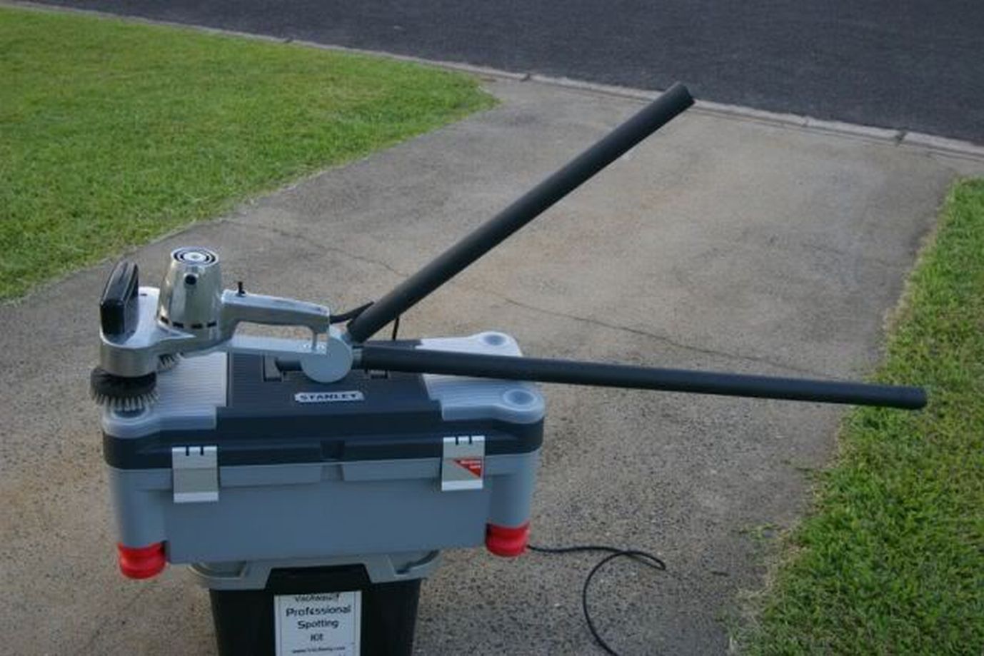

I also use the Oreck on stairs.
I find it does not do a great job on the risers, even without a bullnose. :icon_redface:
It tends to hug at the top of the riser, rather than cleaning the entire riser, just my opinion.
To stop the shakiness, centre the pad instead of having it off-set to the driver.
IF the risers are also in need of cleaning, which in my area, I find is nearly all of the time, I usually go to my OLD HOS Micro with extension handle.
I first prespray risers going up, then prespray treds coming down.
I then stand up, using the Micro facing the fibers and away from me, then proceed to clean the risers, from base to top.
I then come back down cleaning the treds, usually standing two steps below the one that I'm cleaning.
This method allows me to clean both risers & treds standing up & hardly bending my back, saving me pain.
When I bought my Micro, it came with two handles, I only ever need the short one, + it also fits in my tool box along with the Micro & spare brushes, extension lead, etc;
Works for this old fart.
