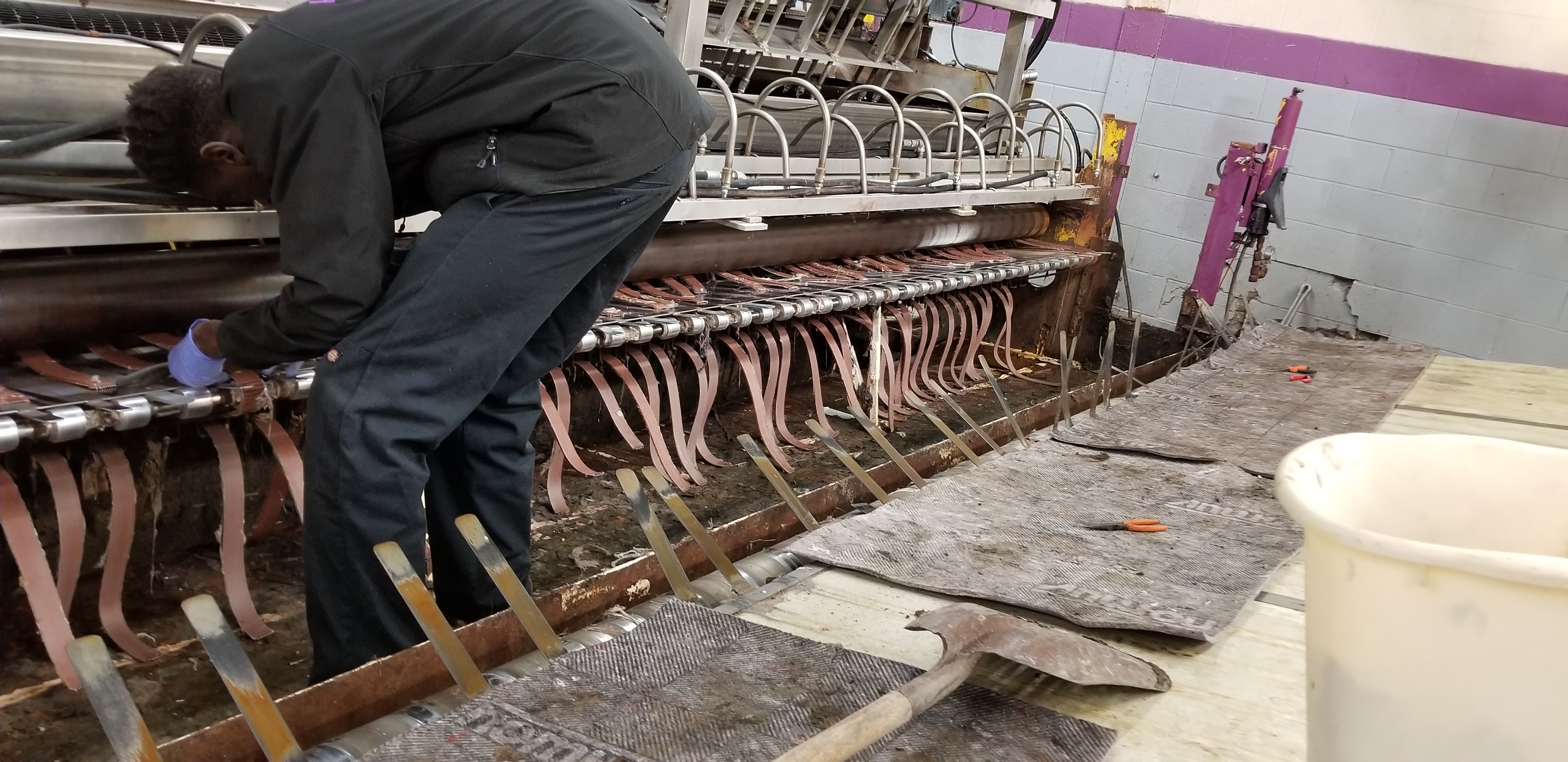

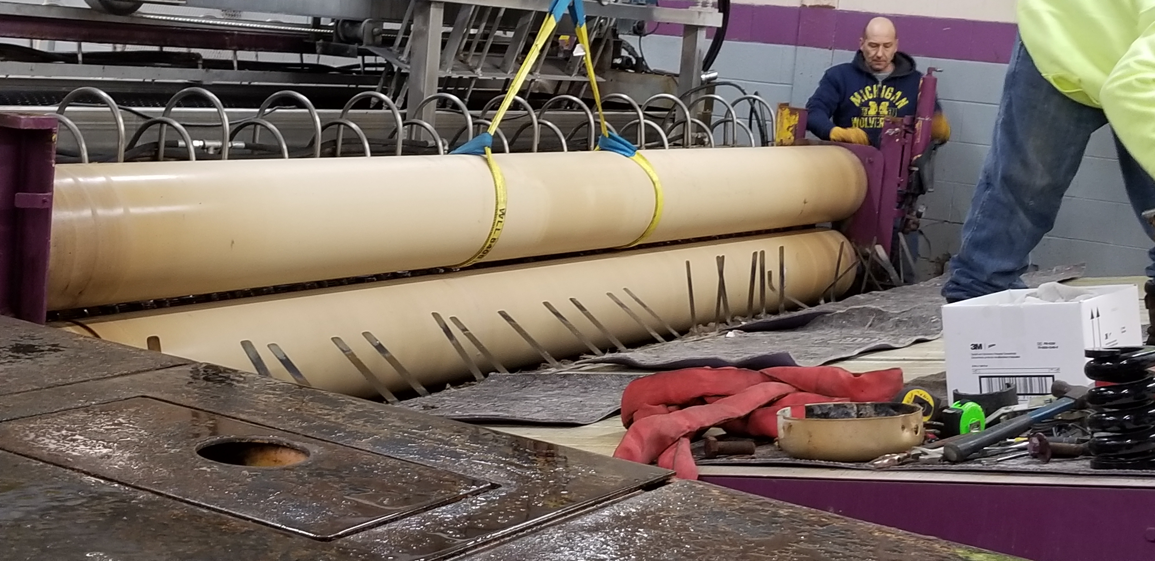

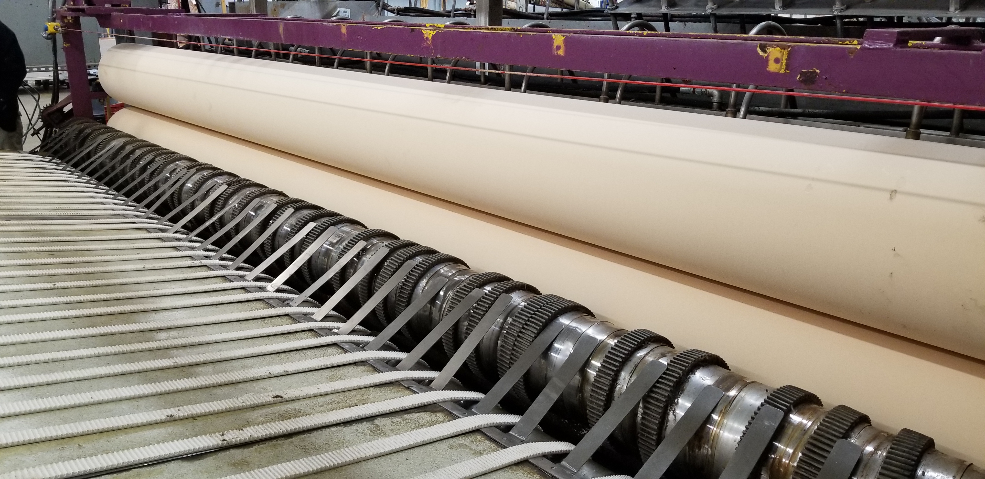

We replaced the ringers on our Moore's machine this week. Kudos to our head mechanic for coordinating it and getting it done on time and on budget!!

Measuring the hardness is an indicator. A new install should read between 65/70 on the durometer scale across the 16 foot length of each roller.
As the years go by, most MOR in-plant operations see diminished performance around years 10-12. After that they get hard measuring upwards to 80-90. They should have been replaced before that measurement. Some have made it to 15 years.
The biggest factor that hastens the rubber's life is the environment of one's operation and the type of rubber specified for installation application. Also, flat spots on the wringers can occur if they are left in the compressed state when not in use. They are heavy and in operation can exert around 125 p.s.i. against each other when working.
Note: The wringer rollers may look fine after many years, but they be failing to wring rugs out well. Why? Because they are too hard they cannot provide the squishy surface contact or squeezing effect necessary to compress the water out of the rug. To Illustrate: Think of a new properly inflated tire on a car. If it is too hard, the road contact surface is less, and therein is the issue. The compression wringers need adequate surface contact to squeegee the rug as it passes through.

We pulled ours last year to get at the rusting bed below. Just about the limit for our forklift.
We hired an outside company to lift the old rollers out and put the new ones in. We had them out one day, they gave us a couple of days to clean everything up underneath and then they came back to lift them in place. Our maintenance manager was able to coordinate everything, anticipate issues and it went very smoothly!!

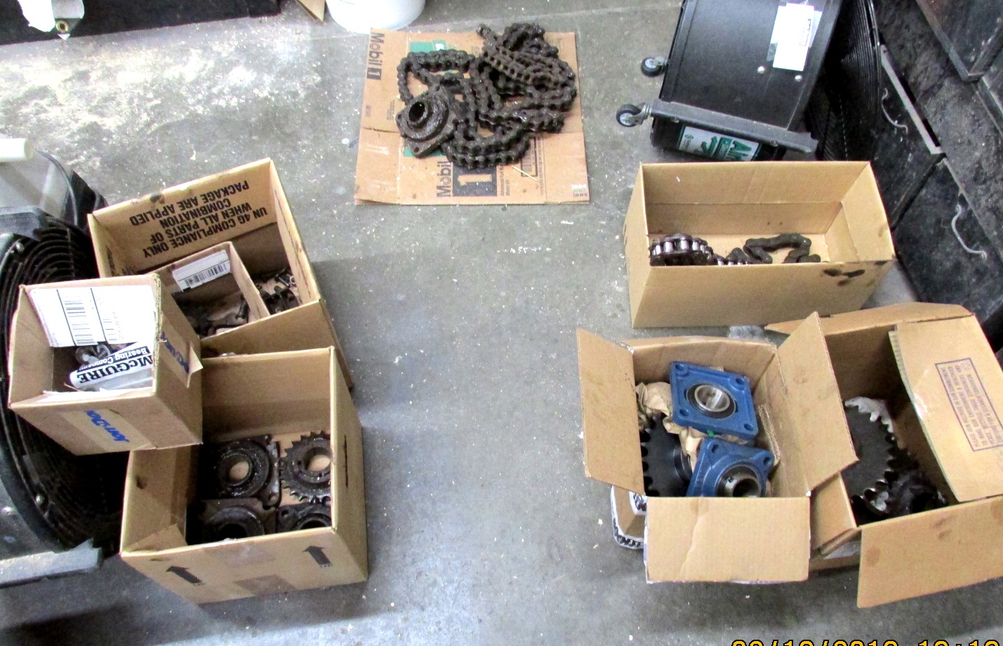

PS: When you get that deep into the machine you have to replace all the hard to get to stuff. Good thing these machines pay for themselves.
