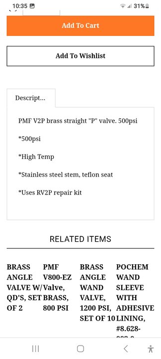

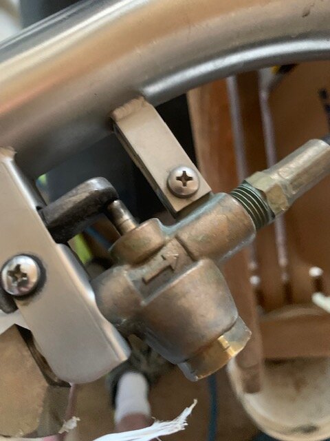

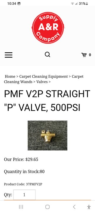

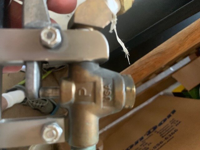

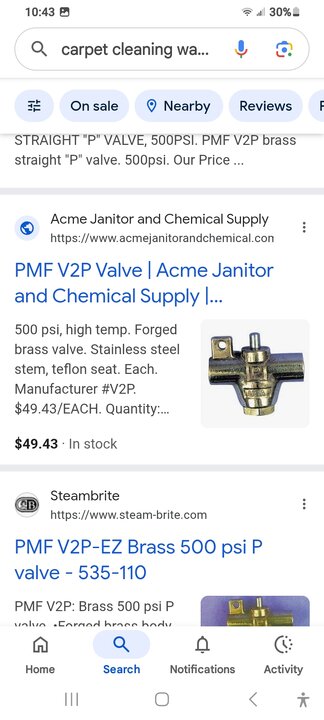

Ive heard of a K valve but need a new/parts for a P valve for my swivel stair tool IMG_3156.jpgIMG_3157.jpg

I would stay away from the EZ model. The trigger is so light that it sometimes doesn't shut off, especially when the wand is used upside down like on the riser
