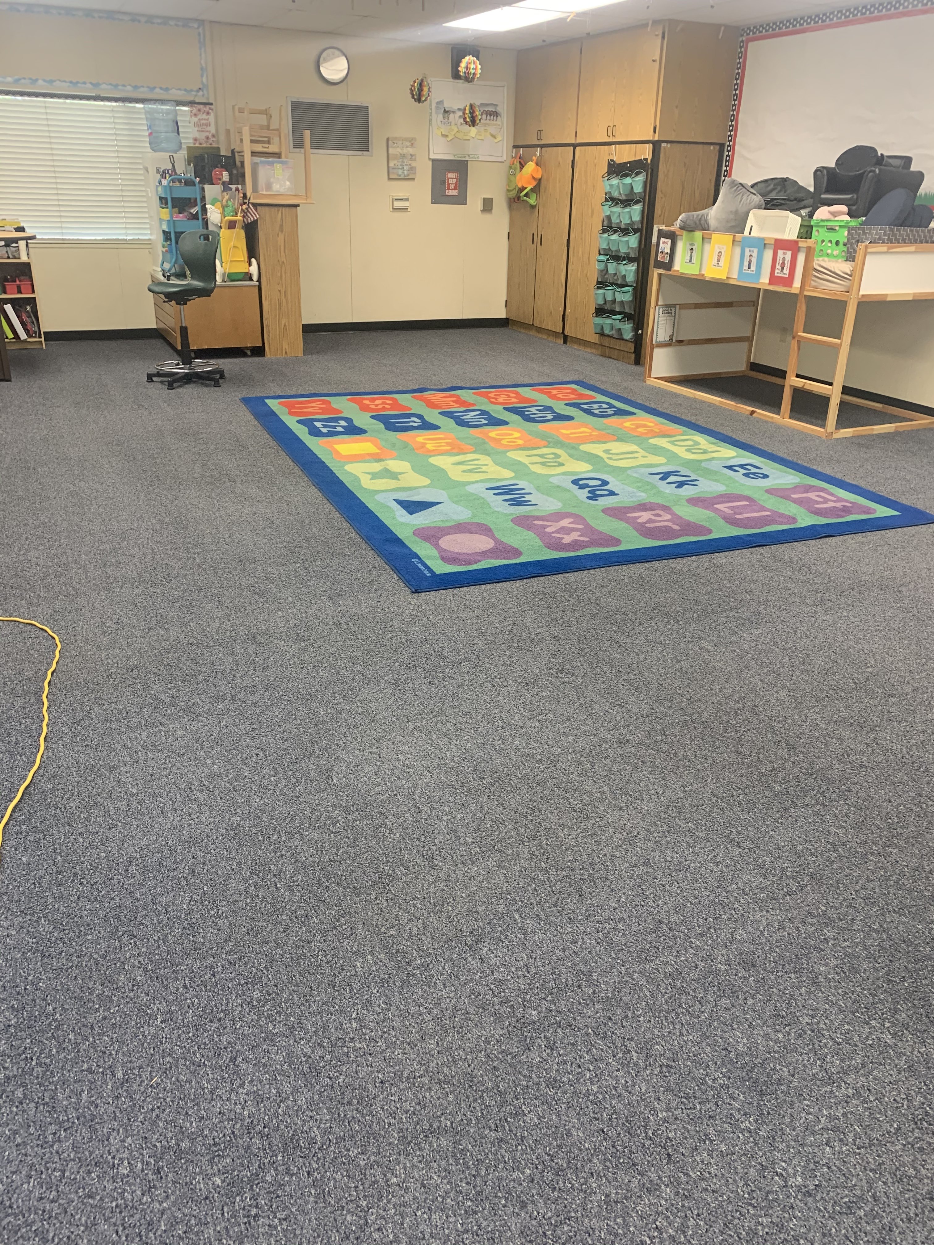

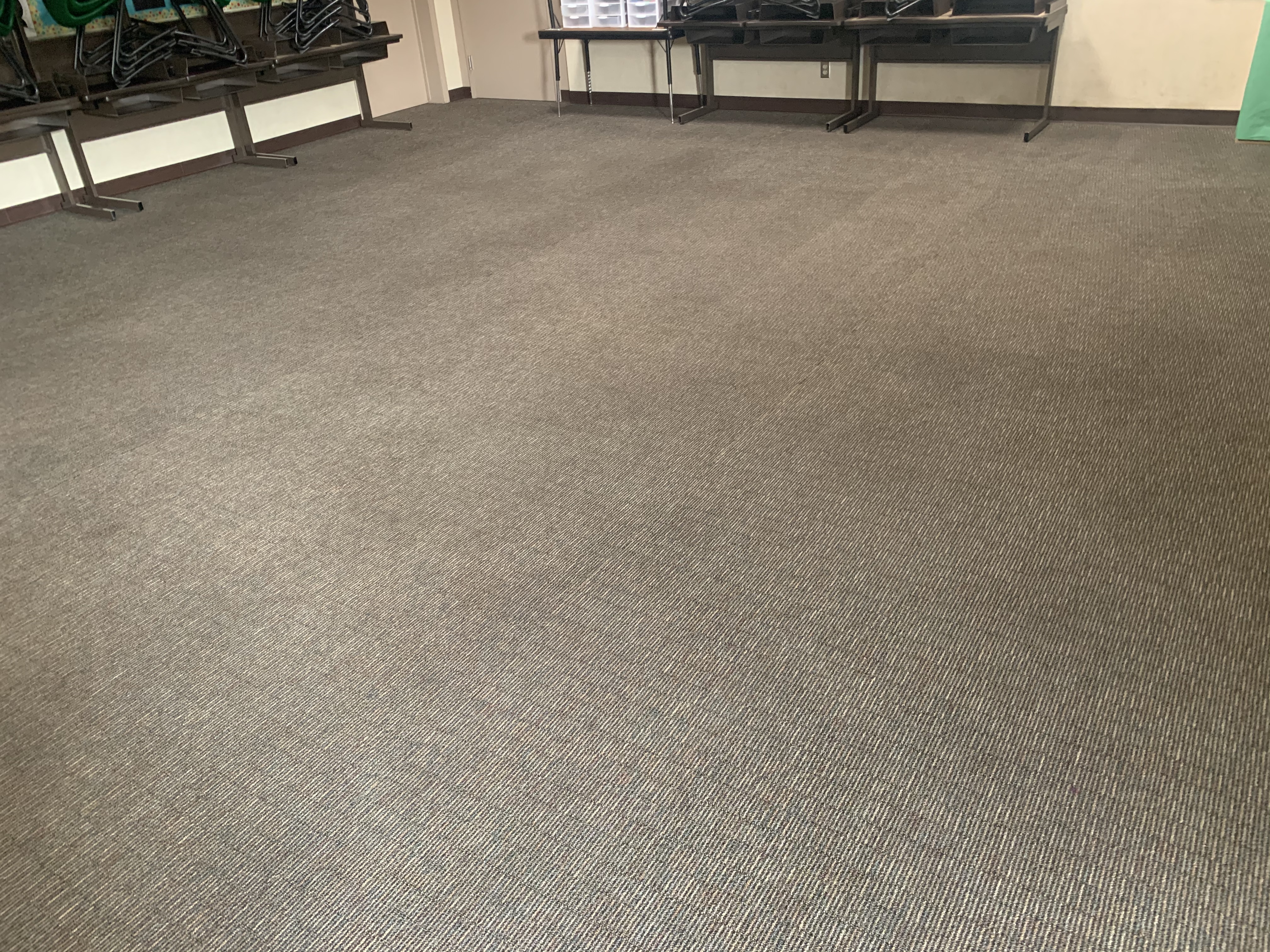

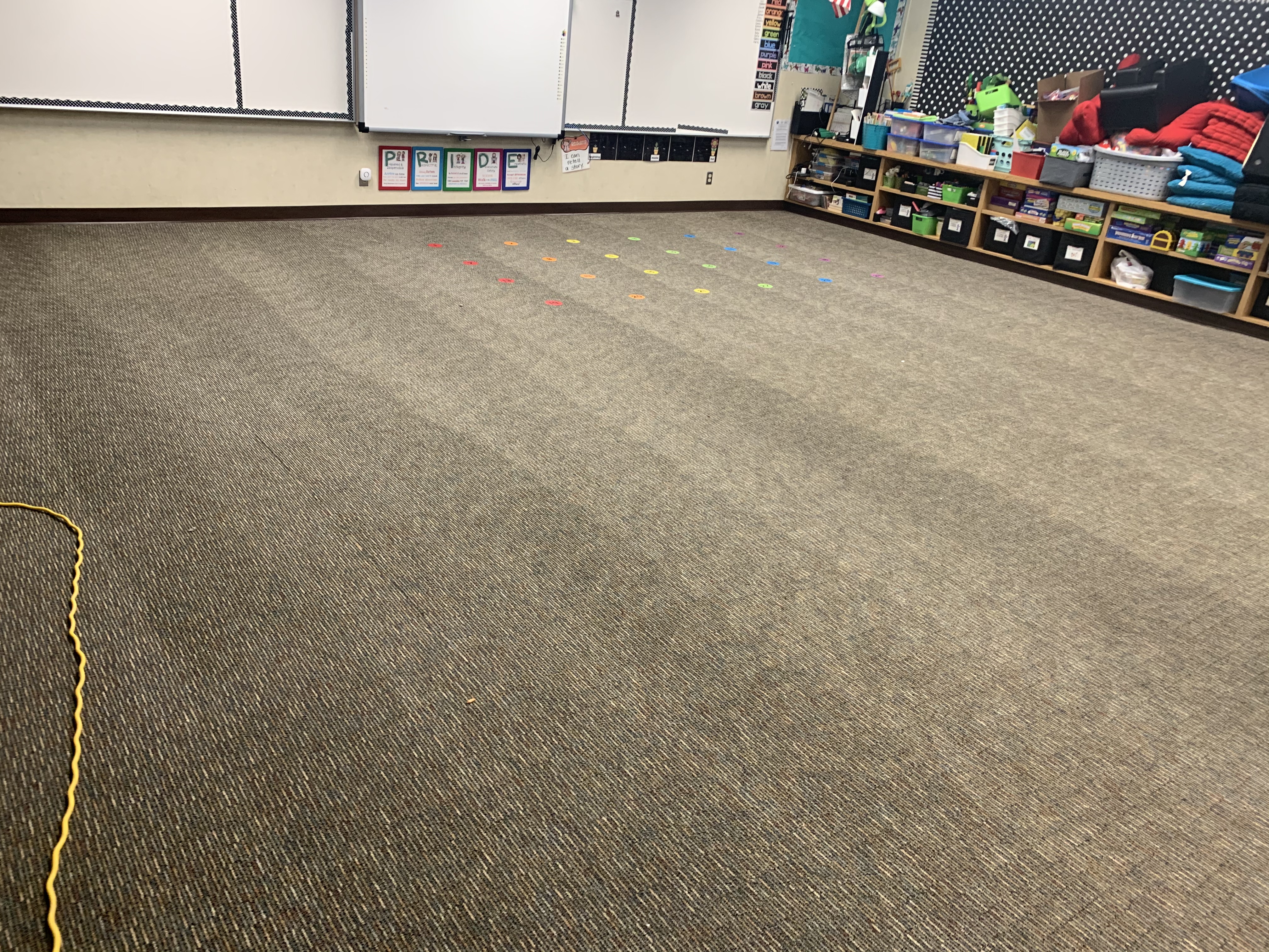

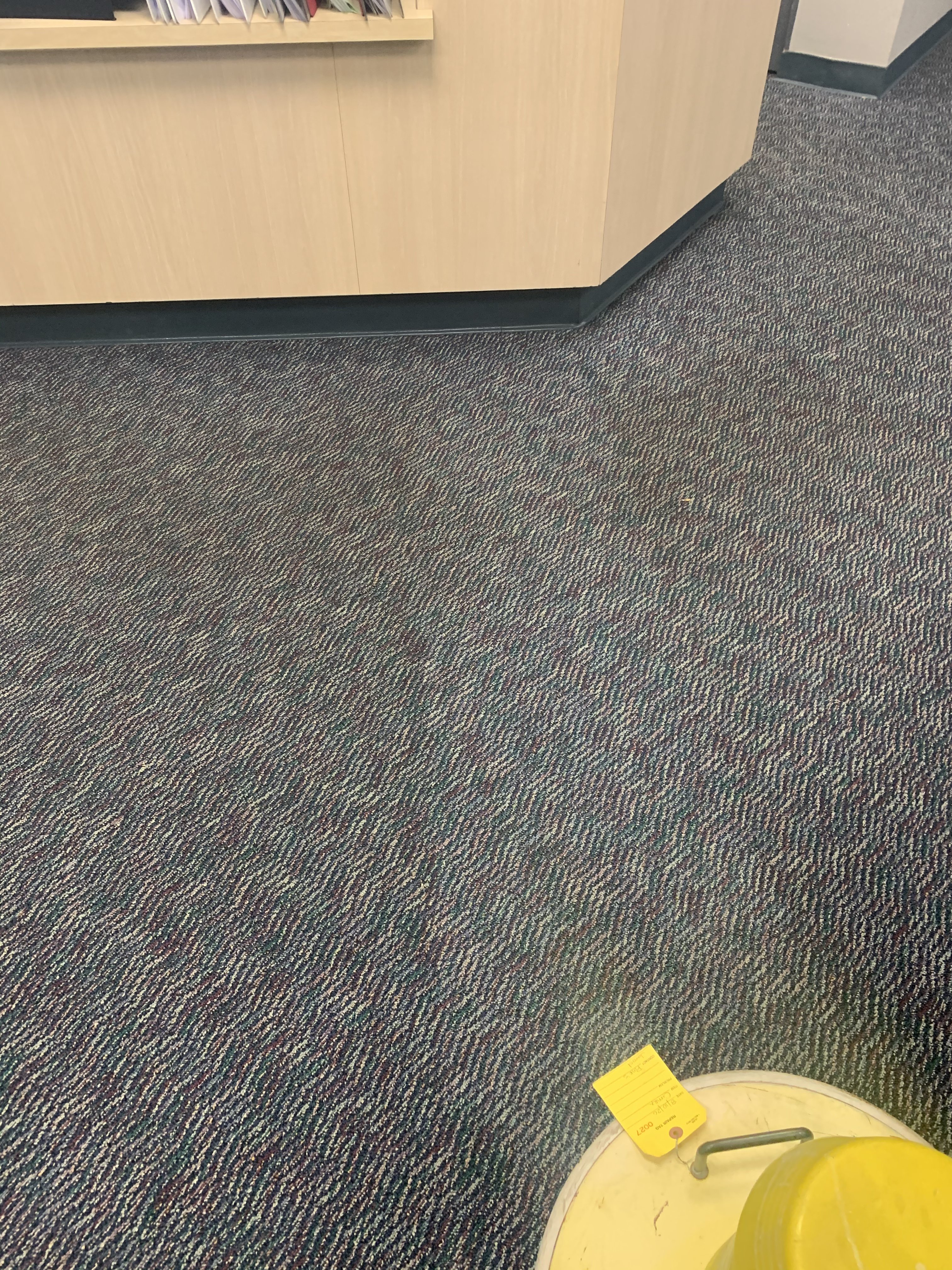

Man so I’m new to encap but I just can’t
I love excellent supply I KNOW ds2 is the real deal and I know encap has its place
but it let me down
we had two cimex machines going plus two TriNity machines
Everything seemed fine until it dried and my client called and said that they were unhappy
we went and looked and honestly it looked like shit
Customer said it looks like you just spread the dirt around
i Offered to reclean of course so we zippered the hell out of it and bam good results huge difference
so bring it with the trash talk I’m in the mood lol

No pics...
Not much can be discussed
4810A104-F4F5-4711-BA3E-18F25977B23D.jpeg 8BA3A609-5587-42BC-9FFD-F339F120F9C7.jpeg 9308FF02-E56F-41C2-BD2B-973F16FF173B.jpeg
Mr Brightside
May 4, 2019
942
Jay Wags
I have no encap experience
I am bummed
It seemed like the carpets where so bad already maybe too dirty for encap?
117,299
I think one of your Cimex heads is plugged up..
did you leave it all twirly looking like that That's what they mean by swirled dirt..
If you used a properly functionimg Cimex with two passes, one wet, one dry and then gone over it with a trinity or a 175 to smooth everything out and absorbed some soil, they would have been thrilled
