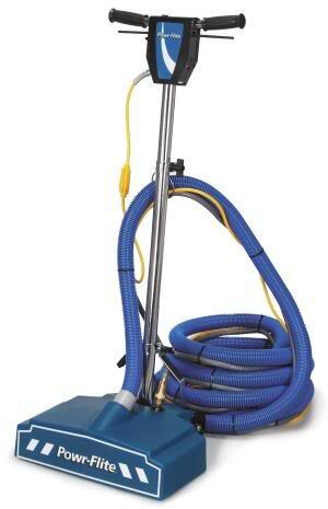

The problem with your suggestion is the design...It has a "sand trap"..that leaks air..
I guess you could "disable" the Vac. motor ...BUT WHY....?
If that is what you want ...Just get one of these.. :!:

Before I knew the first thing about cleaning carpet I dropped 3 grand which was every dollar I had at the time on the largest power flite portable and that brush attachment. I was told by my mentor that it was too heavy and to just get a 175 and be done with it. When I got the machine I knew right away I could never work with a 170 pound machine. I took it back minus a 250 restocking fee.
Hi Harper,
Is that one of those Powerhead or powerbrushes talked about earlier this week?
Thanks, Bill

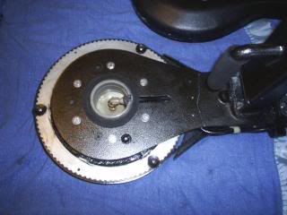

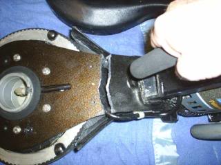

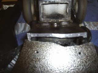

I have one ..that I will trade you for your "ON-DEMAND" tank off that everest...
"IF you know a GOOD WELDER.." :shock:
Les says it can be repaired... 8)
It is the old 2 piece model... :lol:
