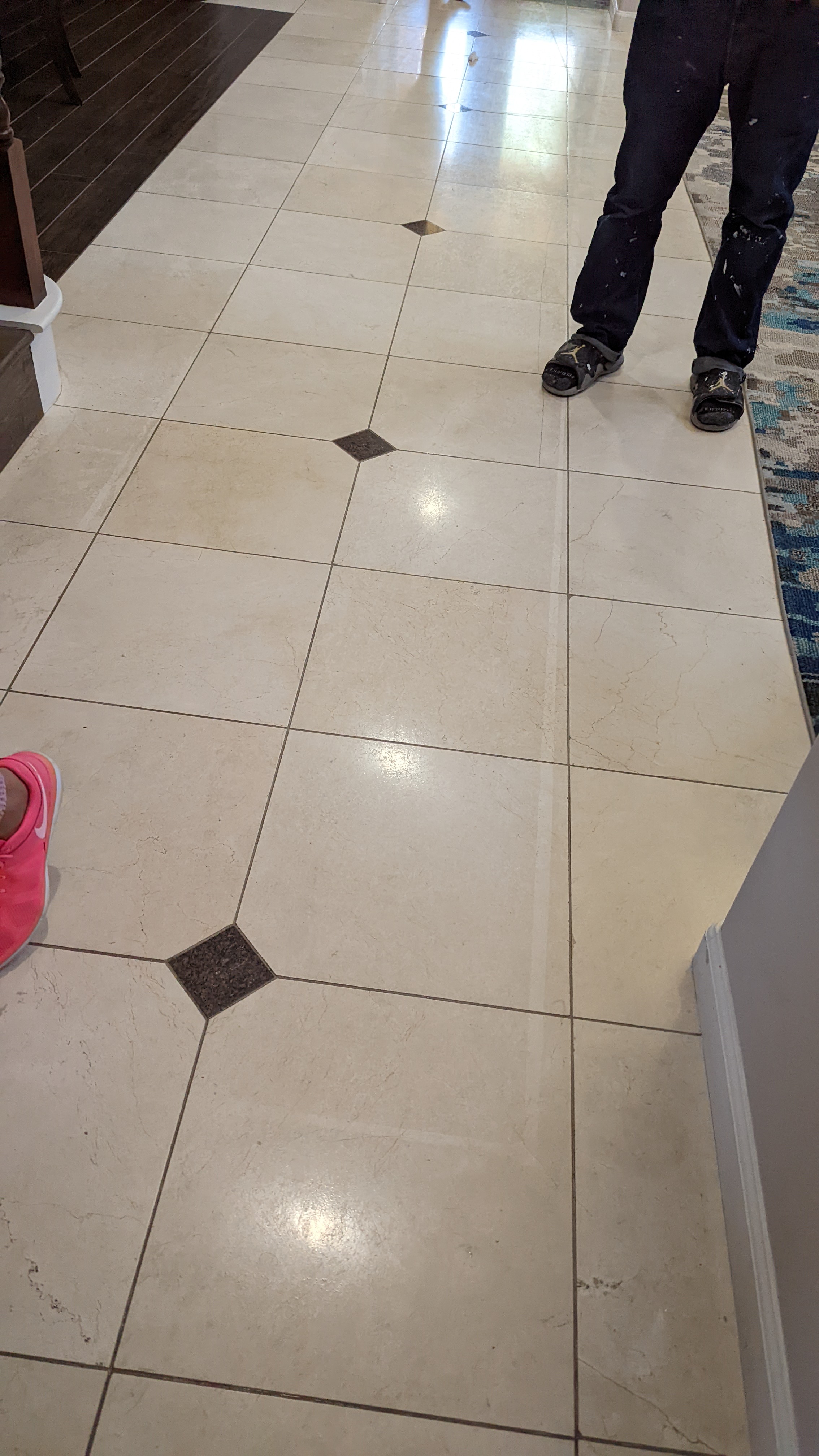

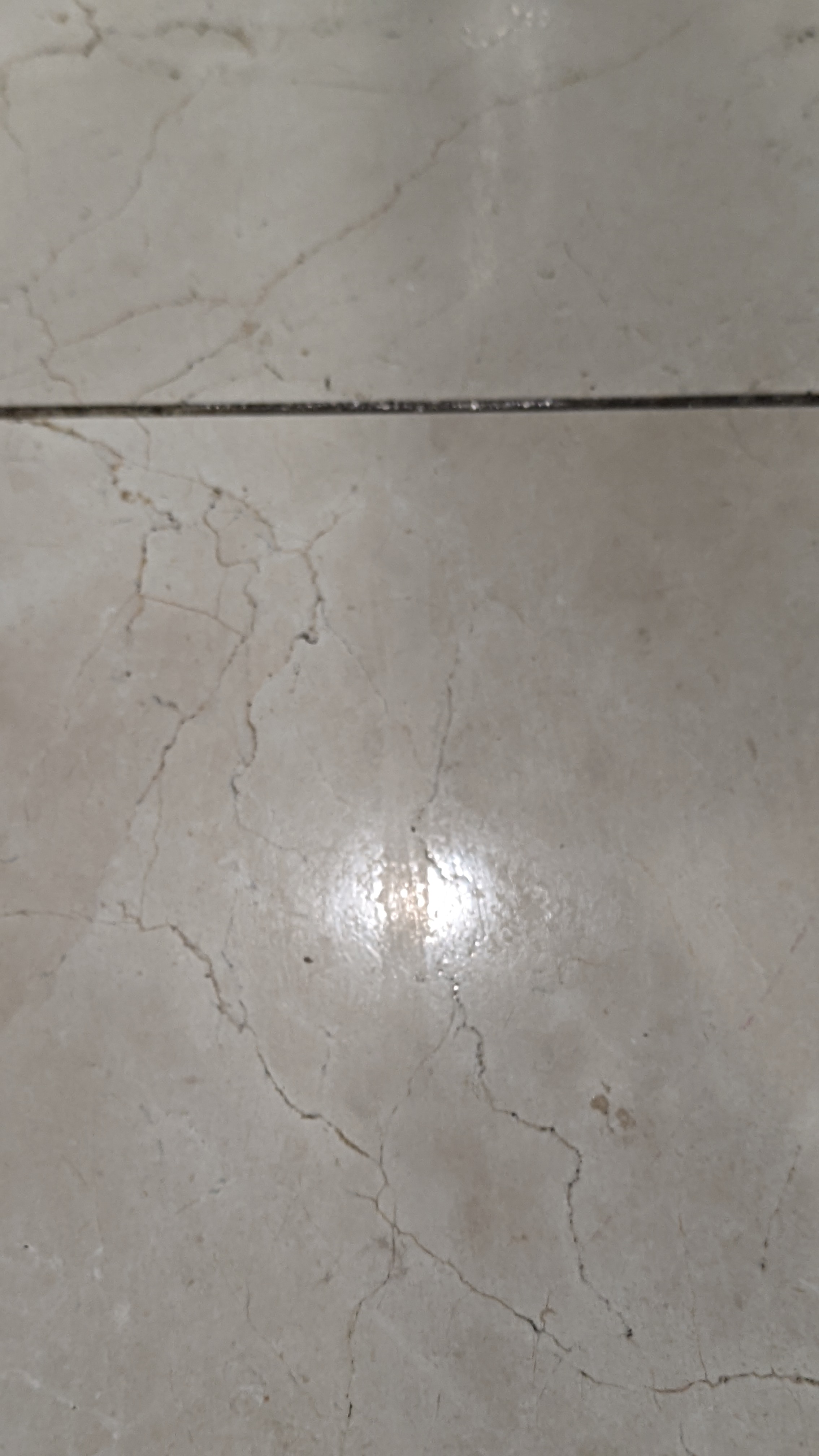

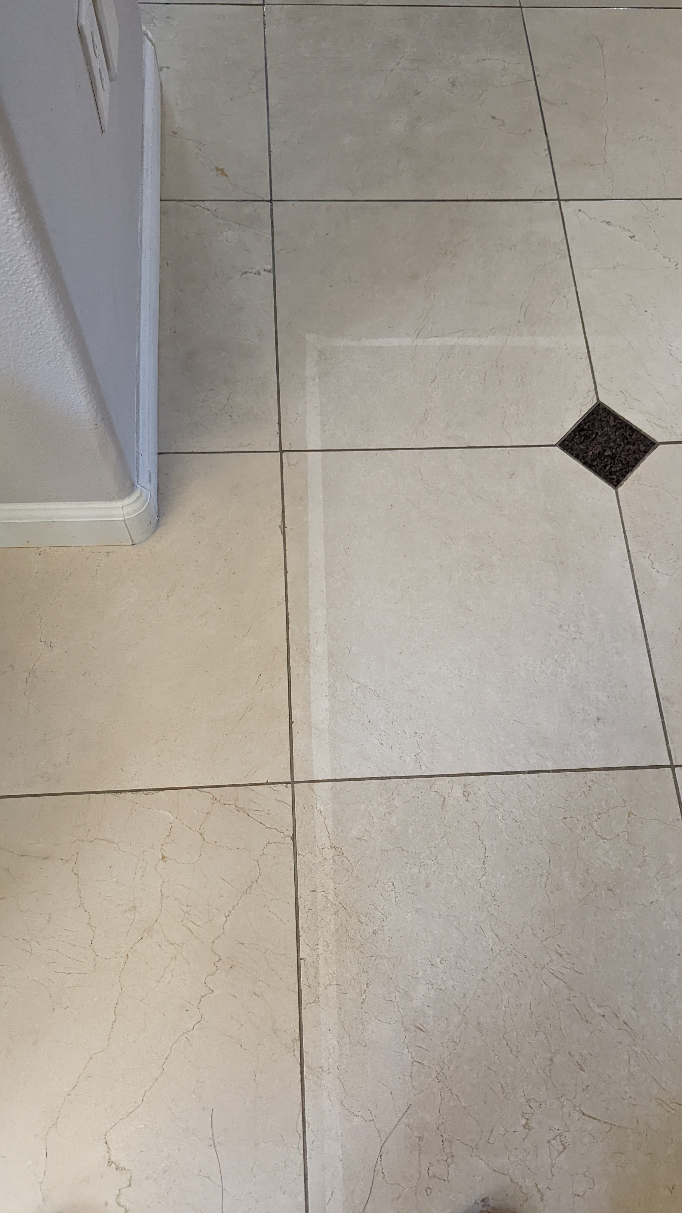

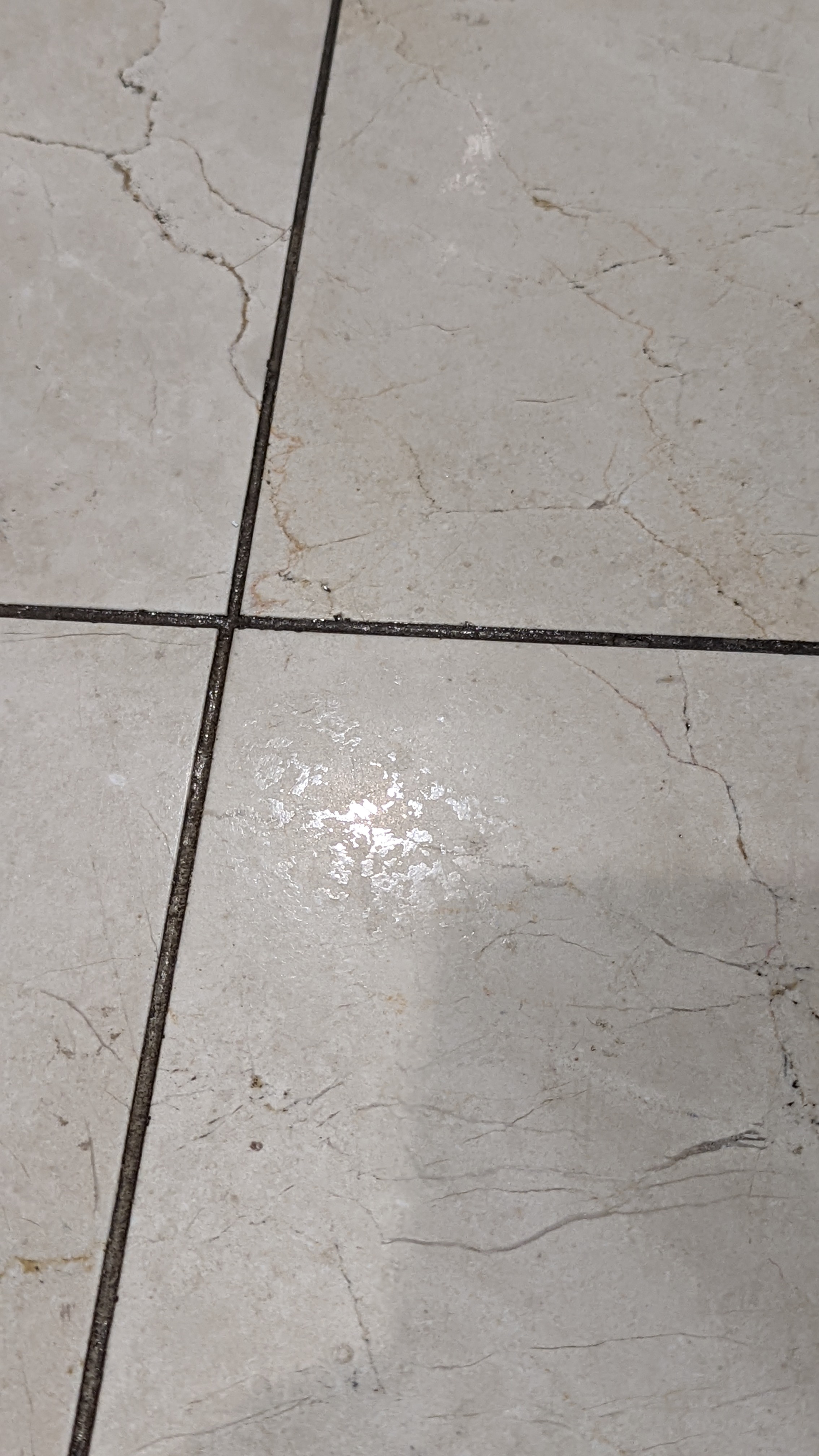

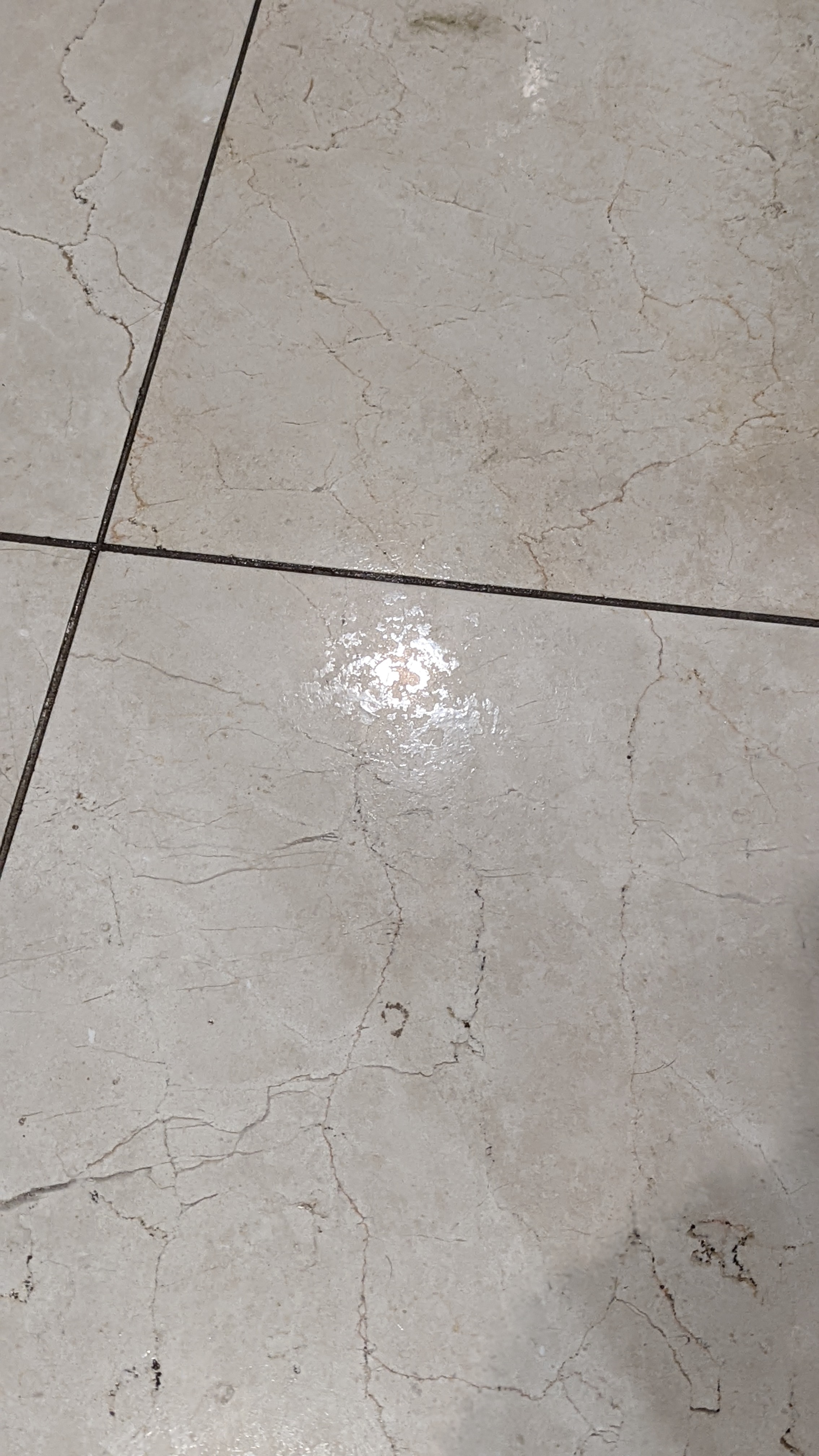

Construction company called say after they pulled up the tape the marble doesn't shine.
Going to look.
Going to look.
Home owner is a total butt.
Yeah I walked, felt sorry for the construction company that's on the hook for every thing that goes wrong in that house until doomsdayThat is enough reason to not proceed
If there is anything I've learned in this business, the challenge isn't in the cleaning, it is in the sorting out of the customers who you want to work for, and for whom you do not.
Yellowing acrylic wax. Willy will strip itLooks like they pulled the dirt and topical off with the tape.
I explained what I saw and she went crazy hahahah
View attachment 114794 View attachment 114795 View attachment 114796 View attachment 114797 View attachment 114798
I can strip it but from the home owners point of view she's mad some bad mop and glow peel she's gonna want it re waxed.Yellowing acrylic wax. Willy will strip it
