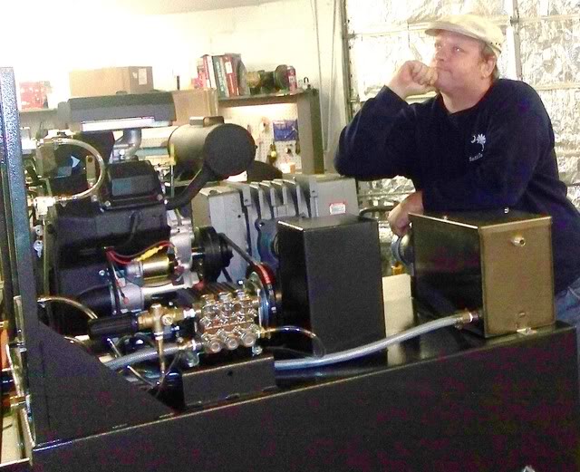

Prochem Everest just shuts down after running for 20 minutes
L
Leslie Judson Jones
Greenie said:
One more:
All things said.......thank Gawd for propane heaters....make 98% of the "need" for complicated stuff ...go away.
