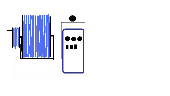

I do like the idea though. I wonder why companies like Hydramaster that offer the PTO don't offer a large waste tank that expaned out to the side and allowed and area to mount a hose real on it.
