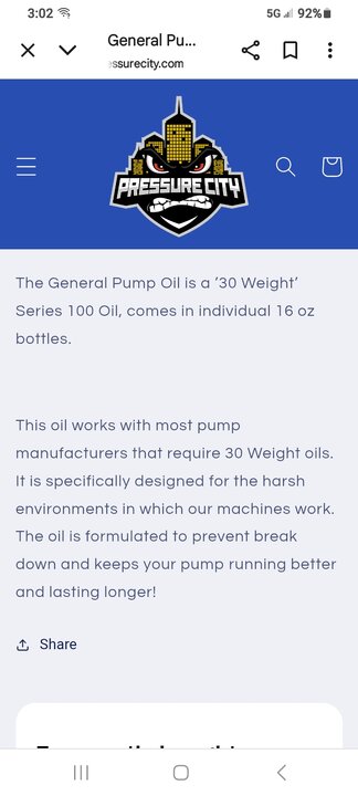

Thats good that the oil still looks new, it should. General pump series 100 oil is 30w ( im almost positive non detergent) so if you were to substitute a automobile or different oil it would be 30w non detergent. Or air compressor oil (also 30w non detergent)

The proper pump oil is expensive stuff. General Pump 100 series oil is $13 for 16oz on scamazon.
So thats 13 bucks a year or so or around 1.08 per month or around 3½ cents per day. thats expensive? What's your machine worth? Is it worth spending an extra 2cents per day to keep it in good shape? Mine is.
